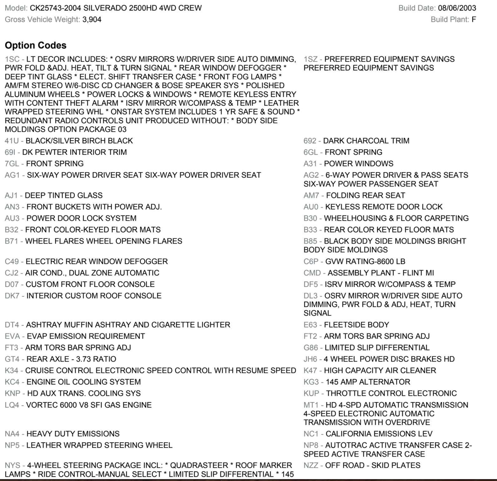

The email is free. Here is some example output:
