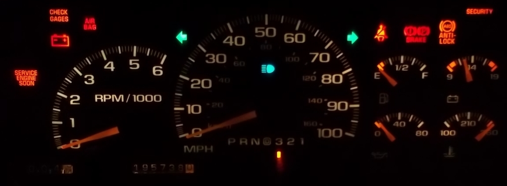

Not sure where you can get another one. But it does work well. Here's the 0mph test on a standard cluster.

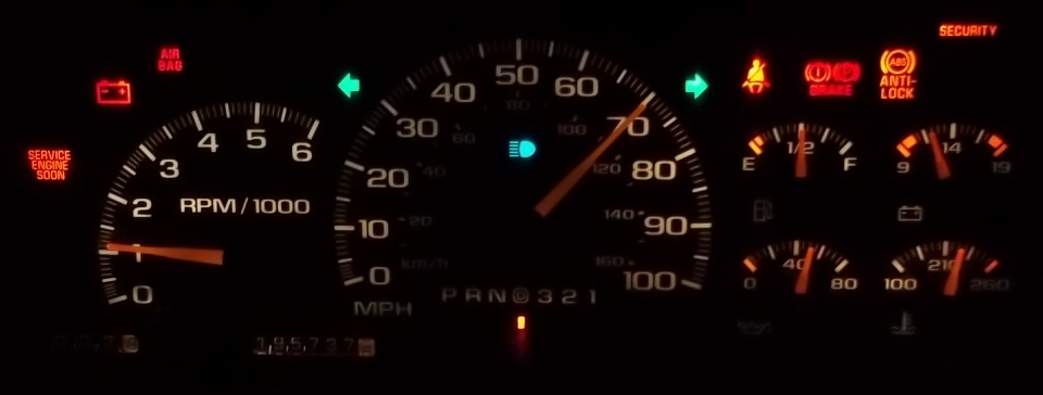

You can see that all the gauges except for the system voltage have 2 known positions so checking calibration is pretty straightforward. I have yet to see a cluster come in that doesn't have any issues whatsoever.
