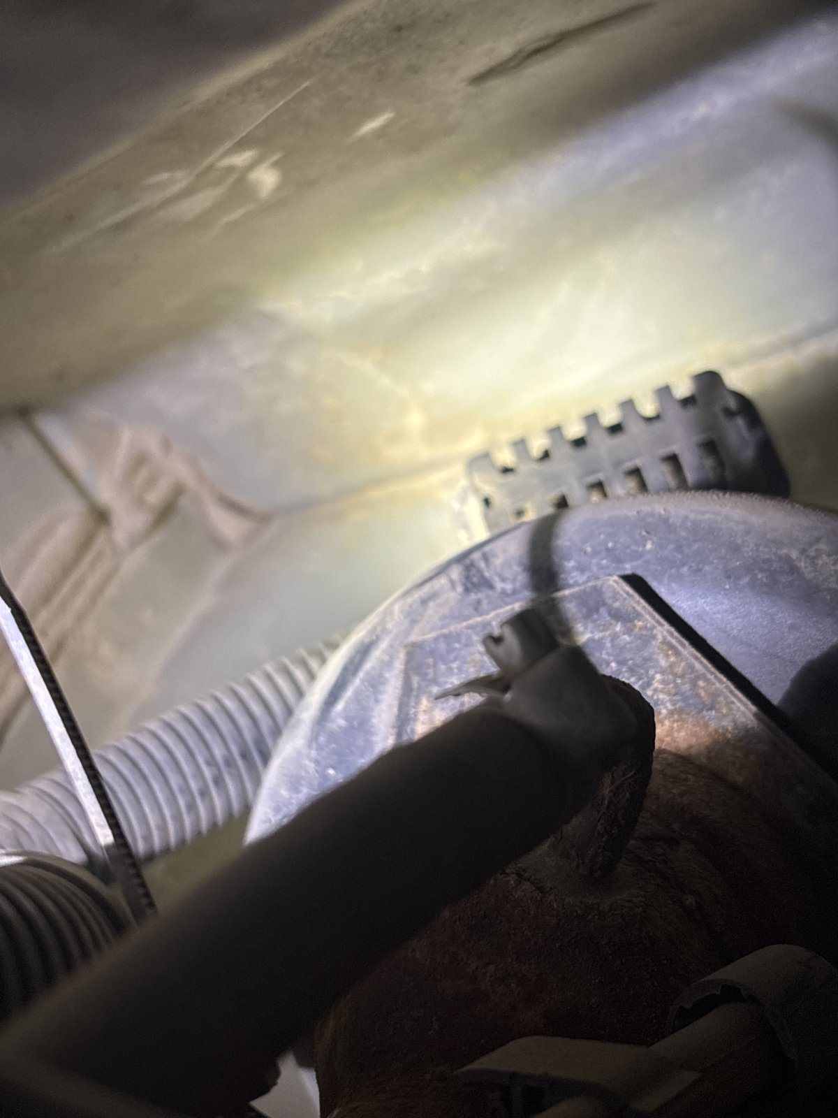

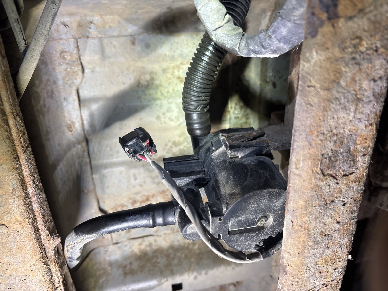

Wondering if anyone knows what the hose going from the vent valve on the back above the spare, to the filler neck at the end of it by the filler neck there is a square deal that feels like a small filter maybe 3 inches wide 3 inches long. And then that hose goes back down to the vent valve. The issue is is there’s no quick connect/disconnect on the vent valve side to disconnect that hose so I’m having trouble getting the vent valve out.
iboughtatahoe23
iboughtatahoe23
Feb 17, 2023
1,035
531
Super Moderator
13,379
27,215
Elev 5,280
That's the remote filter for the vent valve. It's usually full of dirt and blocked when certain evap issues happen.

Based on time and milage there’s four things due on the fuel system.
* Replace charcoal canister. Check!
* Replace Vapor canister purge solenoid valve @ filler neck.
* Replace Vapor canister purge valve on engine block.
* Replace fuel pump / sender with OEM unit.
Then, blow out all the lines when the tank is out and swab’d clean. It’s got to be done systematically to get you back to uninterrupted fill ups.

I replaced the charcoal canister, purge solenoid by the fuel rail, and I’m currently working on cleaning the vent valve right now… you think the fuel pump?
And what’s the vapor canister by the filler neck? Did I miss that.
