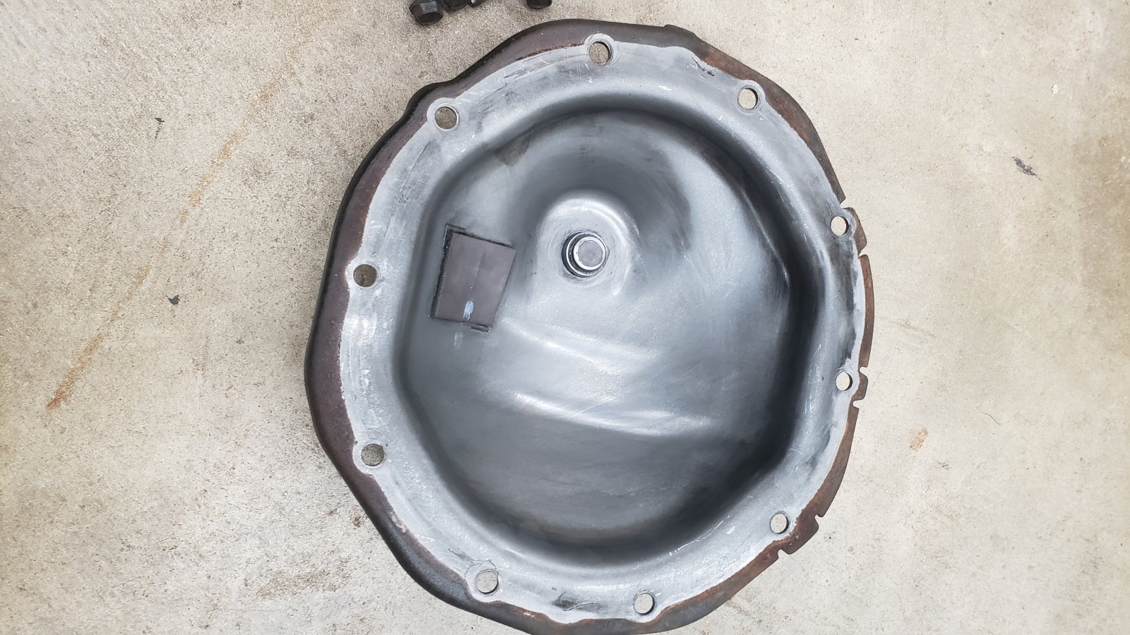

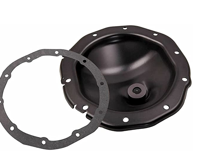

So I got the cover on and put in fluid, however I dont know if I messed up with the magnet it came with. First of all one side was a bit smoother than the other and I dont remember which way I put it, and second of all in the photo on Amazon the magnet is shown put around the fill hole, but I put it down more towards the bottom of the cover not in that spot in the picture.

So I got the cover on and put in fluid, however I dont know if I messed up with the magnet it came with. First of all one side was a bit smoother than the other and I dont remember which way I put it, and second of all in the photo on Amazon the magnet is shown put around the fill hole, but I put it down more towards the bottom of the cover not in that spot in the picture. View attachment 388199
The cover on my 2012 has the magnet below the fill hole. The magnet is square on mine.

That doesn't look like an 8.6 cover, at least not a GM one. Either way, put the magnet down low where the fluid is, if the dimple is not there to hold it in place.

Doesnt really matter where the magnet is as long as it is submerged in gear oil. The gears turning moves the gear oil around and the magnet will attract any metal particles like it should.
