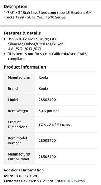

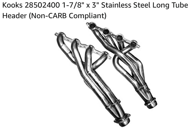

I posted this on a similar thread a while back... really like the upgrade to my 07 LTZ 5.3.
From other post: I have a 2007 Tahoe and went with Kooks headers. I can feel a definite increase in power and really like the sound. Went with long tubes with x-pipe and true dual Magnaflows out the back.
the Kooks are not cheap, but the flanges are thick and the pipes are very strong. Here’s more information about what I installed.
Good luck with your build!
