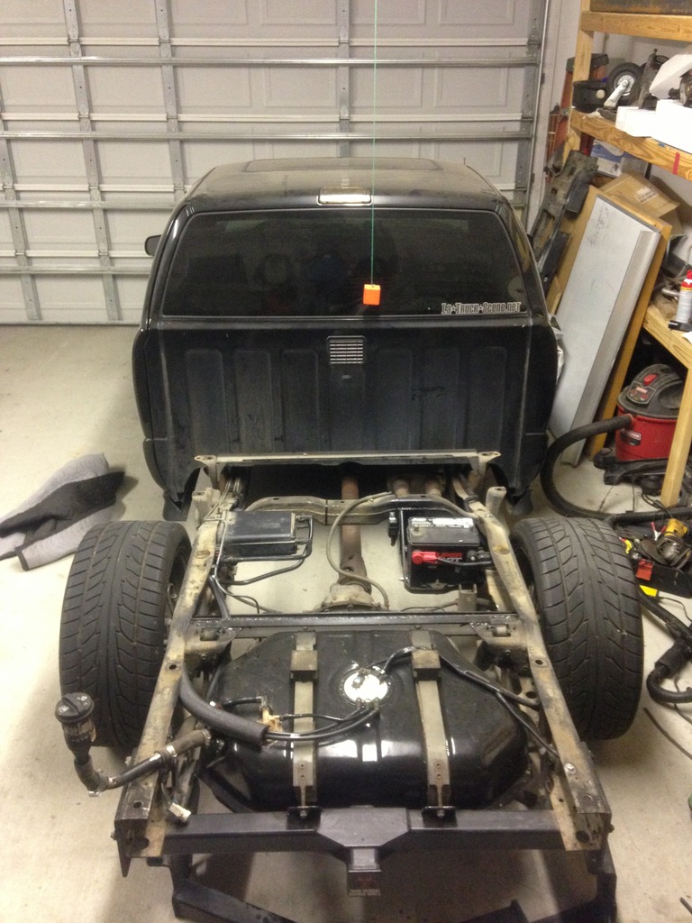

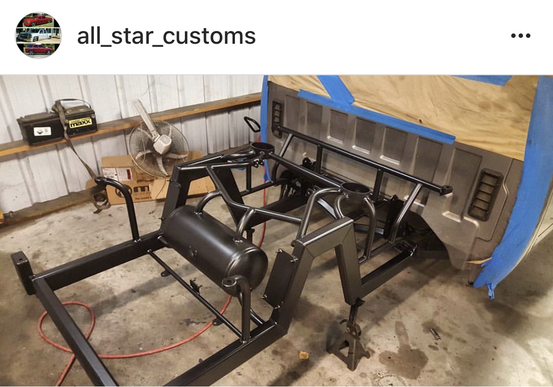

Has anyone replaced the factory fuel tank that is next to the driver side frame rail with a similar sized one in place of where the spare tire is located?
I've been toying with the idea of long traveling the rearend but the factory gas tank is in the way for the to triangulate the upper arm to the frame rails.
Any thoughts and discussion is welcome.

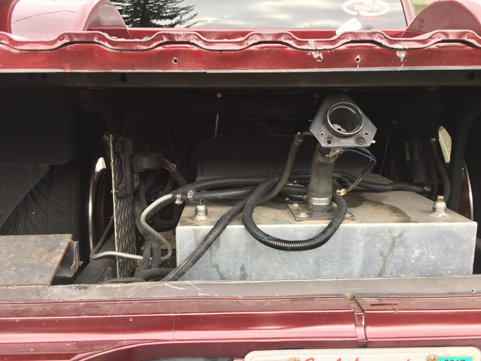

Here's a couple shots of the 15 gallon cell on my bagged CC. It's kind of hard to see it that good with the bed on and the shape of it might not work in your case since I have more room above the frame (my bed is raised) plus the entire frame is custom but it's just an example. My fill is out the back but you could route it to the original location. Mine uses a stock fuel pump which you would need to measure for it's minimum height needed. The tank couldn't be too thin in other words.

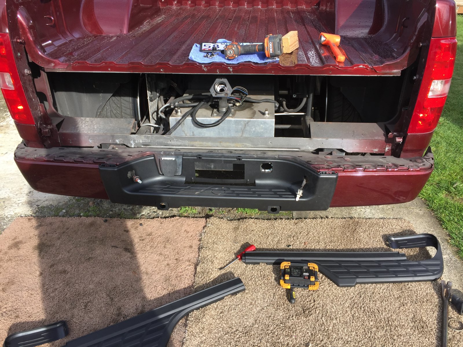

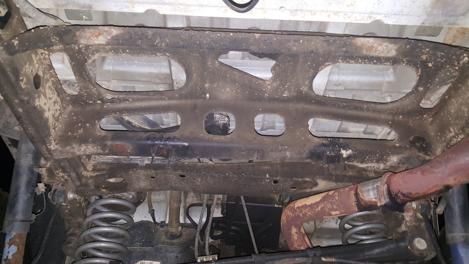

So I was thinking about this some more and said **** it and went and took some measure ments.
So between the frame rails is just over 36".
From the rear bumper to the next cross brace going forward that has body mounts on it that I wouldn't want to spend the time modifying is a little over 30".
And from the lowest point on the body to the bottom of the factory rear bumper cover is 10".
So just using those measurements you have a volume of over 46 gallons.
Excuse my dirty truck but you can see there is quite a bit of room there. You would need to remove the 2 vertical support beams that connect with the plate that goes across the top of the frame. Then you can just add another channel support near the rear bumper.
And the tank could be taller than 10", closer to the middle of the truck since the body raises up a little bit and it can hang lower since you wouldn't have to worry about it getting hit on anything.
