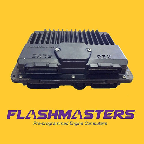

Yeah, the money grubbing owner that replied said this:This is 1st link I clicked.
1998 1999 S-10 Engine computer 09355699 "Programmed to your VIN" ECM PCM ECU | eBay
Related trouble code. This computer is refurbished and tested for functionality. match your vehicle. using the latest software updates using your V.I.N. (Vehicle identification number) to exactly. Two things may have to be done after you install your E.C.M. First an anti-theft.www.ebay.com
