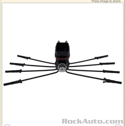

Without pulling the upper intake, they wouldn’t be able to see if it is the regulator leaking externally or if one of the plastic injector lines is leaking. Of the two, I’d suspect the regulator (silver thing in photo below) before the lines. It can be replaced independent of the entire injector assembly. Maybe $30 for the part?
It’s really not a bad job should you want to do it. The only required “special” tool that comes to mind is a 1/4” inch-pound torque wrench. I’m sure there are YouTube videos that would give you an idea of the process.
Old (original) style is shown below. These are typically replaced with an updated style (MPFI).

$740 for the regulator or for the complete injector assembly? Sounds like the whole assembly - retail original style runs around $200 on RockAuto, so figure they’d charge $300-$400 for the part at a shop. Throw in labor, taxes and miscellaneous shop fees and you’re there.
Since you’re pulling the injectors out to get to the regulator, it makes sense to just swap in a whole new injector assembly (which comes with the regulator already installed).
Whether you then reinstall the old injectors or put in a new assembly (be it the old style or MPFI) makes no difference in the installation procedure. The MPFI comes with instructions on which way to position the lines so it’s pretty straightforward.
