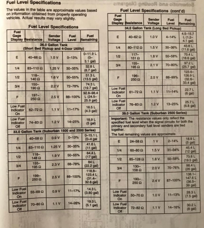

You might be able to check what the fuel level sending unit is telling the gauge with a Volt-Ohm multi-meter to verify nothing wonky is happening in the tank.
Here is a link to what values are.

Similar to what MassHoe04 posted (in the link) the values for everybody's enjoyment (attached fuel level specs).
I have all the factory manuals to follow and refer to but sometimes this forum has experienced shortcuts.

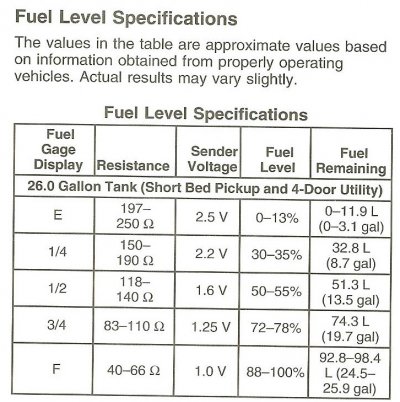

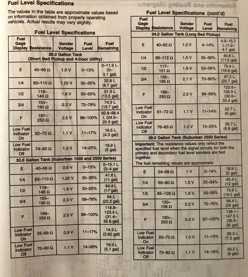

I have a conflict. A chart copied from this forum (first one) shows just the exact opposite volts and ohms readings for the entire range most notably Full and Empty. The second chart is from my OEM shop service manuals for 2004 (Yes, I have all three). Is it possible the first one is from an earlier manual? Can anyone explain the variation?

I see when I posted the charts, they flipped. So the one I stated as first is the dirty looking one (GMC Fuel level#2), whereas mine is the clear white one that says Fuel Level Specs.
Moderator
16,647
34,452
People's Republic of Colorado
Ok, so I'm very curious about this. Seems like less resistance (nearer 0 Ohms) would allow a higher sender voltage on the circuit. However, what I don't know is if the BCM (if that's what controls the gauge) says higher voltage = lower level on the gauge display.

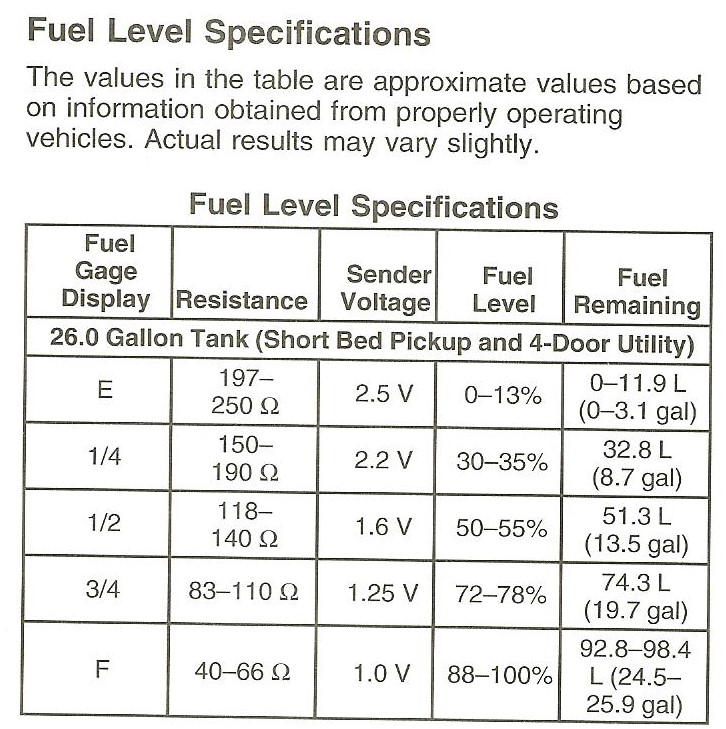

Here is what I have discovered so far. Today 2/18, I checked the signal circuit at connector 152 (under the fuse box, eng comp).
I pinned into the signal circuit (purple) and low reference circuit (black). Using my DMM, read Ohms. I have two meters so checked both on each test to verify. To clarify, The fuel level meter is the gas gauge.
Test #1: Fuel level meter read one line under 1/4 @ 198 Ohms.
I added 6 gallons gas.
Test #2: Fuel level meter read one line above 1/4 @ 170 Ohms,
I added 5.84 gallons.
Test #3: Fuel level meter read one line below 1/2 @ 120 Ohms,
I added 6.05 gallons, apparently topping it off.
Test #4: Fuel level meter read FULL @ 46 Ohms.
I know what some have said about the specifications however my 2004 GM service manual has the chart (attached below) with 40-66 Ohms = 88-100% or basically FULL.
My Fuel Level Meter seems to drop from Full to about 1/2 when using about 6 gallons and from 1/2 to about 1/4 using 6 more gallons the rest is anybody's guess.
So with all that said, not having a signal generator to test the actual stepper motor Fuel Level, I am leaning towards the stepper motor being defective since the ohms read outs better define the actual fuel level.
Can anyone think of any further tests I can do without purchasing a TECH2 scanner? I have an Innova 3130c scanner that does a lot but no signal generator properties.
