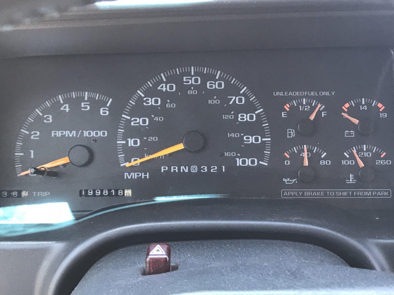

One other troubleshooting note:
The tech pointed out that the gauges still seemed to have power and still registering data from the sensors, ie fuel, oil pressure, temp but not the battery. I don't remember a time when the gauges were all at zero with the key off.
1. Should they all register zero?
2. Any thoughts on where to begin troubleshooting the wiring if they should be zero?
3. Do you think these issues are related?
That's weird. They should be at zero. I suk at electrical, so I couldn't even point you in the right direction, sorry. Hopefully someone more knowledgeable will chime in.
east302
Dec 21, 2016
1,686
1,681
Mississippi
I have two 98s, the only gauges that zero out when off are the voltage, tach and speedometer.
Maybe the relay is sticking? But I would think that if the pump is running with ignition off then your battery would be toast.

on my 99 yukon then we share the same three gauges that zero out so perhaps that is normal. I agree that the batteries would be toast if the pump was continually running, if even a little. I am not sure if a little current would cause the pump to turn slowly or if the pump is either on/off binary style. thanks for the schematic. I will finally have to learn how to read those as part of my trouble shooting. electrical has never been a focus but better late than never.

I'm curious about this simply from an electrical standpoint. I so wish I had a shot of my OBS dash, but I think I remember exactly what you're describing. I remember thinking it was weird that my NBS all zeroed out with key on, engine off. Going by my not so great memory, I'd say your experience is normal.
