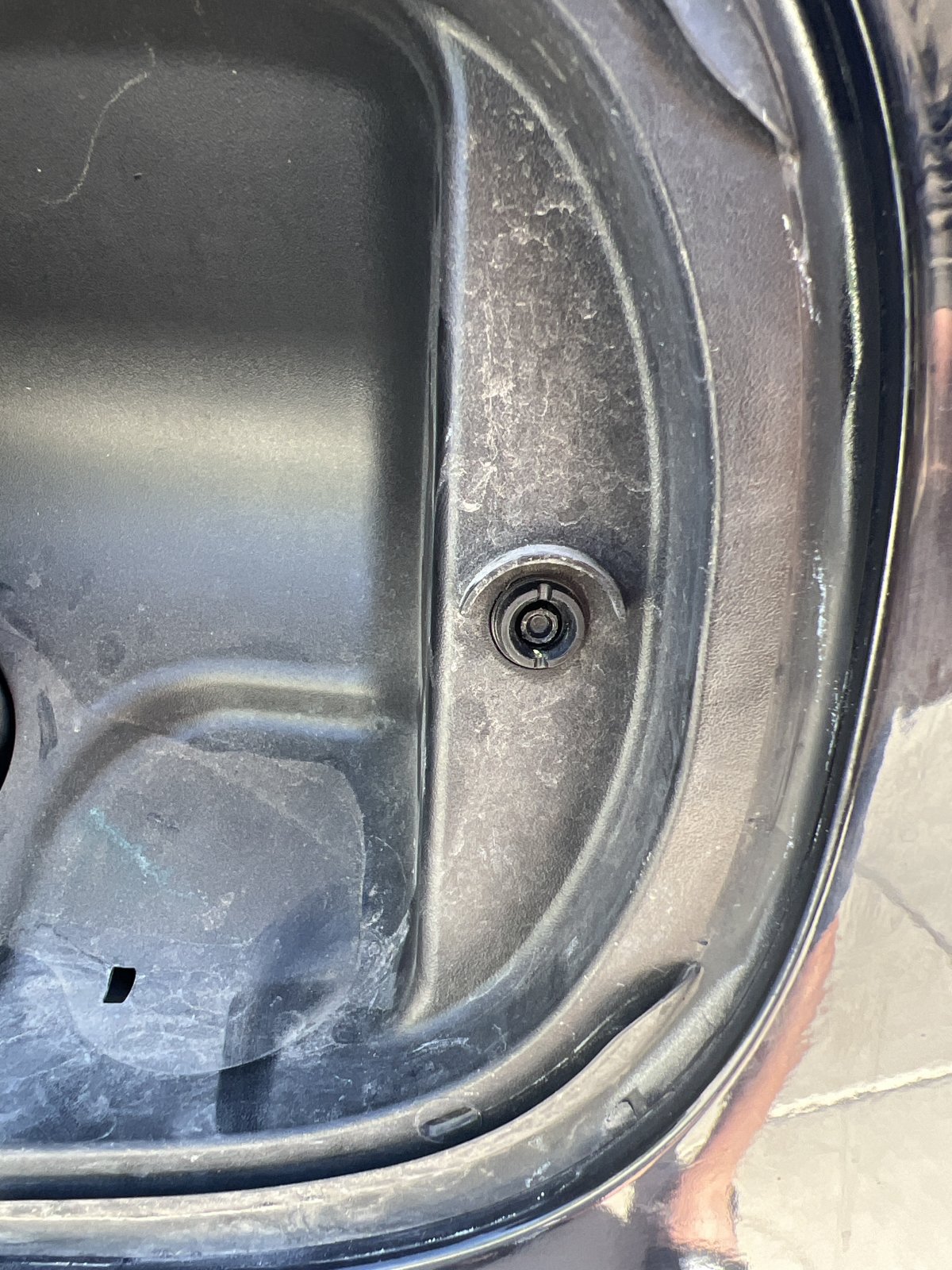

2022 Yukon. Fuel door won’t release. I suspect the plunger fell off. How do I open it? I tried a plastic trim pry tool to no avail.

Tried a different trim tool and finally got it to come out. The rubber boot around the tappet is all torn up. I’m assuming I just need a new tappet?

It’s not. So the lock actuator on the vehicle side doesn’t appear to click in. I pushed all the way in on it with a screwdriver and it springs back. Is that normal? If not, do I have to replace the whole housing?
