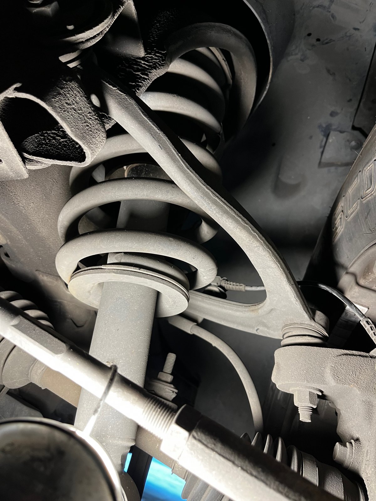

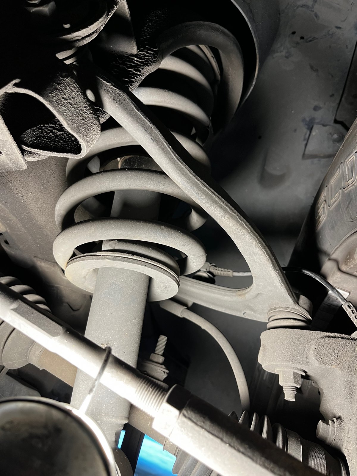

I jacked drivers side up tonight to do further testing. Jacking point was engine cross member near back mounting point for LCA. The only place I get movement is if I pull at 12:00 on tire. Zero movement at 6, 3, 9:00. When pulling at 12, I can reach behind and feel the upper ball joint moving and clicking.
there really isnt any good info on which came with which..ive seen stamped with aluminum spindles, stamps with iron spindles , aluminum uppers with iron spindles, and aluminum with aluminum .... the cast/forged steel ive almost always seen with iron spindles thats about the only constant
I got some pics tonight, forged steel? or are we still not able to tell what I have from these pics?

I got some pics tonight, forged steel? or are we still not able to tell what I have from these pics? View attachment 402290View attachment 402289
+1 to what @OR VietVet said and the upper control arms in your pics are cast iron. I don't see the lower control arms.
Thanks. LCA look the same. Kind of a moot point if I don't replace the UCAs now, but for the future: so I'm assuming the forged steel genuine GM parts are a suitable replacement, since I don't have aluminum knuckles?
