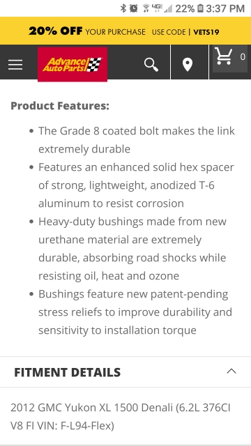

I don't know if that sleeve is subject to compression but that would bother me. Aluminum deforms pretty easily. Jeep was replacing my G Cherokee's rear differential every 10,000 miles because of aluminum carrier the bearings get misaligned. I finally gave up on it just before the warranty ran out.
The OE has a plastic sleeve, even softer than aluminum.
The ones on my mustangs have no sleeves, they have a flattened/bulged spot pressed into the metal rod that keeps the washers from sliding further towards the center of the rod.
I've also seen them where only so much of each end of the rod is threaded and a nut is screwed on up until it reaches the end of the threads and won't go no further, then washer/bushing

To say that aluminum deforms easy is a very broad statement and doesn’t take into account the various grades of aluminum and their associated material properties. I would be willing to bet that your issues with your Grand Cherokee were due to more than the fact that the carrier was made out of aluminum.
I would not be afraid of an aluminum sleeve failing in this application.

I think the Jeep (Chrysler) issue was the use of aluminum. They didn't rebuild mine each time; They completely replaced the entire rear differential, axle and housing assembly in a one shot deal so the exercise didn't pass on an existing issue inherent to my particular vehicle each time.
Having designed structures in aluminum I am aware of different grades, but taffy is not rock candy. The issue with the Jeep is that the bearings eventually got misaligned within 10,000 miles, over and over again. They replaced the failures with the same design. Duh! Glad to have left Chrysler in the rear view mirror.

I was referring to the Mevotech end links I linked above I thought some one thought they were aluminum because they kind of look like they are but they are steel
I think EddieC was referring to the Moogs that have an aluminum spacer sleeve
