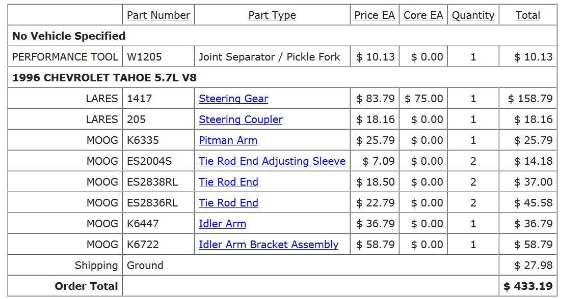

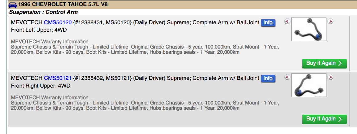

Here's some parts from my 96, mainly steering. Doesn't include lower ball joints or lower control arm bushings, but I would liked to be able to change those too. Too much to do in a limited time and space. I replaced the complete upper control arm. Doesn't include hubs as mine were fine, or shocks. I made the mistake of buying KYB shocks because they were rated for a 1-3 lift, and cheap, but I should replaced the Bilsteins that were on there.
I tried to replace as much of the front end as I could. Didn't want to revisit it any time soon.
