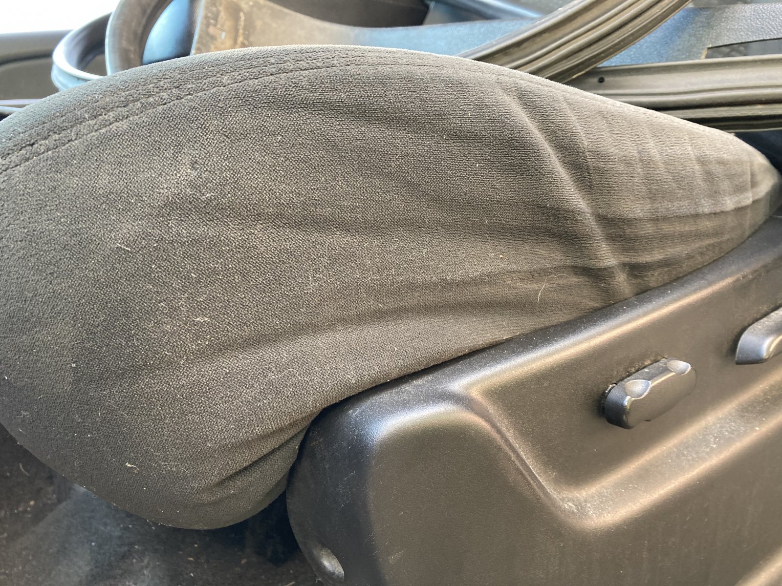

Right here is where I am talking, see how it kind of gets pinched a bit? Still doable though.
89Suburban
Bull in the china shop
Space X Supporting Member
Jan 10, 2013
17,843
50,846
SE PA
It just come off the frame. there are plastic strips on the front, back and 2 sides you have to pull the fabric down on to disengage them. Start with the front and reach under where the fabric stops and try to yank it down to unhook it from the seat frame. Be careful because the seat frame edges are sharp.
