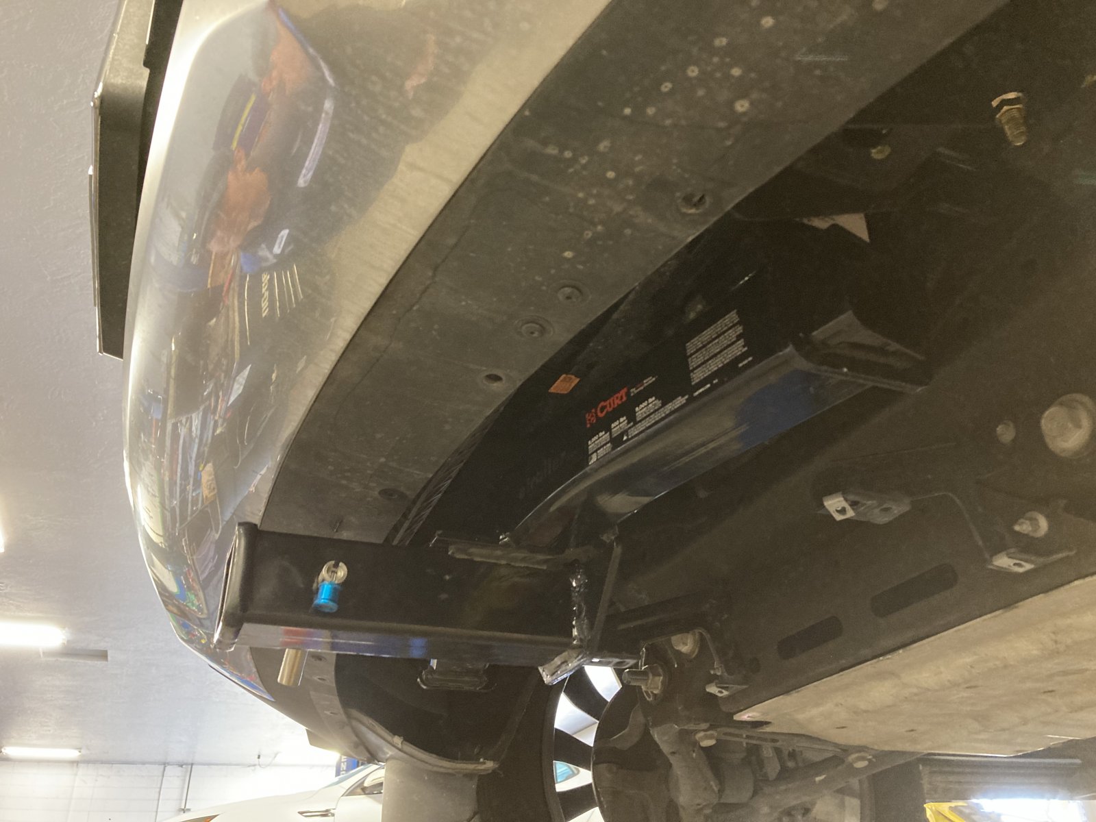

Some good news to report, getting my front hitch! My custom fabrication guy just didn't have time so...
I bought a 2021 Sierra 1500 hitch from etrailer.com - https://www.etrailer.com/new_review.aspx?oid=120641424&ouid=586EB8D1-E31D-4B1C-8A2C-8D89757BA9CA - on the thought that the frame for a 2021 Yukon might be the same as a 2021 Sierra 1500 and found a local auto shop willing to try the install.
It fits good enough! Here's a pic of the drivers side frame / attach. The vertical bolt went in OK but the horizontal bolt (top right of the pic) doesn't line up so well and on the passenger side doesn't line up at all. So they're going to do a ~1" weld instead of drilling/bolting. The passenger side frame has something jutting out that get's in the way of drilling easily.
Didn't have to take off the front fender, just the mud-splash.
Side question - They said that if you take off the front, you may have to re-align the lane departure stuff?
In any case, much easier to just remove mud-guard for access.
The shop let me come down and take these pics and excited to share soonest. Will do a follow up with mud-guard back on etc when I get the rig back.

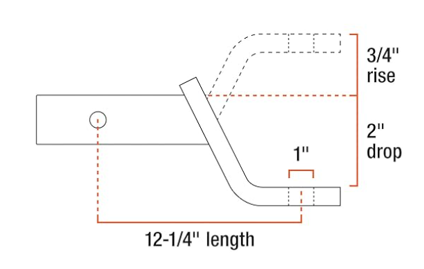

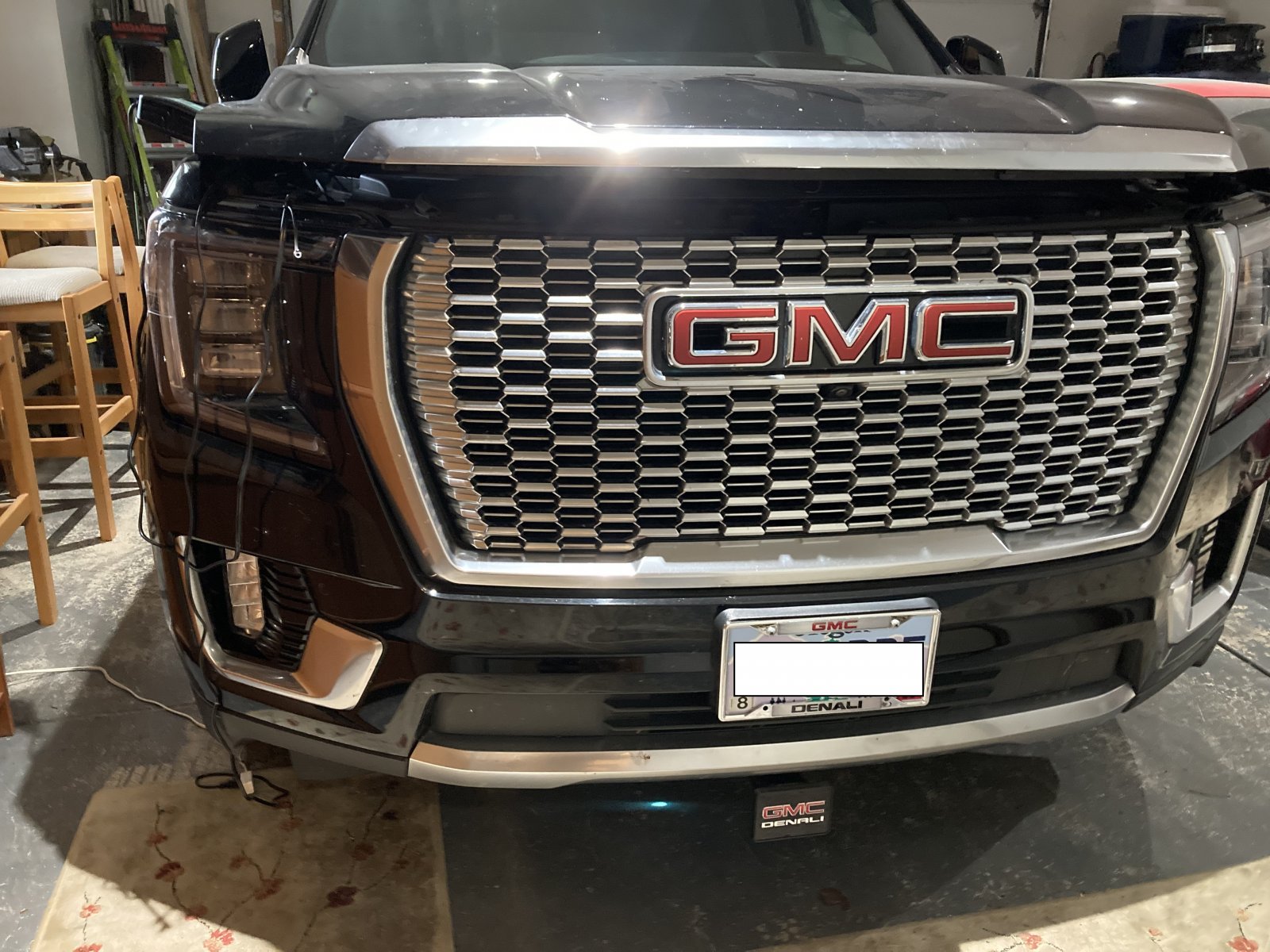

Final pics - the receiver 2" tube/body is ~8" off the ground - same as the metal pan plate under the engine - so no loss of ground clearance.
Ordered a 12" hitch (from pin to center of ball) to get the ball to stick out far enough for clearance around the ball without banging into the bumper chrome piece.
FYI - I use this to push our trailer around a blind curve into a narrow space between home and fence. Front push gives *precise* control + I can see as it's a left curve and makes it a sure thing I won't knock over the fence or gouge the house :)
