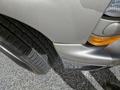

So after swapping the bumper filler from my Suburban I noticed the bumper is not aligned perfectly didn't notice it before no visible damage to the bumper but it appears that one side sticks out further than the other does anybody know is there an adjustment briefly looking at the Suburban it looks like the bumper is fixed without adjustment IMG_20190811_205939.jpg IMG_20190811_205947.jpg IMG_20190811_205823.jpg IMG_20190811_205806.jpg IMG_20190811_205754.jpg

There are arms back there that it mounts to. You could probably push that side back a little. The mounting holes are slotted a little, and they don't offer tons of adjustment, but they do move a little.
