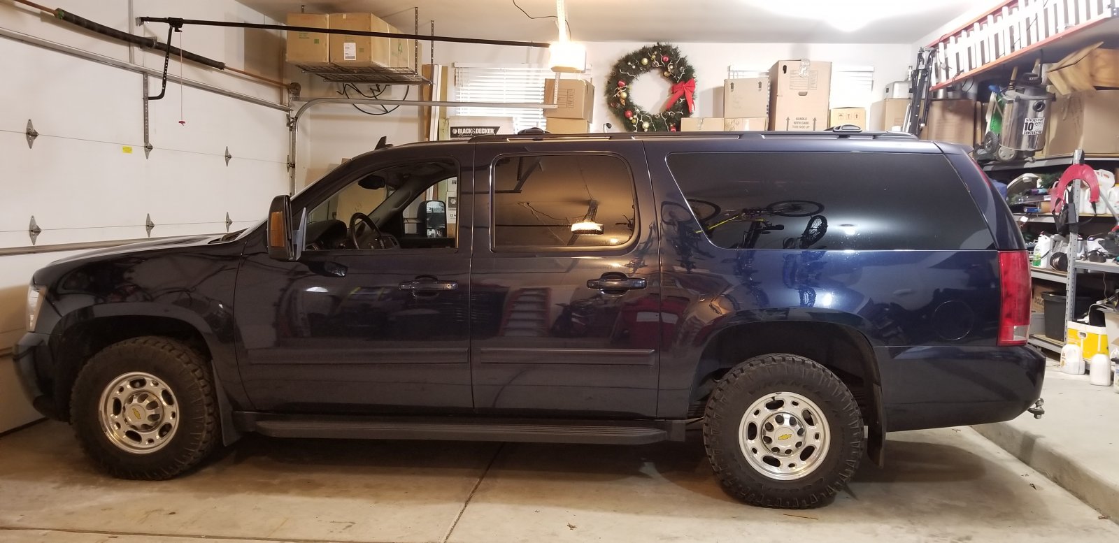

Are my bump stops suppose to be this close? I recently purchased this 2007 Yukon XL 2500. The tire size the last owner has on this Yukon is LT275/65R18 and it does rub the front and back wheel wells when pulling out of the drive way at a turn. I’m just not sure if this is normal or if maybe the tortion bars aren’t adjusted right or maybe my springs are bad? Was hoping for some input. Thank you! Oh yea, my original bump stops were chewed up pretty bad, that’s why I replaced them.

What does the rake look like on it? Any side shots?

That for sure looks too low in front. Obviously some rake stock but that’s far too much.

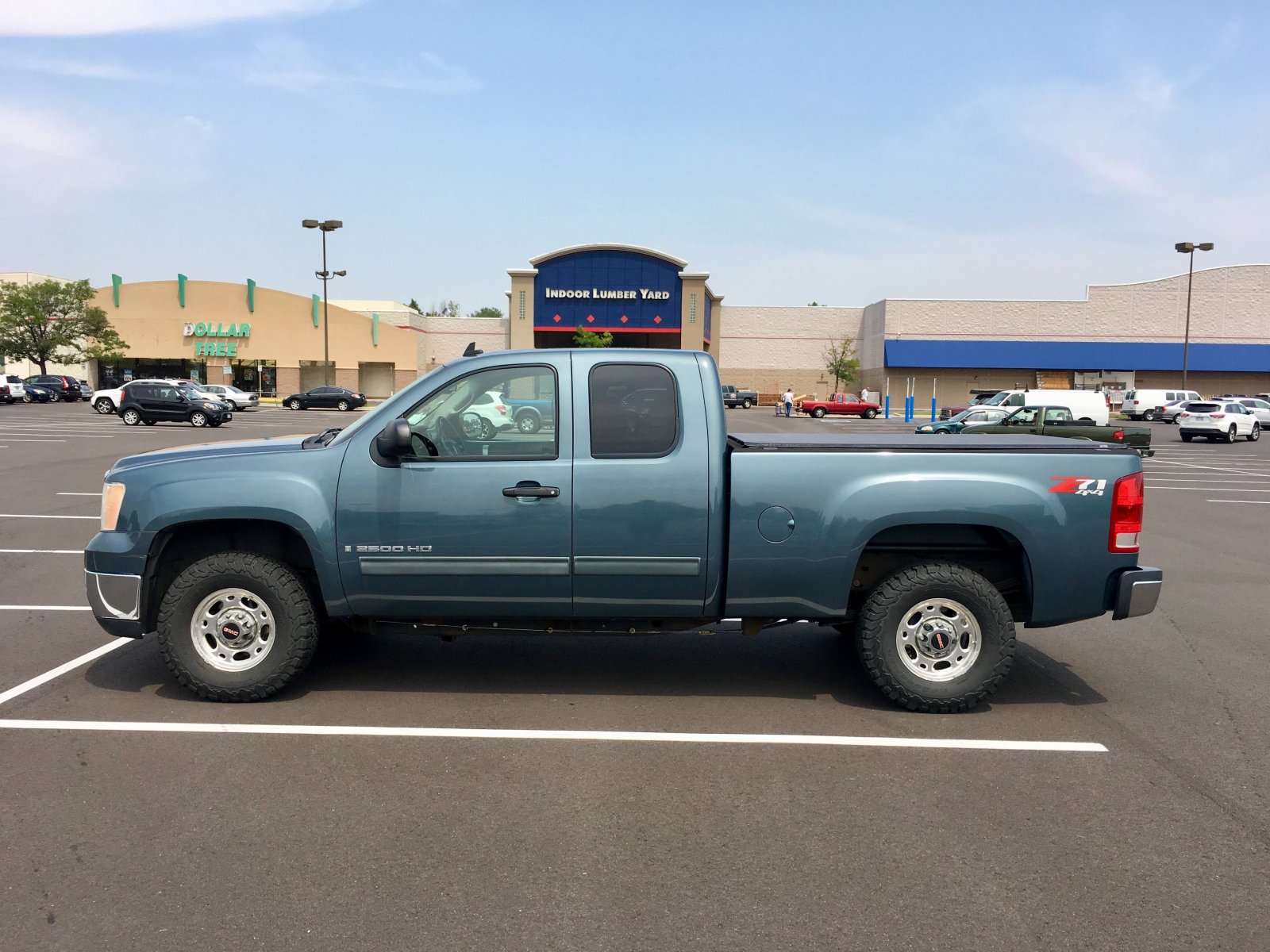

Here’s my Sierra with the jounce bumper just touching the control arm up front and 3” lowering shackles in back

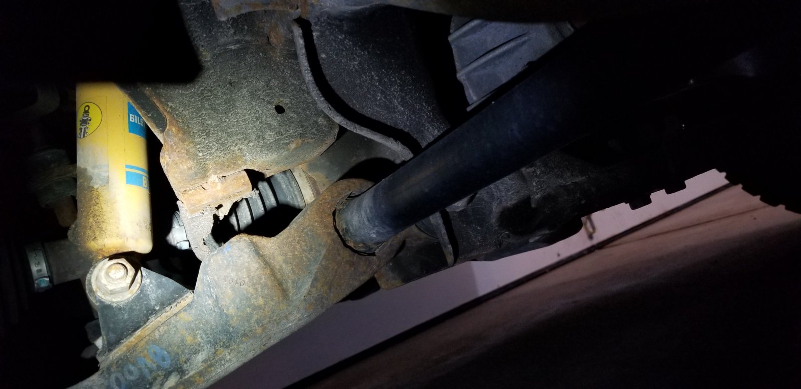

View attachment 221312 View attachment 221311 Are my bump stops suppose to be this close? I recently purchased this 2007 Yukon XL 2500. The tire size the last owner has on this Yukon is LT275/65R18 and it does rub the front and back wheel wells when pulling out of the drive way at a turn. I’m just not sure if this is normal or if maybe the tortion bars aren’t adjusted right or maybe my springs are bad? Was hoping for some input. Thank you! Oh yea, my original bump stops were chewed up pretty bad, that’s why I replaced them.

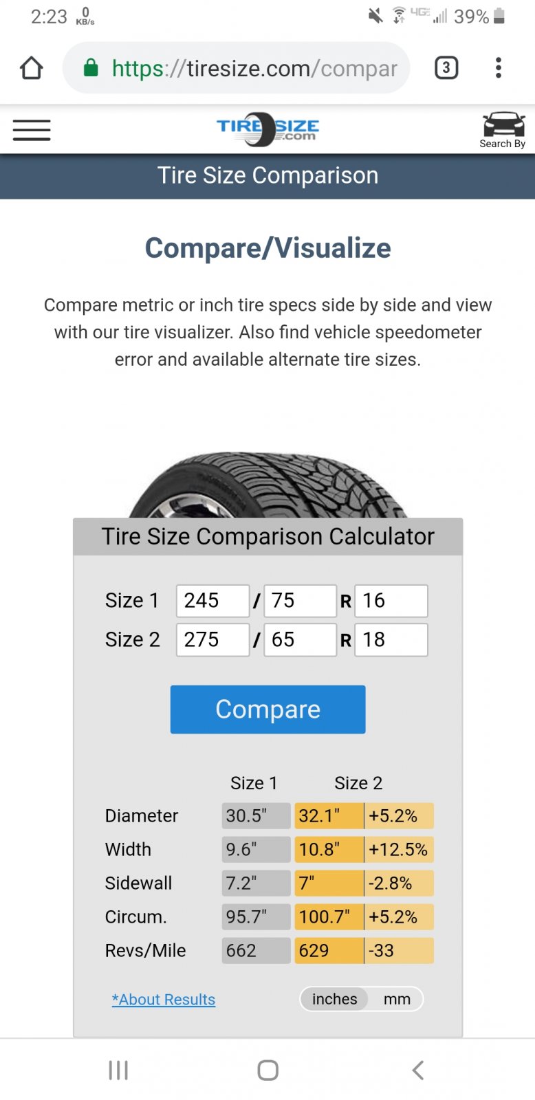

I think the problem is the width of the tires. Mine came stock with 245 tires. Yours are over an inch wider, so I'm not surprised you're rubbing.
You're forgetting that this is a 2500. That's pretty close to a stock stance.
Here's mine, stock tire size and stock suspension .
Actually sitting level, but loaded with 1600 lbs of people and stuff:
I think this illustrates the problem...

A few more pics..

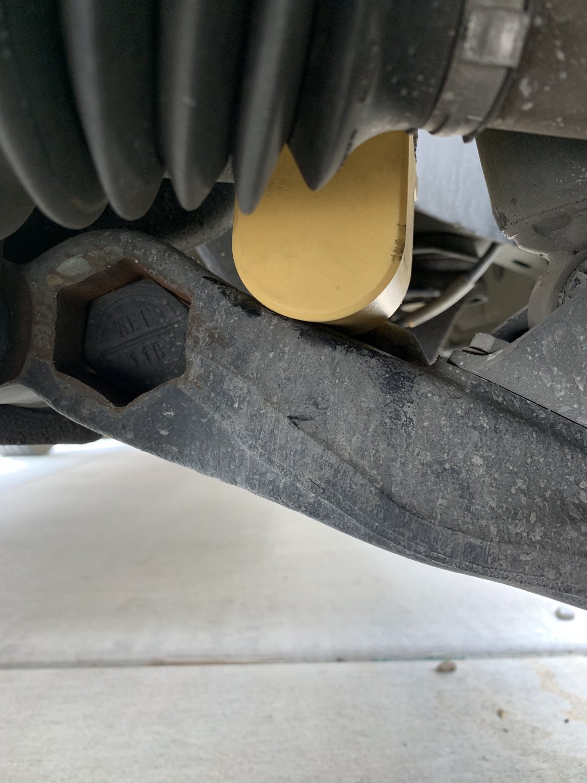

A better pic of the stock stance

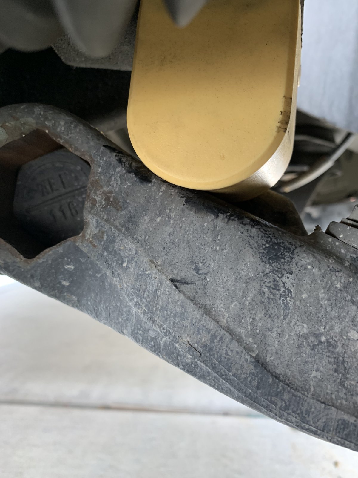

And my shredded bump stop. If I actually had one intact, it'd be similar to the OP's.
