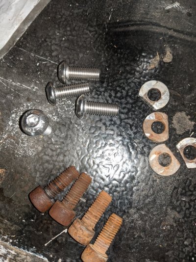

Went to Ace hardware and got some A2-70 Alan head chrome bolts. They are metric.

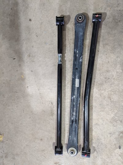

Update: I finally took the stock panhard bar off and chucked it in the trash. In it's place I installed a Spohn panhard bar. It fit like a glove.
I did compare the Spohn unit to the QA1 unit. As you can see in the picture, the QA1 unit is larger in diameter, but the ends are also wider, which was the main reason I couldn't install it. So for anyone wondering.....
