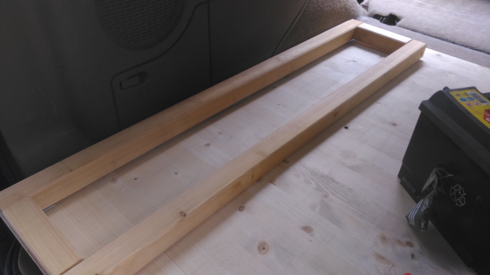

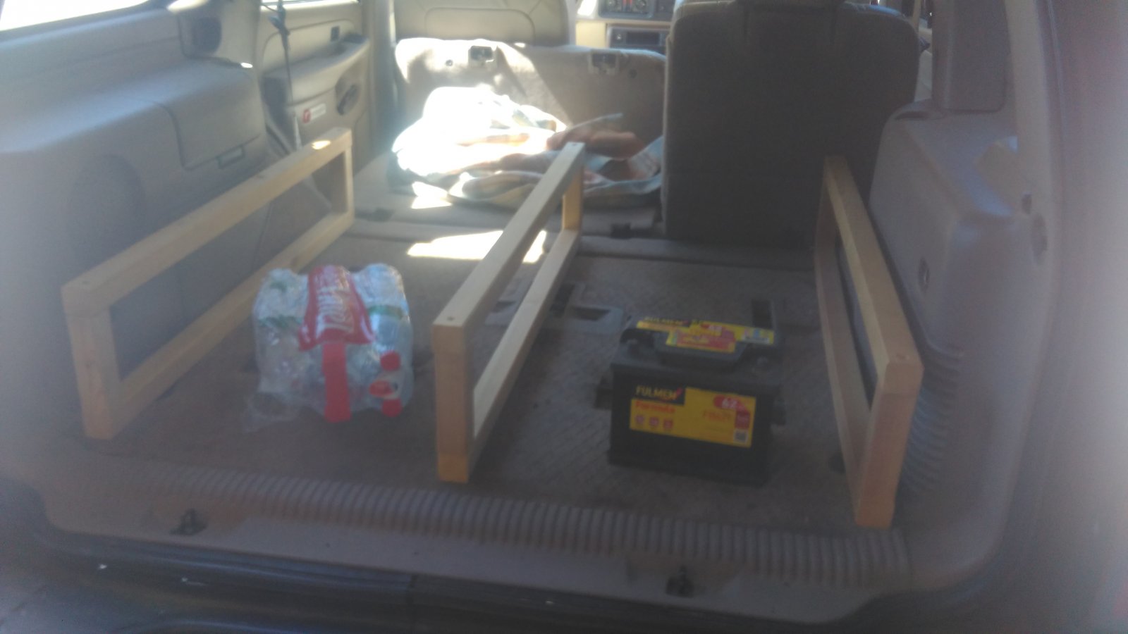

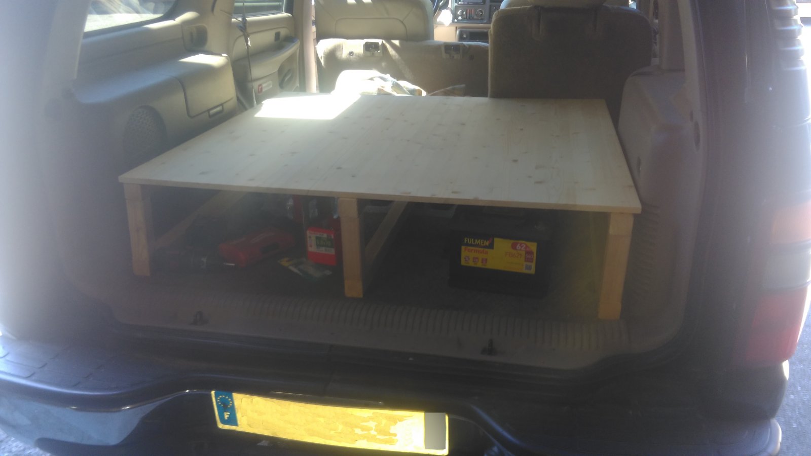

I get my hand on few too-torn-to-be-sold cleat of larch.
They are 45x45 mm (1" 49⁄64) and 4m long (13ft). They are bended but I'll use only short parts so it'll do.
I've done 3 brackets that measures 108cm (42" 33⁄64) long for 25cm (9"27⁄32) high.
For the floor I was wondering what to use. My first thought was to use 3-ply panel that is rigid enough to support our weight.
The damaged panels we have are not enough damaged to be dumped and I don't want to spend €100 for a panel.
For furniture building, we use to sell panel that are 5m long over 1.20m wide (16ftx4ft) in different thicknesses.
Thing is, they all come with a 13mm thick panel under the load to protect them from forlkit operations. We usually cut and dump those panels but i managed with my colleague to keep one as clean as possible.
It's 13mm glulam pine panel so not the rigidest panel but its free. ;)
It will act as a floor for the mattress.
I cut it square to the dimension I needed but when showing the result to my female colleague, I noticed an important gap between the rear door and the panel's end. I'll then cut another piece from the original panel. I'll draw a rounded side to fit as much as possible the inside curve of the door.
That's to be done on monday's lunch break.
Next step is to make 3 more brackets, cut to size the extended floor part, hinge 'em together and with the main floor.
The rest is detail : adding soft material on the panels side not to scratch too much of the Tahoe's plastic panels, put a layer of protection on the floors panels...

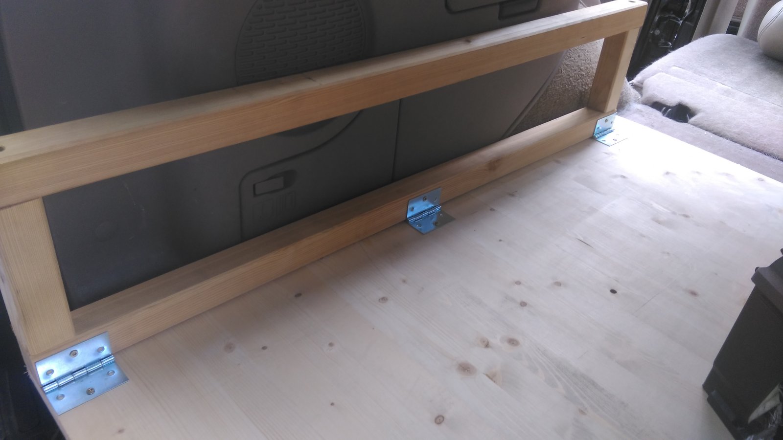

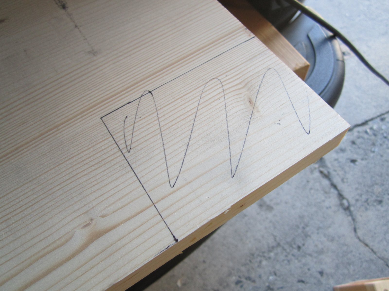

Today I sawed the big pannel to get a side a little bit rounder so it would fit closer to the inside trim of the hatchback door.
I then screwed the hinges. 3 per foot. 1 screw for now. Will add more later.
Feet up.
One Feet down, 2 to go.
I was so sure I would screw everything that I only purchased 6 hinges. The middle feet is so not screwed yet. The hardware store dod not had anymore 70x70mm hinges os I tooh smaller one for the 3 feets from the foldable part.

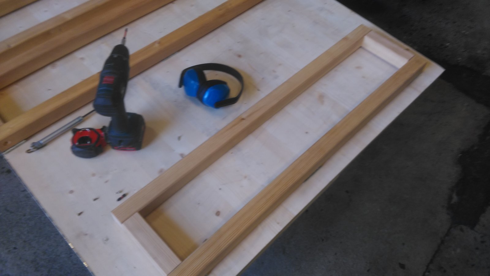

I had time this afternoon to saw and drill all parts for the smaller foot.
Hopfully, tomorrow I will assemble the parts.

Did not work a lot today as I was constantly disturbed by phone calls. I hate cellulars. ^^

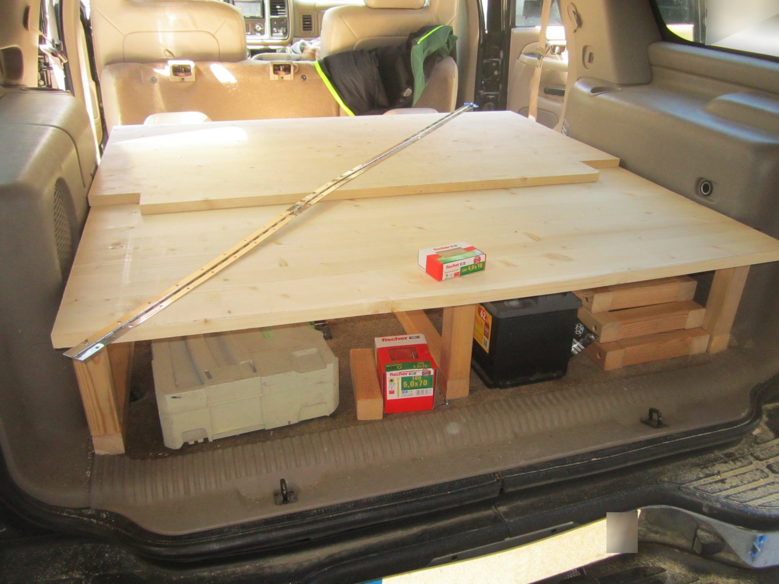

Use smaller hinges to screw the middle feet, I also screw the feet for the foldable part.
I found out that the corner of the foldable grund would scratch hard the roof so I had to make some cuts.
It seems to fit. Will now better friday When I'll fix the piano hinge to both panels.

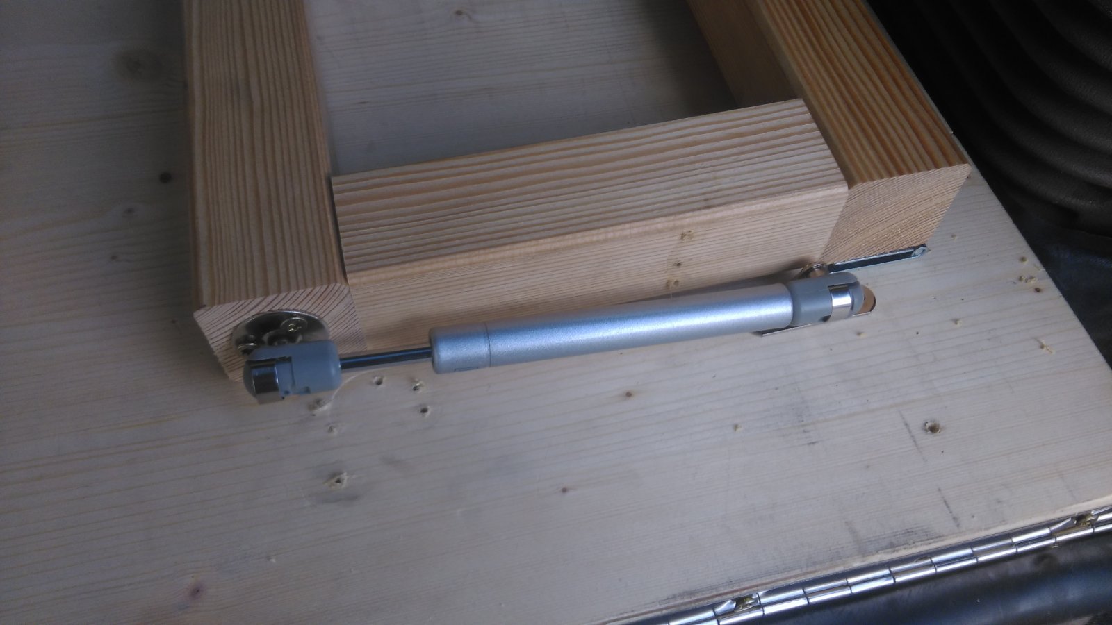

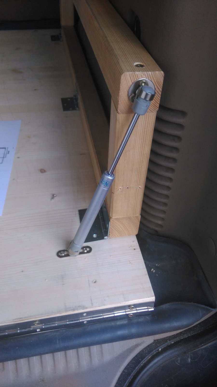

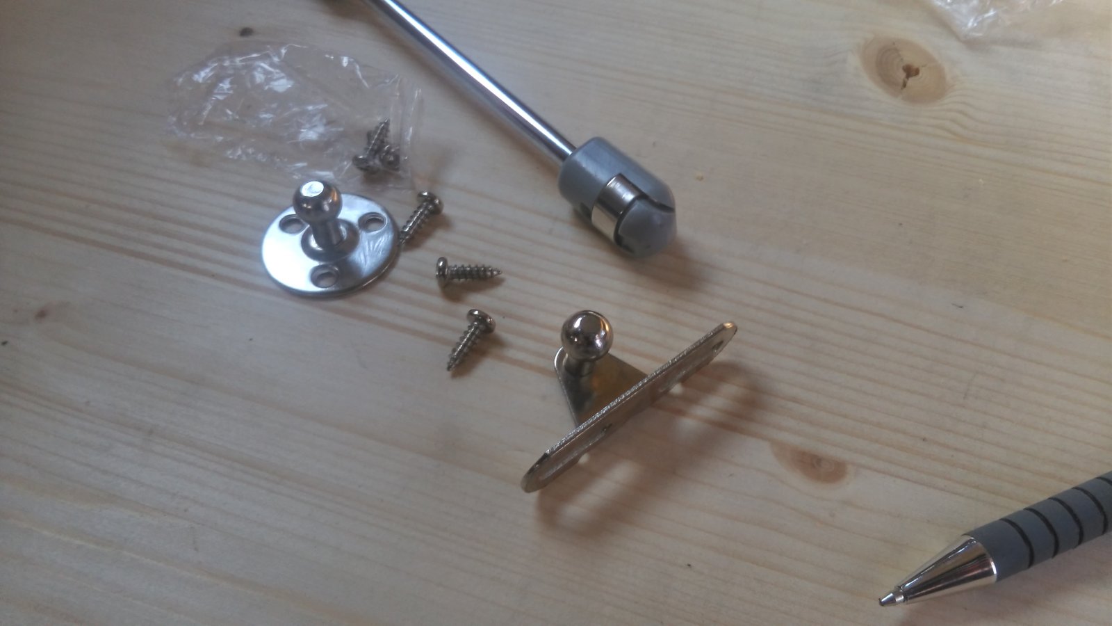

When removing it becasue I needed cargo space, I understant that free floating fett would not be acceptable.
I've ordered from Amazon a set of 4 struts used for kitchen furniture. 120N is a little bit too much but i did not know that back then.
The main legs were going full length to the row2 bench. It was a mistake. I had to shorten them to fit the stuts on this side since I want to have full access to the storage room from the rear.
The 3 main legs are now equipped. Just need to install and equip the last one.
Shortened legs :
UP:
DOWN :
Parts :
