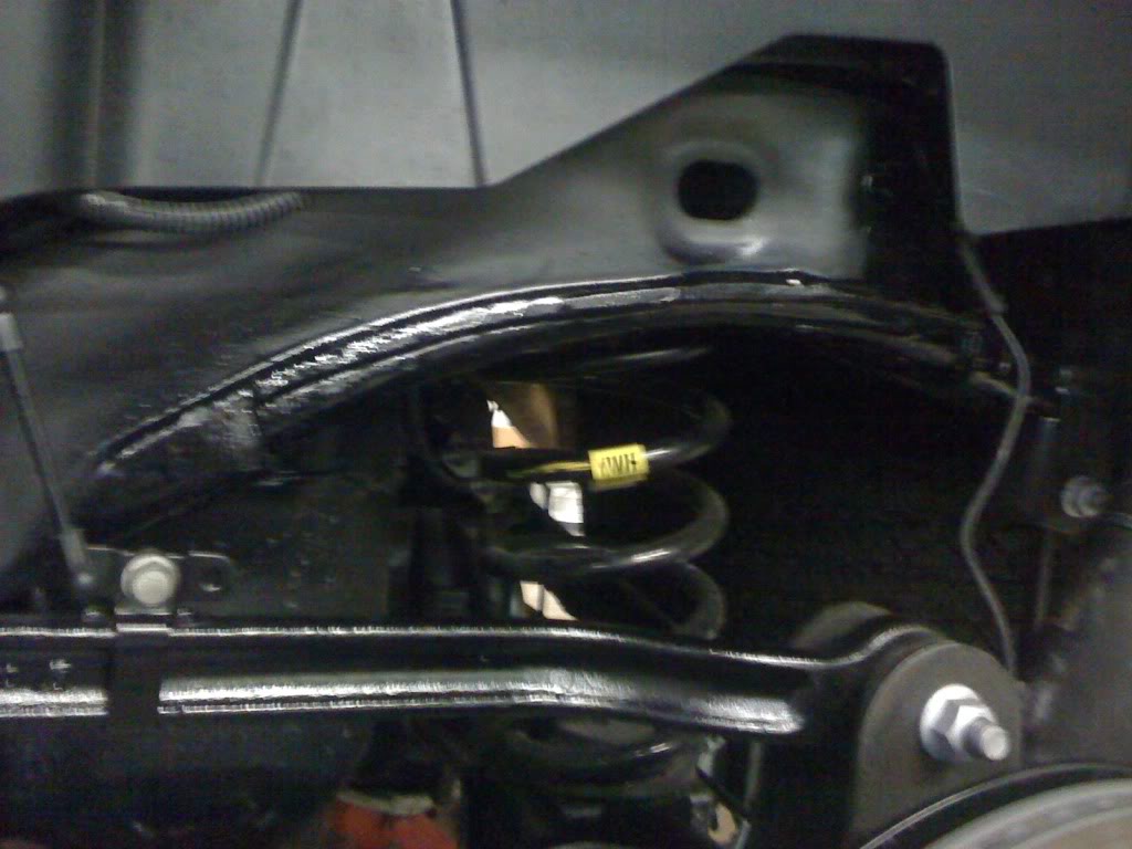

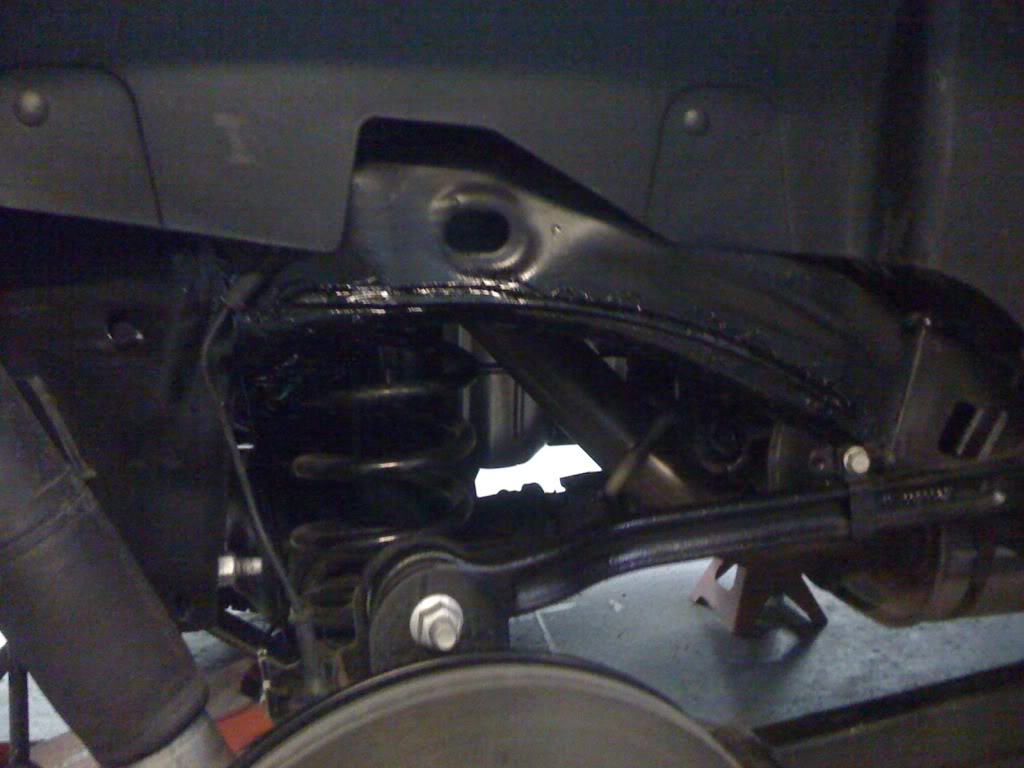

Just did the free travel mod on my 2010 yukon, ive done it a few times already on the older trucks its exactly the same thing on the new ones. It takes some grinding but its well worth it in the end.
Jay
passenger side
driver side
Modded

Basicly all i did was remove the stock bump stop bracket. you can see in the pictures where it was because I cut just below the weld to remove them, if you look at your truck with thim in and at my pictures youll know exactly what to cut off.
