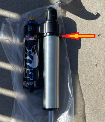

I bought some Fox 2.5 w dsc piggyback reservoirs for my 2009 LS Tahoe and I'm having trouble with getting the left shock on, the fox guide tells me that the left reservoir should face inwards but if I do that it hits my frame, and if I do it out word it hits my tire. It seems to be only the left shock because the right shock fits in fine. The left shock also looks misaligned in the image below. The rear shock part number is 883-26-003 and the one I was sent says 983-26-003 I can't find any info on the Fox website for that 983-26-003. So has anyone had this problem or know anything about this? I bought my shocks off SHOCK SURPLUS so I'm not sure if this is a known issue or if anyone else has had this problem.

yea, so I emailed the company and they told me that "Fox in their infinite wisdom has stopped "preclocking" both reservoirs to the right side for each application, so in this case you would just need to back off the screw that pins them into place just enough to get movement, and then rotate the reservoir into the location it fits" I guess just watch out for this.

@dark_knight2571 I was going to say that it just looks like the orientation of the reservoir is mounted in a bad spot, it should be an easy correct. Let us know how it goes.

I ran into the same issue with mine. Once you back out that ring they are pretty easy to rotate and then screw back into place.
If you run into any issues please let me know, I am happy to help.
I copy and pasted the email Accutune shared with me below.
The reservoirs are designed to be clockable during installation. Fox did this because the shocks fit a couple different applications. The ring with holes in it can be loosened and you can rotate the reservoir to the position needed. I personally used a steel punch on my gmc sierra to rotate them. I tried to mark it in this photo for you to reference:
