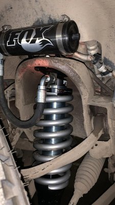

Hi guys,
I’ve bought for my 2012 chevy tahoe front FOX 880-02-585 and rear FOX 883-24-003 and just installed it. front coilovers were in 0"lift position from factory, but car was lifted in front about 3", but I need just 1" What I do wrong?

Did you compare the length of both shocks before you installed them. I was looking at the overall length specs on that shock and it was around 20 inches. My rig has a 4 inch lift and the overall on my King shocks are only 23.6
I believe stock length was around 18 inches. If that is true and your adjusters are backed off all the way it is not going to go that much lower. The springs may set in a little more too.
Is there a plate between the shock and the frame?
How are you measuring the 3 inches gain?

They will settle, go measure again and report back in.
