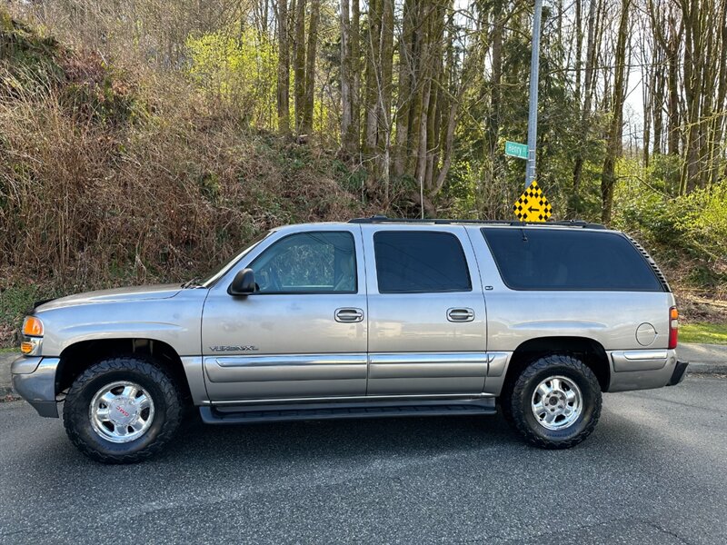

Hey guys, so I'm new here as I am possibly about to be in possession of a 2000 Yukon. I went to see it today and from what I gathered, there are a few things I've noticed about it which I need a second opinion on and need some experts such as the community here. It is a nice car from the outside, very nice looking and looks clean, but after taking a few videos and photos of the reports and what not, I'm getting a bit shaky about investing my time in this vehicle purchase. The asking price is $5995 (CAD)
1) It was a nice drive, I couldn't fault how it drove whatsoever, it was responsive, brakes were good. All in all drive ability, A+
2) In one of the videos below, before I started driving the vehicle and we switched the engine on, I noticed there was a slight leak under the car.
(Change to 1080p to see it)
3) The rust, now I am not aware of how bad rust is on Yukons for this age and where rust should and shouldn't be, but here's another video!
(Plus a bit more of the drip we mentiond)
4) The Inspection Report. So here in BC it does require safety inspections, but judging by this safety inspection report, it didn't pass certain things that I should be worried about(?). Do not know if thats because the standards for passing inspections is so high here in BC, so older cars with rust do not fit that quota.
5) The guy was hesitant for me to take it to get a pre purchase inspection but would not of minded for someone to come and look it, like a mobile PPI.
6) Carfax indicates regular maintenance, but it was in a collision in 2003 of which the front left side was worked on. But that was 20 years ago and has not had any indication of further problem. Here's the Carfax.
I'm sorry about all this information, this is just my first vehicle and I want something reliable that's going to last me commuting to work and going on weekend trips camping here and there. I'm waiting for my other videos to process, once they are processed I'll link them.
Thank you, any feedback is appreciated.

I did not see the leaking underneath. If it was on the right side in the back, that is the rear AC dripping which is normal. Lots of surface rust for a 23 year old Canadian car. Can you see rust holes in the frame or body or bumpers?
Understand that a 23 year old car is going to need regular repairs as things give up the ghost. It looks to be well cared for and in excellent condition however. Price seems right too. Bump this post in the morning when the fellas are having their coffee and you'll get more responses and opinions.

i dont know if i didn't understand it or not but i dont see anything on that inspection report that says it failed anything. belts and tune up are common for any shop to try to toss onto a bill regardless if it needs it or not. if np is not pass it says np for a few things that should say n/a as it doesn't have a comvertible roof. actually most of everything on it should be n/a or just brought into question as there's no legitimate way to check some of that stuff. diaphragm.... what diaphragm didn't pass, there few of those in vehicles anymore and unless it didn't work at all most of them are designed to not be taken apart. if its not a total rust heap has maintenance records and your comfortable with the price go for it.

From what little I saw in videos, the frame looked pretty good. I could not see if there were any holes in the sides of the frame, but the bottom actually looked pretty clean.
The inspection report made my head spin. I haven't finished my first cup of coffee yet and I couldn't make any sense of what they passed or didn't pass.
Have your guy look it over, but from the sounds of things and how it looks... Worth going the next step of having your guy check it closer.
Two years ago my 04 Z71 was $6,500 US. The COVID/supply chain issues made the market crazy! But what could I do? I needed transportation to work that same week my Jeep died. I couldn't afford $30k for new or even $10k for used. In New England, everything under $5k is literally ready for the junk yard. It is what it is... Mine has a ton of rust needing repair on the rocker panels, but I love it anyway! It had 185k miles when I got it and I am over 212k now. Overall, very reliable as my daily driver.
This comment bothers me. Seems he has something to hide and figures the Mobile Mechanic will not catch it.
I am not a trusting person and always feel [especially] someone selling a vehicle is trying to get over on the buyer.
For that reason I vote not to get it.
If you can convince the owner to take it to your mechanic and he gives the green light then that is a different story.
BTW in all my years of buying used vehicles [from dealer or private owner] never had a issue with any of them taking the vehicle to my independent mechanic.
