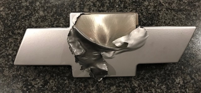

3. I pulled the bowtie up front as it needs a refresh. It was silver Plasti Dip from way too long ago and dull. I was thinking of going with silver/aluminum paint and gloss clear to pick up the wheels.
or
Do I go with chrome or billet to match the polished grille?
or
Do I color match it, although it may just get lost if it is CM?
or
or

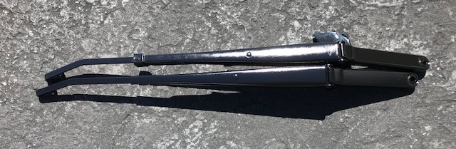

1. Painted the wiper arms and reinstalled. Bought a lightweight puller from PepBoys for about $8. Not super heavy duty, but grips the bottom of the wiper nicely and the the center cap is hollow so it fits over the wiper spline perfectly. And those wipers were on those splines tight. I cleaned the threads up and put some Tef Gel on so they won't seize up.

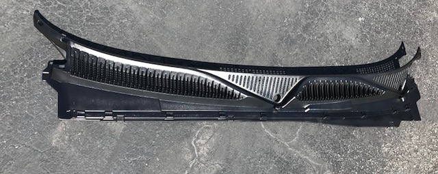

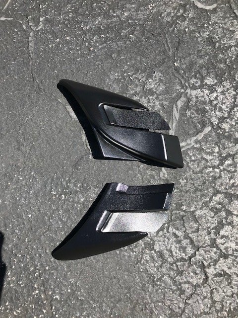

2. Painted the cowling and Esky end caps and reinstalled.

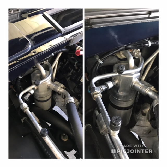

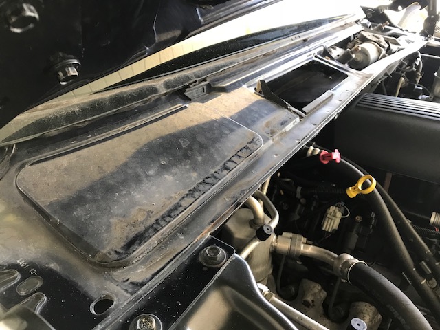

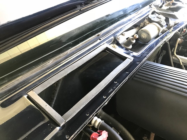

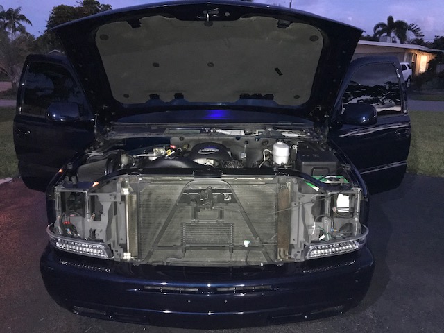

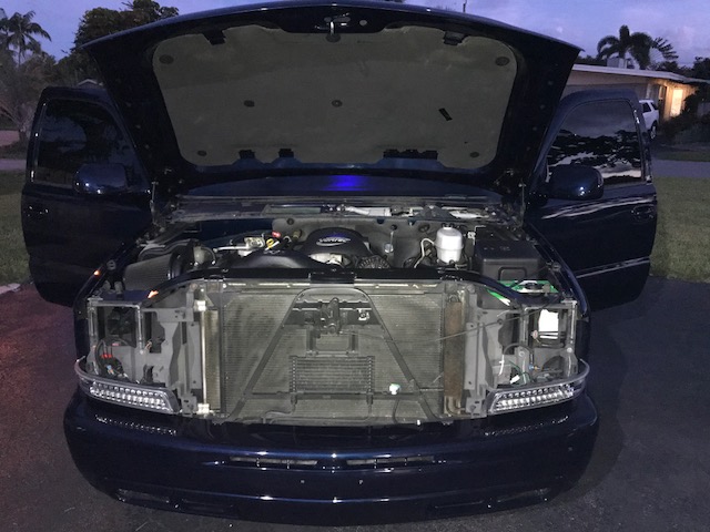

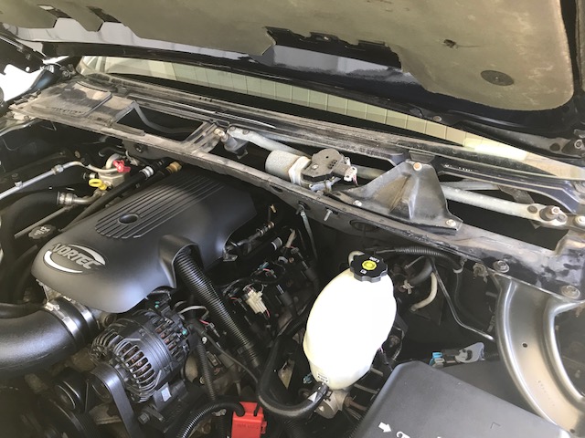

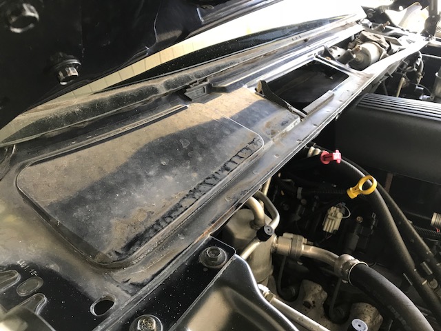

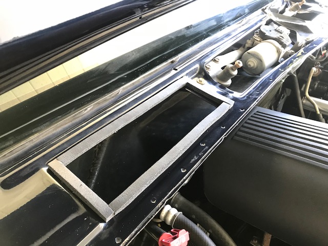

Here's what it looked like under the cowling. So I gave it a wipe down and quick polish of the paint, even though it is covered. I also replaced the dry rotted gasket material that sits under the cowling in the center.

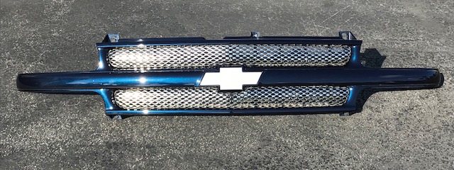

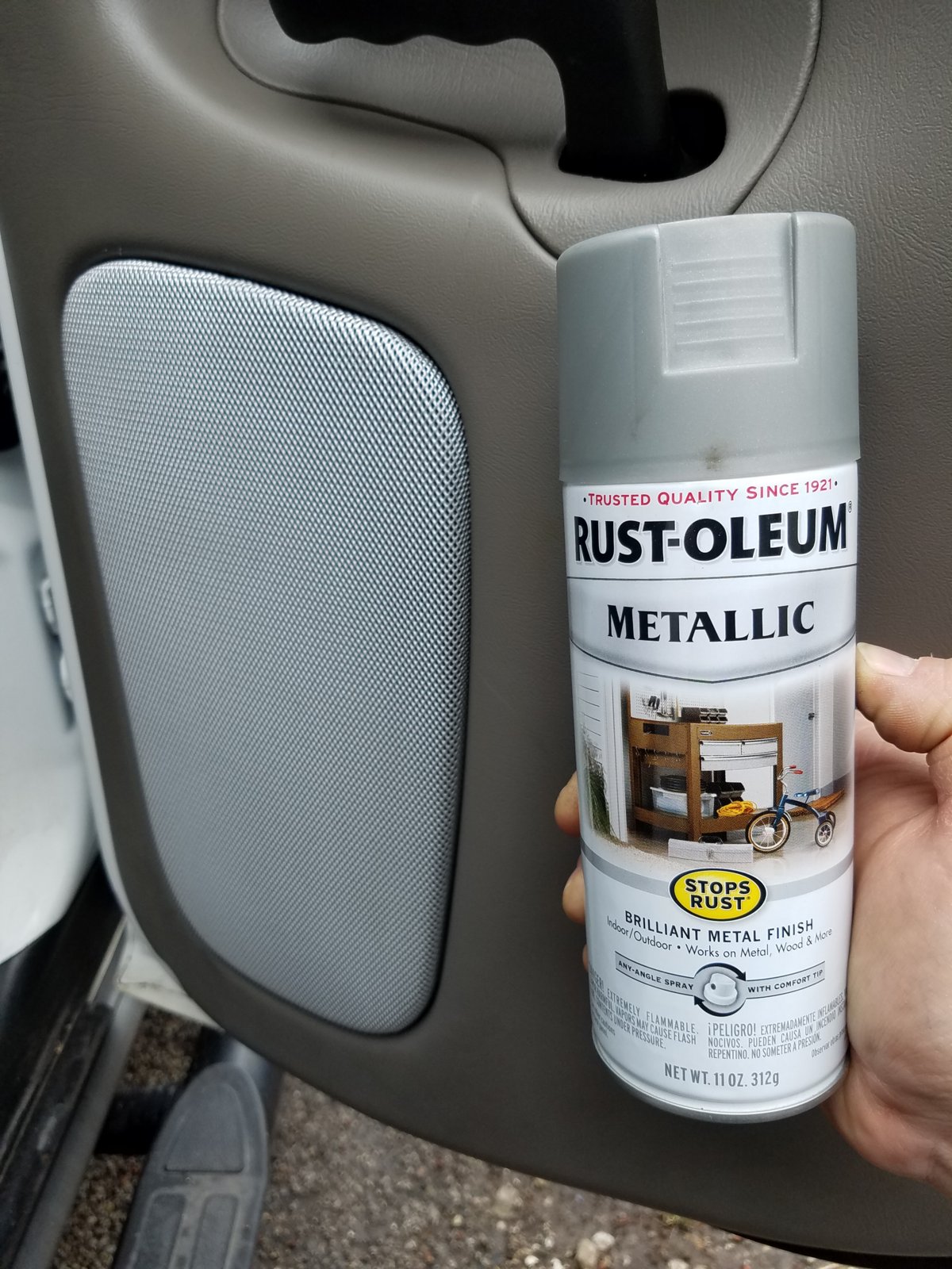

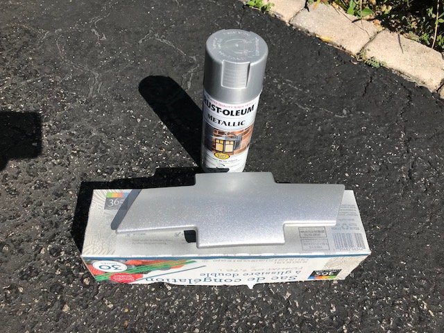

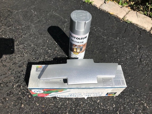

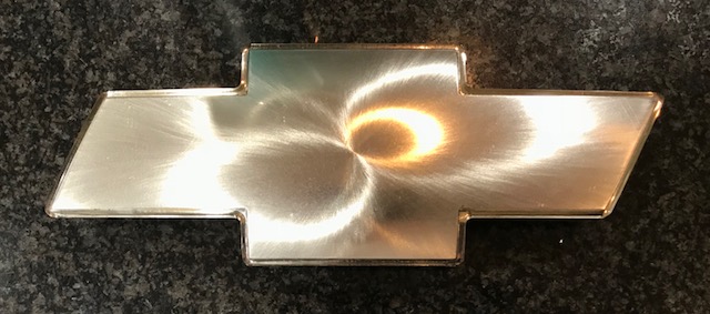

3. Painted the grill bow tie in Rust Oleum Metallic Silver. Good match to the wheels with a little extra. Touched up a few chips and polished a few spots on the grille and while it was off. Hard to see the metallic in the pictures.
I knew that paint would be good for it. Looks awesome on my speaker grilles. Nice job. You're nuts with under the cowl and polishing the a/c! That's why yours is the best, I suppose.
Thx for the paint tip. That was the color I wanted and I think the metallic will pop on the grille up front in the sun.
I figured the cowl was off, so why not clean it? And the a/c polishing...I was just messing around and it started to look better so I did some more. :) Looks pretty good and for free.

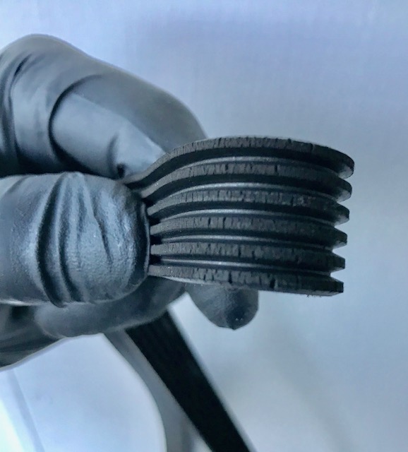

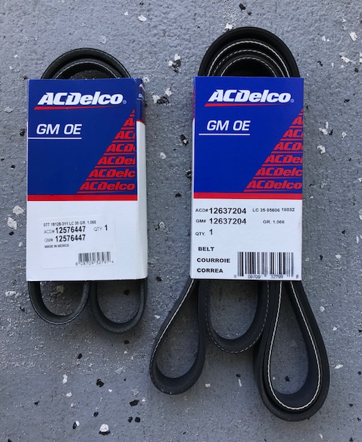

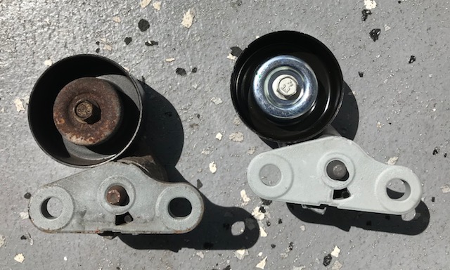

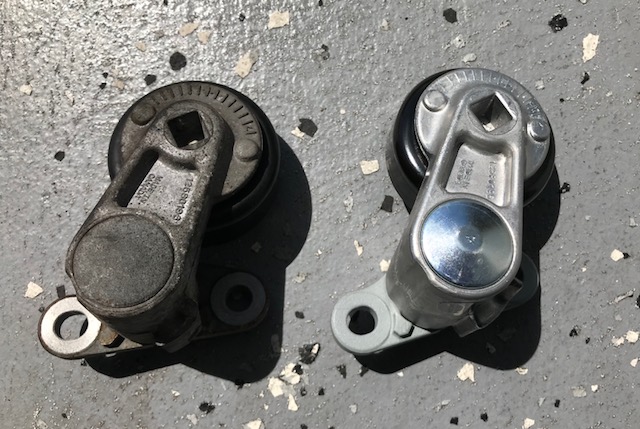

I replaced the A/C tensioner, A/C belt and the serpentine belt with all AC Delco OEM parts. The tick that I had seems to be gone.
Getting that tensioner out was a bit of a challenge, but I managed not to bust a knuckle. The bolts were pretty tight and the cooler line runs right next to one bolt and the tensioner. I pulled the splash cover and crawled underneath. A bit tight, but much easier to access the A/C tensioner and belt from that position IMO. Had to be careful not to bend those 2 lines running up front too far.
Here is the list of parts. Thx to @HiHoeSilver for that info.
A/C Belt - ACDelco 12576447
A/C Tensioner - ACDelco 12580196
Serpentine Belt - ACDelco 12637204
The belts had some small cracks, so changing out both belts while I was in there was worth the preventative $$.

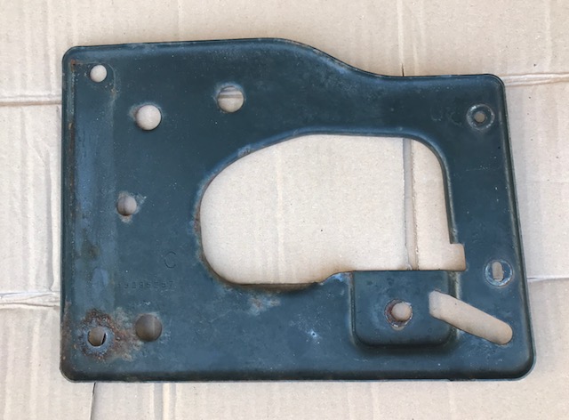

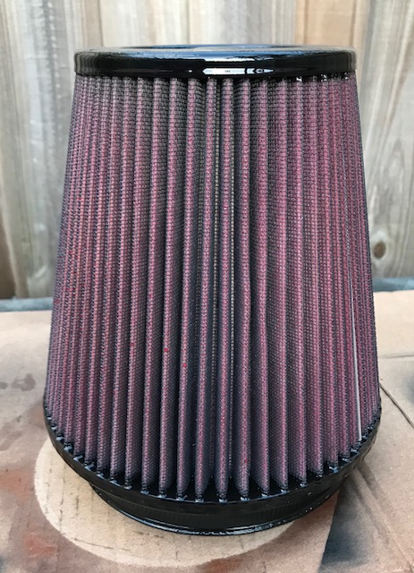

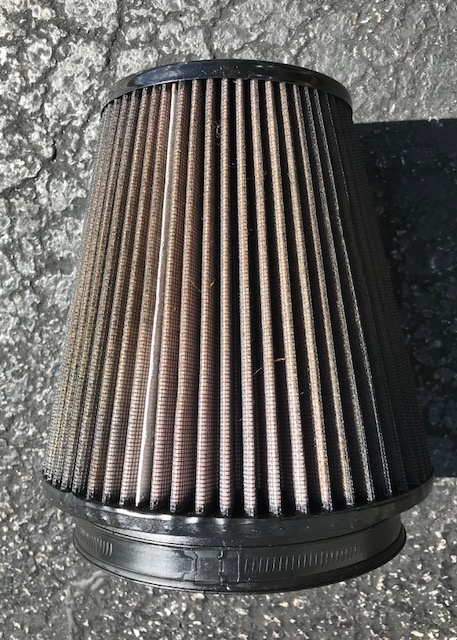

I cleaned and recharged the K&N filter. I hit it twice with the cleaner just to make sure it was really clean. The end cap was chrome, but kept getting little rust spots from the water sitting at the bottom of the end cap ring. I had painted it black once, so I hit it with another fresh coat of black before reinstalling it.

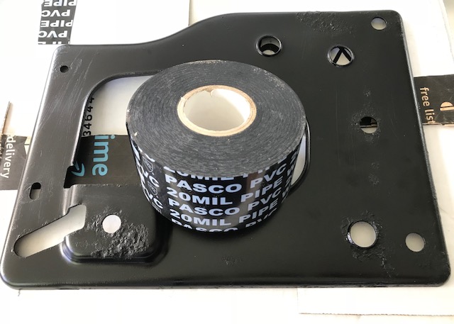

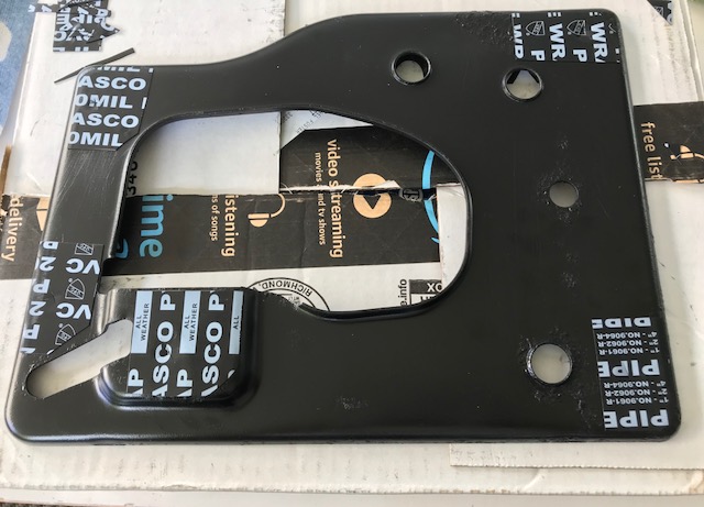

While the filter was out, I removed the battery tray, gave it a quick scratch and paint. I had done this a few years ago. I also lined the bottom of the tray where it screws in with the Pasco 20mil Pipe Wrap tape.
@randeez Can't go back in as bad or worse than it was when I found it. Just can't leave it alone.
I’ve used this stuff on the truck when I reattached the hood and the hinges where metal was on metal. It is a great isolator for dissimilar metals and helps prevent corrosion. This is not the actual application for the tape, but it works.
There was already pitting on the battery tray, so no fixing that, but might as well not contribute to the issue further.
Here are the details for the Pasco tape. https://www.pascospecialty.com/catalog/PASCO_CATALOG_E.pdf
