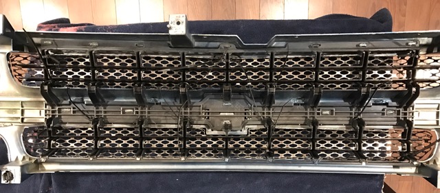

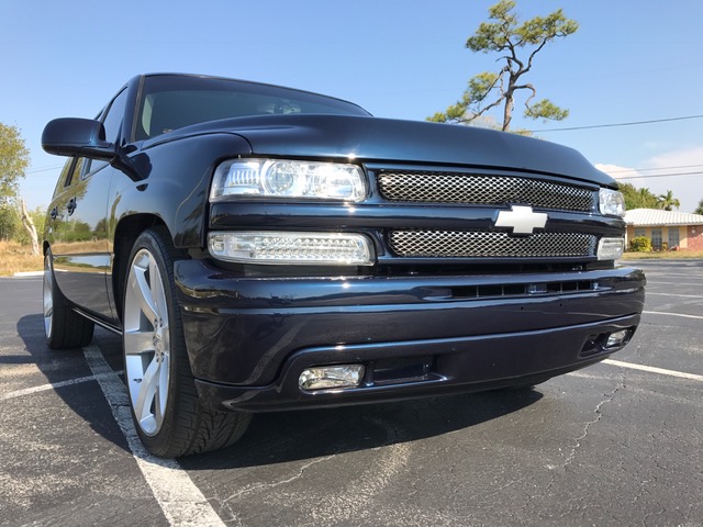

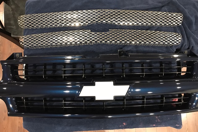

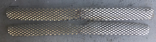

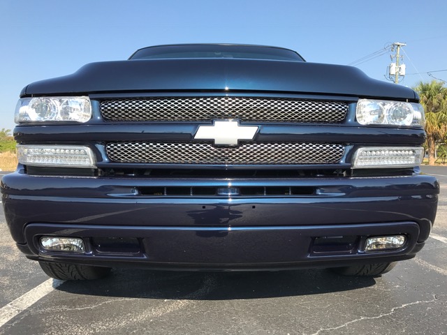

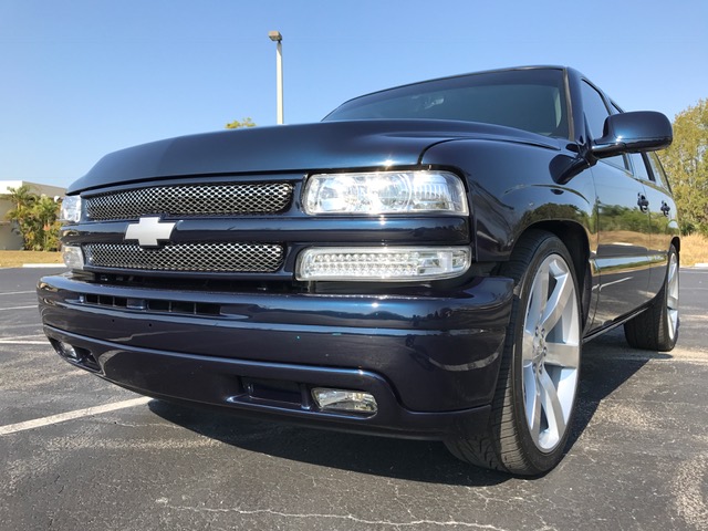

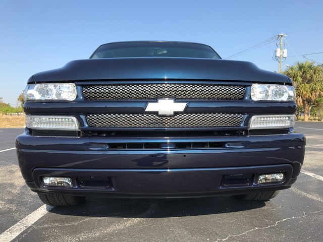

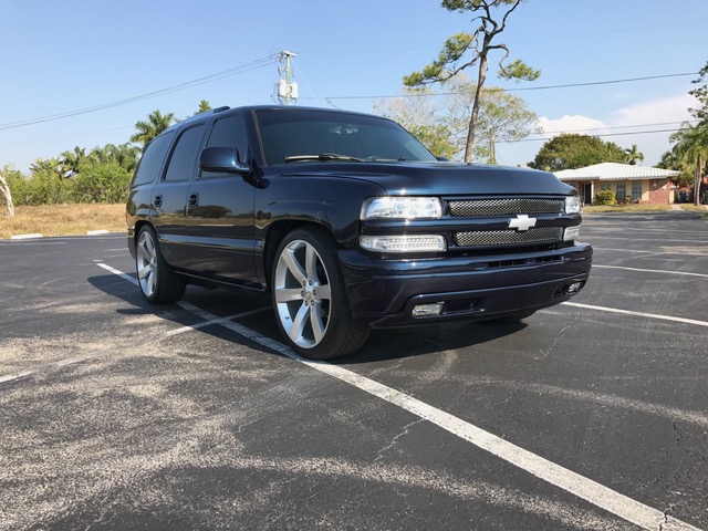

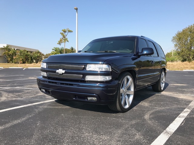

Street Scene Polished Stainless Steel Grille Inserts
Part Number 950-79140
Since you guys asked to see the Street Scene grille on the front of my truck....I hit up eBay and some guy had a brand new set of polished stainless steel inserts, plastic wrapped and still in the box, never mounted for $112 shipped. It was my lucky day. Street Scene number 950-79140. You can see on the spec sheet that they only offer black chrome, satin finish, chrome finish and stainless steel. Retail price on this unit is $190, so I scored a killer deal.

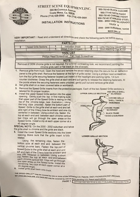

As previously stated by 05Single, this is a high quality, sturdy, lightweight mesh that is able to be manipulated during installation. I could not find any blemishes on the polished face or the back side either. A good sign of quality and attention to detail.
The fitment is pretty close to perfect. Initially I would have given it a 7 to 8, but after installation and playing with it a bit and seeing how it sits in the OEM grill as a simple insert I would raise that more 8 to 9. There was some manipulation as noted below, but nothing too tragic.

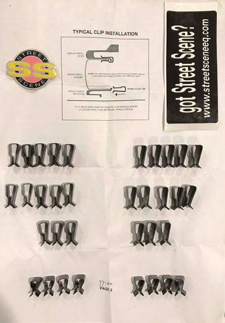

The clips on the other hand, I was not happy with. I understand their design and approach, but after trying to attach them as per the instructions and making a small unnoticeable scratch when I went to remove the test fit one, I decided to not use the clips at all and pulled out the black cable ties.
The clips have very small "teeth" on the ends that when they are slid on, they are intended to grab the SS insert and also the plastic of the grille and hold it in place tight. I wasn't happy with this fitment and the ability to clamp it down securely, remove it to clean or adjust as needed. Further to that, my grille and the inserts did not seem to match up the way it is shown in the attached installation instructions.
I used a pair of needle nose pliers to bend in the raw ends near the bow tie and at the ends of the inserts to fit the curves better, so that there was a tiny gap between the paint and the metal. That is how precise the insert is cut.
Then I just took my time and placed my cable ties equally around the backside of the grille, fed them through the insert and cinched them down to secure the insert against the ribs of the OEM grille. (Note: I did clip the long ends of the cable ties before installing the grille back on the truck. That was to show where I cinched it down in the back. You cannot see the cable ties and with a freshly painted radiator front, it is good to go.)
