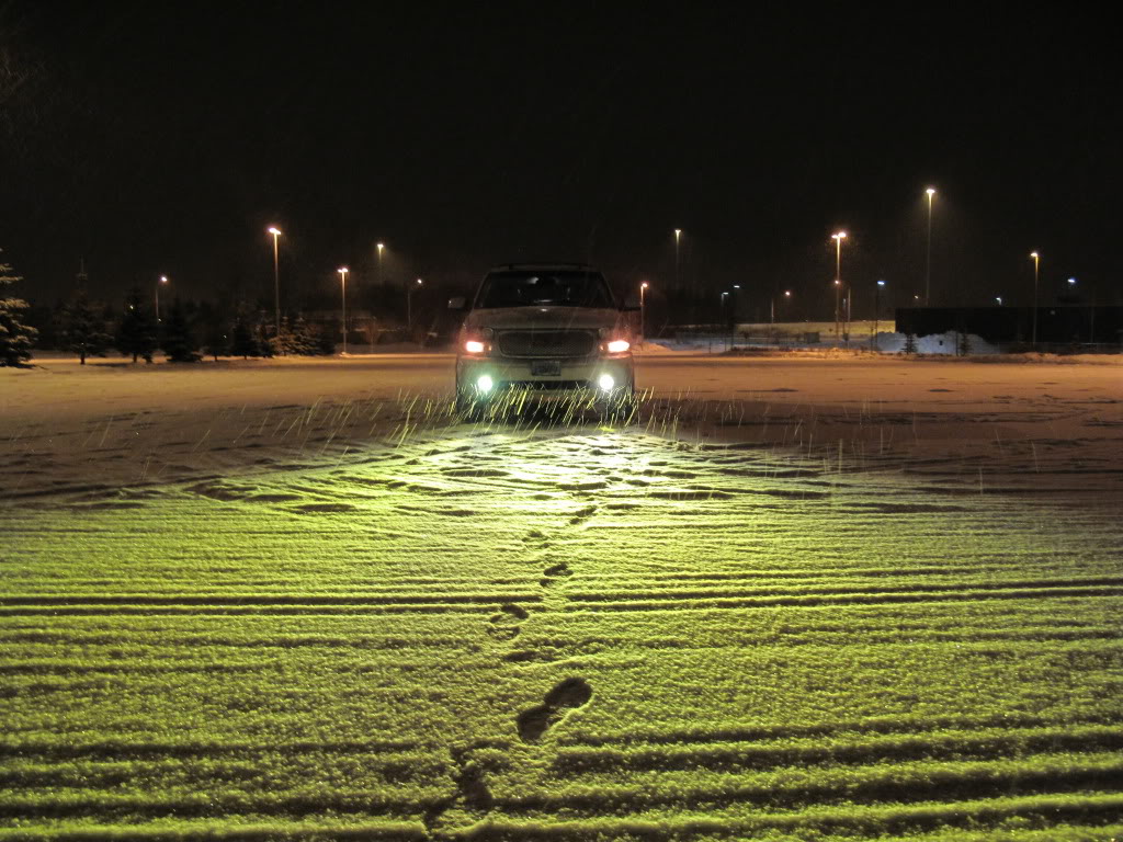

Got them installed. I'm freezing my ass off at the moment, but will take pics and adjust later tonight (I'm four hours behind you East Coast guys....). We'll see how they look, but initial impression is that I'm not blown away by the output. It may take some getting used to having a controlled beam in the fogs vs. my old, blast light everywhere reflector set up.
DenaliAK
DenaliAK
Colder than you
Aug 1, 2009
2,178
11
Alaska
Meh.
Considering these are 55w HIDs, I expected more light.

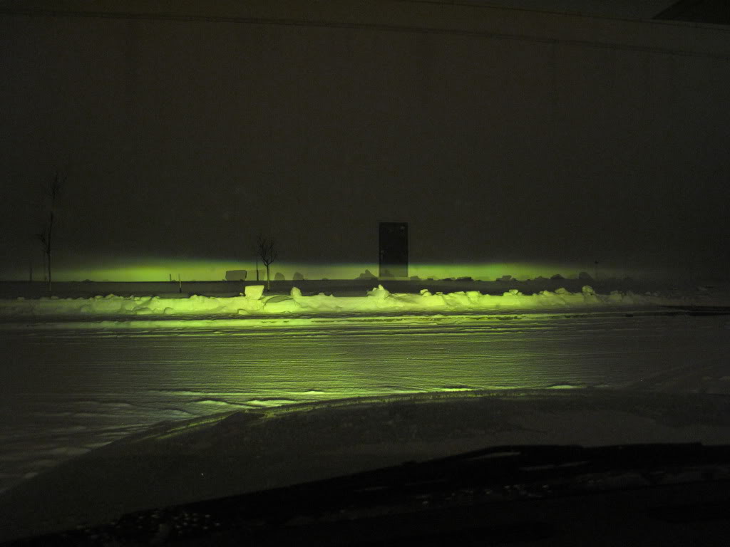

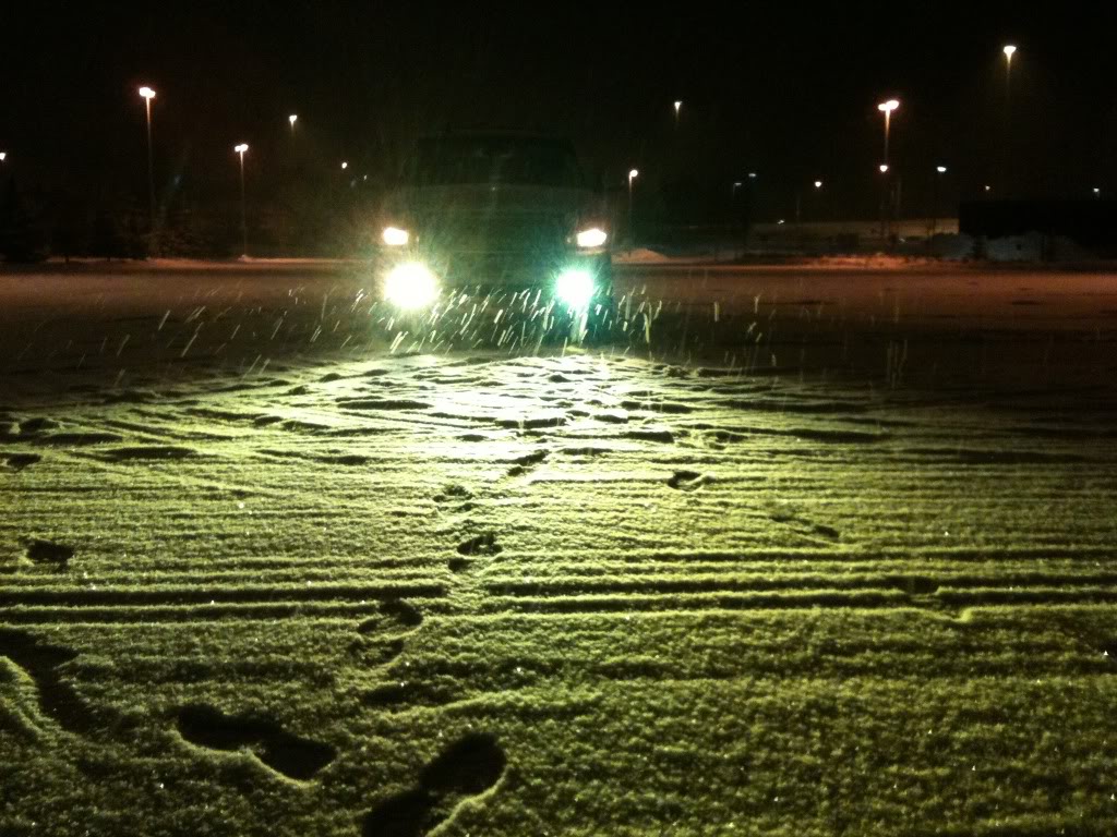

Alright spectators, here you go, a couple of output shots. I'll get some externals of what the lights actually look like in the day time tomorrow:

I think it's interesting that the flicker at the cutoff is green...it's kind of cool.

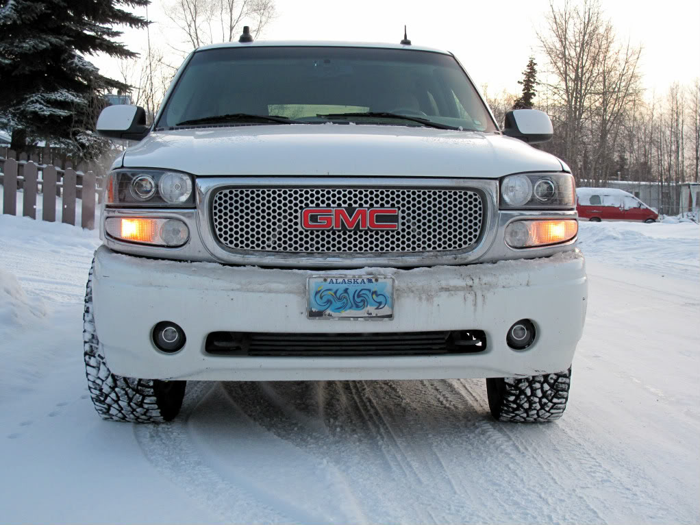

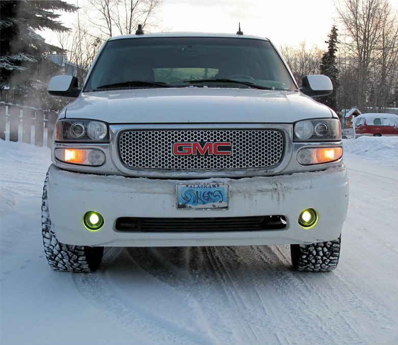

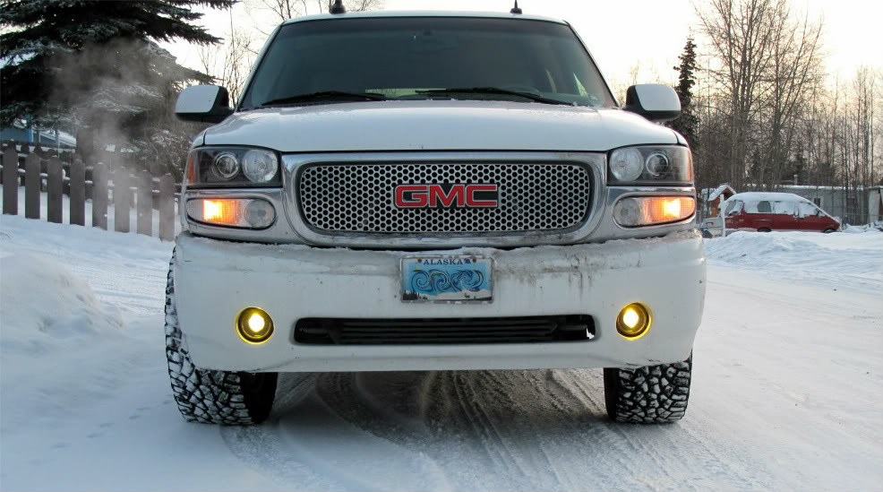

Couple of installed shots:

Yeah the yellow does look kind of green at some angles, looks cool. Nice work Scott
rippinitup
Feb 7, 2011
216
NY.
dam they look pretty nice man. looks like you can drive easily with just the fogs on. doesnt look like it has alot of width output from close range. do they?

The outter lens is diffusing the light, quite abit.
When it warms up, might want to try and chrome line those outter housings.
They also 55$ ebays, cant expect TSX or S2k quality from them.
I know your not going to want to do it, but toss a set of 4500's in them and watch how much brighter they are.
Yellow is a very deceiving color for eyeballing lumen output.
Tho they are very bright for what they are bud, dont be dissapointed.
I often finding myself wanting more lumen output from my setup, its just what happens once you go HID and projectors.
you get use to it then question your setup.
It looks really good bud.
No, there really isn't that much width to them, which isn't all that surprising given the small size and very compact bowl shape. I would have liked more width, but I'm not shocked it's lacking, either.
Thanks. I was actually thinking about trying some 4300k bulbs just for comparison. I really wanted to see the 3000k results. I bet you're right, though: I think the light would look much more impressive. All things considered, price of the projectors, etc. it came out looking really good and matches my headlights almost perfectly, and the light isn't horrible. It was worth the effort, but I will always wonder if I should have stuck with the Fusions or gotten Blazers instead. I was having so many issues with the Fusions, though. If I do anything with them in the future I am not going to take them apart at all....I just screwed them up, ultimately.

No problem..would you say these projectors have a way better output over stock?
Depends on how you define "better."
They are way more controlled, have a definite cutoff, and make running HIDs way easier on on-coming traffic's eyes. My old ones were bright, but it was just light sprayed everywhere. These are much better at having a controllable beam that you can adjust to be completely out of other's eyes.
The only way I could fairly compare the two for actual output would be to put some 4500k bulbs in them and see how they do. I imagine it would make it look much brighter than the 3000k lights.
As they are now, I can drive down the street with just the fogs, but they only throw so far, especially being that close to the ground.

buy another set and do this with out the outer housings.
Completely reversible mod.
think you will find, they will look identical visually from the front and without the extra glass you will get this much sharper and wider
I'm contemplating getting another set and just mounting them under the bumper in between the tow hooks. That'd give me a fair comparison. I'd run 4300k, too.

Looks like you did another killer job on the retro's, it's nice having the cutoff built into the fogs so like you said you can drive around with them on and not blind the others around you!!

While I'm happy with the look, I'm not pleased with the overall output. There just isn't much added light in the whole equation. That said, they are 3000k. Very yellow 3000k, too, I might add. If you want a deep yellow light, get the Morimoto's. They aren't messing around. I have a feeling the coating to get that color is cutting the output lumens significantly. When I get some more cash I'll order some 4300k bulbs to match my headlights and try that combo out. I think that's going to give me much more light.
I was in the yard when my wife came home the other night, and I have to say it looks pretty darn good coming at you. The cutoff does a good job, too. I didn't get any light directly in the eyes, and I even squatted down a bit to be more at another driver's level.
All in all, I settled, and it's going to bug me. Next time I'll do it proper. There's enough room on the Denali to fit almost any projector in there, so I may go more all out. It'd be sick to get the throw of an S2000 projector in the fogs, and I may try. Right now, I'm working on a more basic project: Scraping together some Hella 500's to put on a homemade little light bar. For now, I'm just going to stick with 100w halogen bulbs and see how they work, but I may do an HID conversion on those, too, eventually....we'll see. I'm trying to design it so the light bar is kind of universal and attaches to the license plate screw holes so I can transfer it from one car to another with minimal effort. I'll wire both cars up and come up with some quick connections in the grill.
