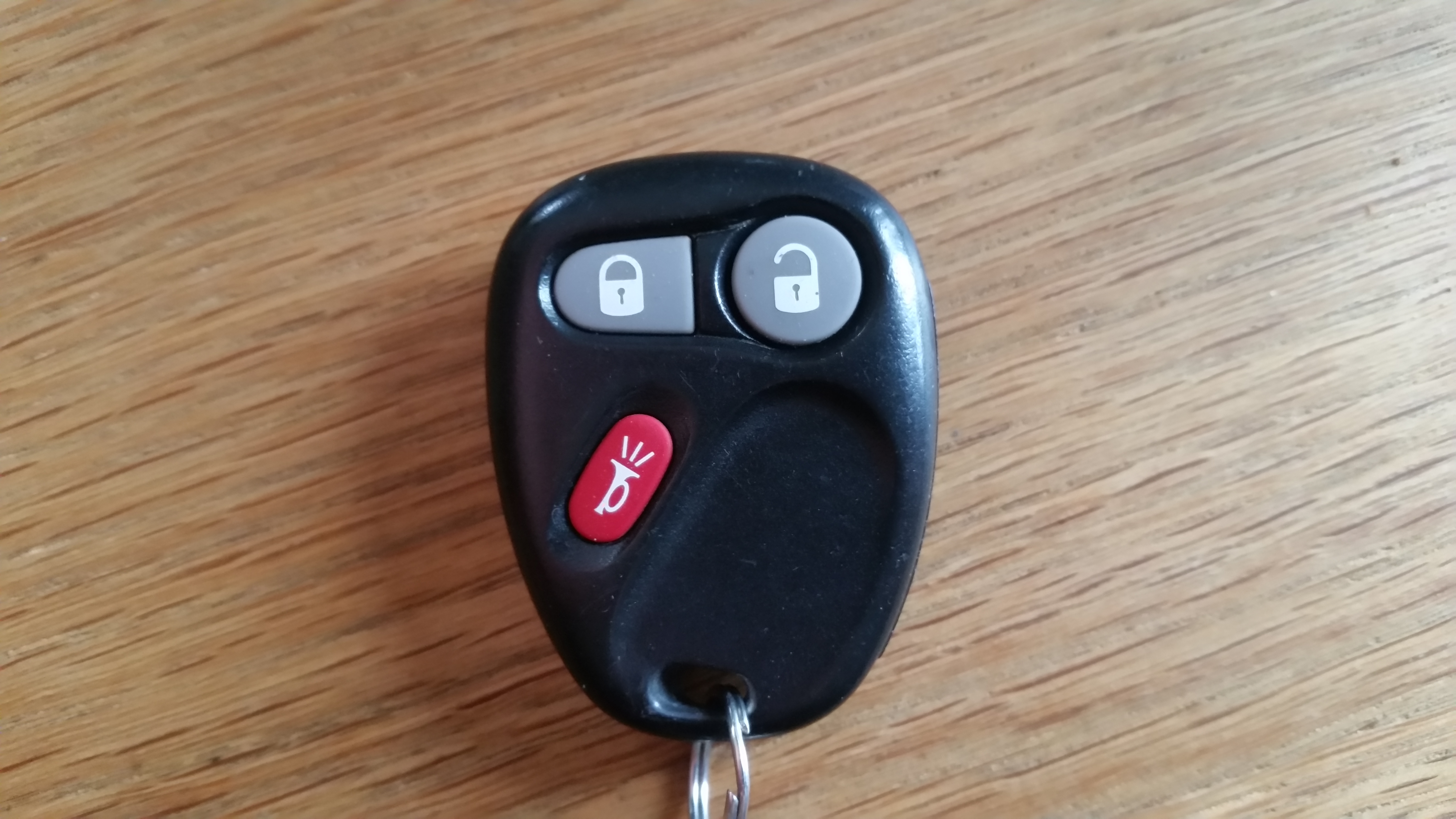

Hi.
What is the correct fob key for the Tahoe 2002?
Have seen som variations of them and I have on both my controllers the functions shown in symbols and not written.
Have also seen there are a controller with a open cargo button, have our trucks any support for this function? :)

Mine has Lock, Unlock, and panic. Pretty basic. The GM code on the back is 15042968.

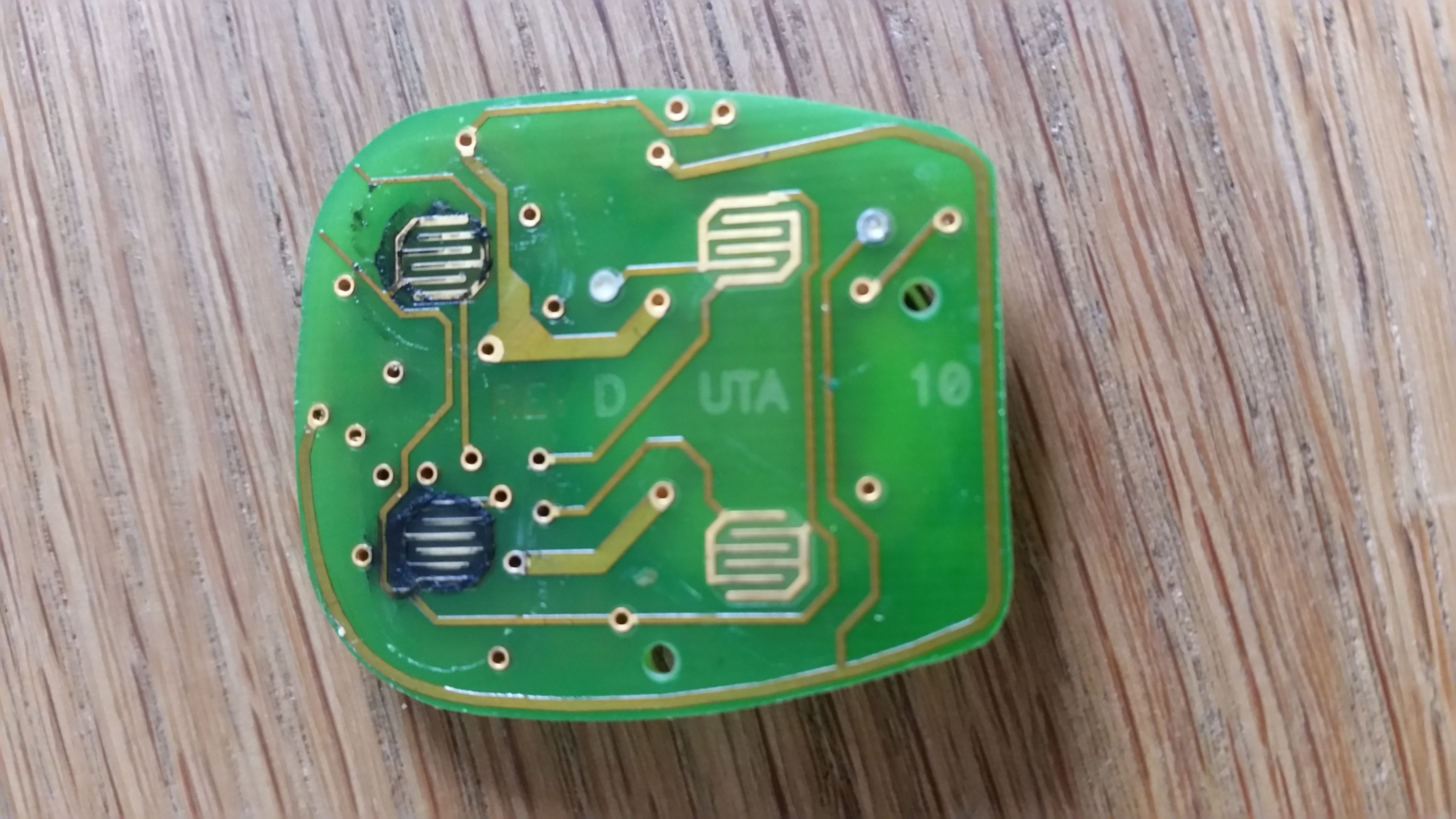

I have the GM/UTA15732808.
When I open the controller so can you see that on the circuit board there are on slot for the cargo area but not anything on the outer case. :)

Have poked around now on the net and I have the right controller for the truck.
I was in mission to buy new ones because mine are all broken around the sealant.
Now I have a Truck for the EU market and this EU ain't anything but a cancer. Anyway we are forced to have a other frequency and the rpo AU8 - REMOTE ENTRY LOCK CONTROL state this, which I have.
Now the GM/UTA15732808 are out of production and what I can see so can't it be found anywhere.
