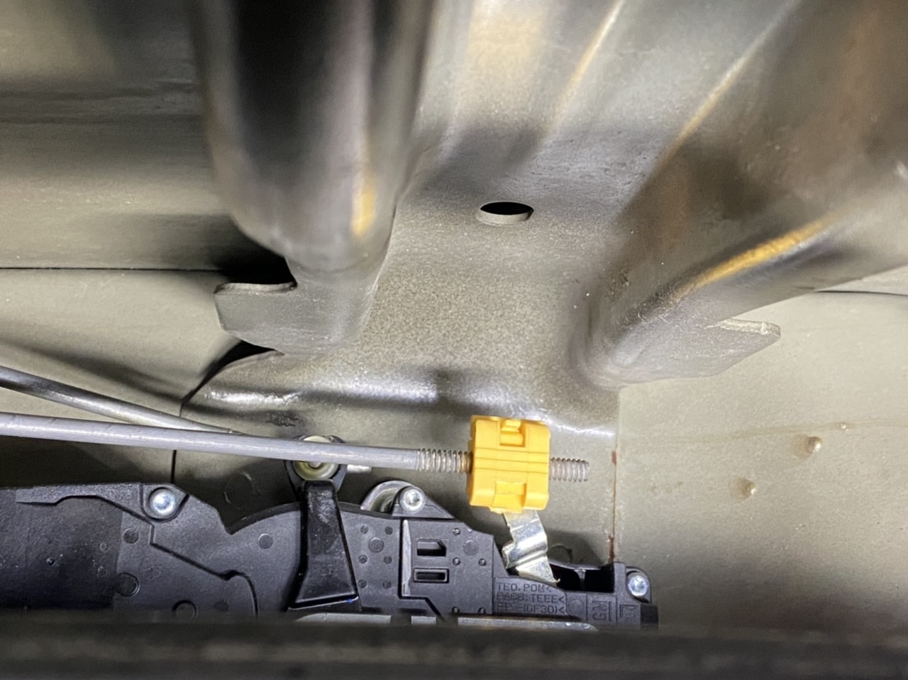

Thanks to the post link d below I realized it was the electrical connection within my door latch that caused the problem of lights and radio not turning off when driver door was opened...
https://www.tahoeyukonforum.com/threads/radio-and-interior-lights-wont-turn-off.91718/
(The link is a repair for 2004 body style latch).

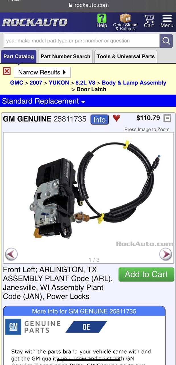

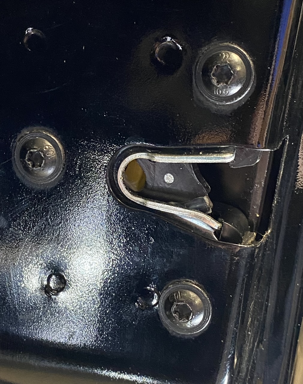

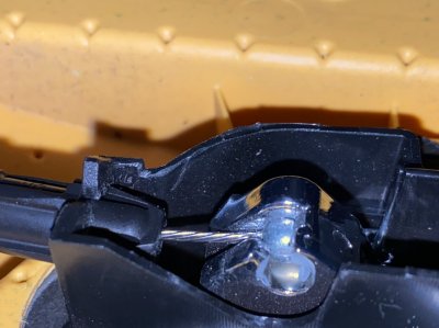

I simply decided to replace the entire latch with this...

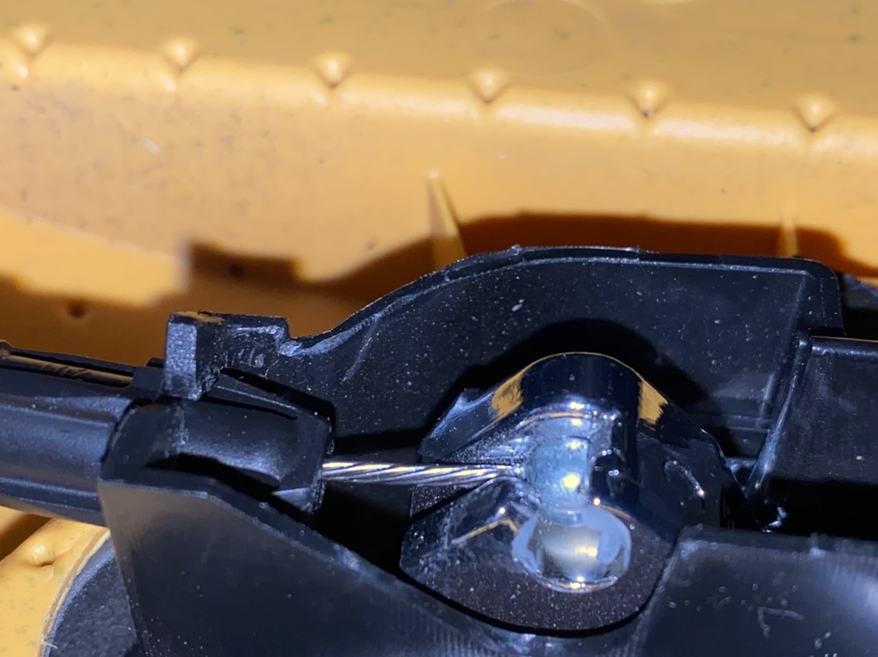

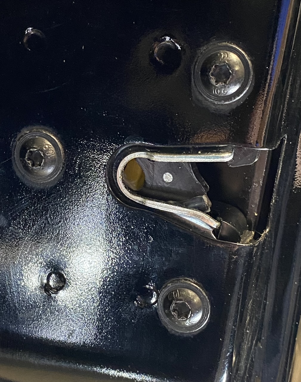

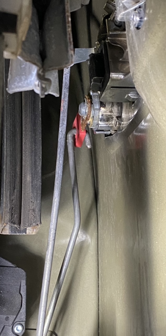

Works like new yet again! Some pics...
Remove these...

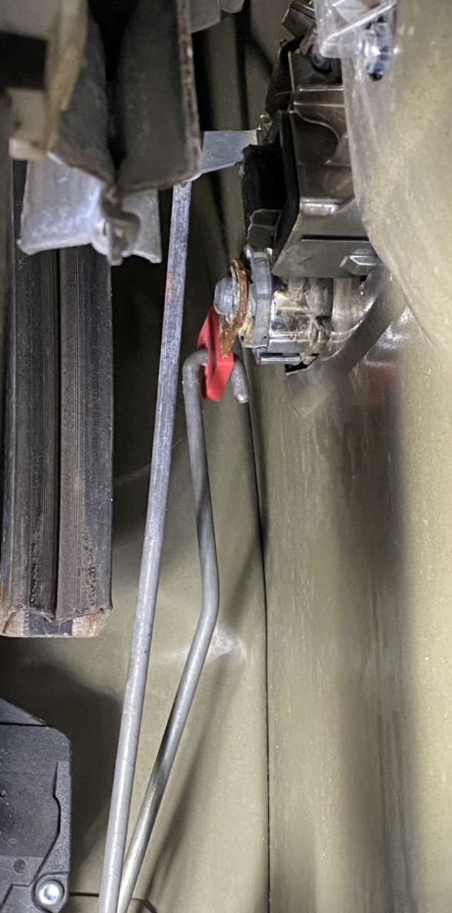

Push the rod out of red lock mechanism..

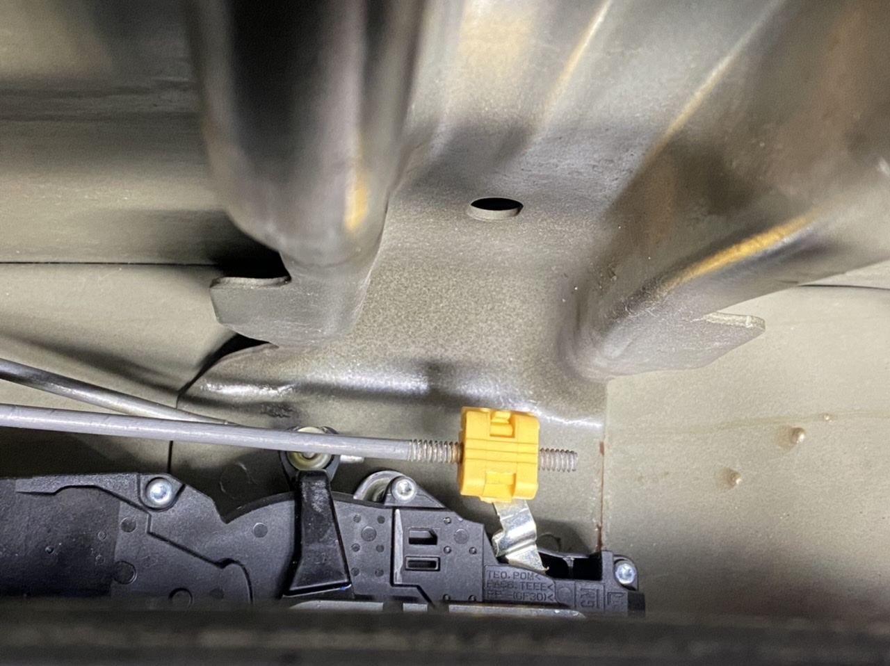

Unclip the yellow clip... B25BFD71-5AFF-4F68-9936-F2517DC1D5FA.jpeg 74083E3D-5D54-4488-AE43-073CAFD66CAA.jpeg

How painful was it to get the latch alignment set up so it closed and reopened okay?
There is no adjustment when mounting those latch assemblies, they only bolt into one position. Only thing adjustable is the door strikers on the jambs. None of the 3 I replaced needed any addjustment.
Remove these...
Unclip the yellow clip... View attachment 270205 View attachment 270206
