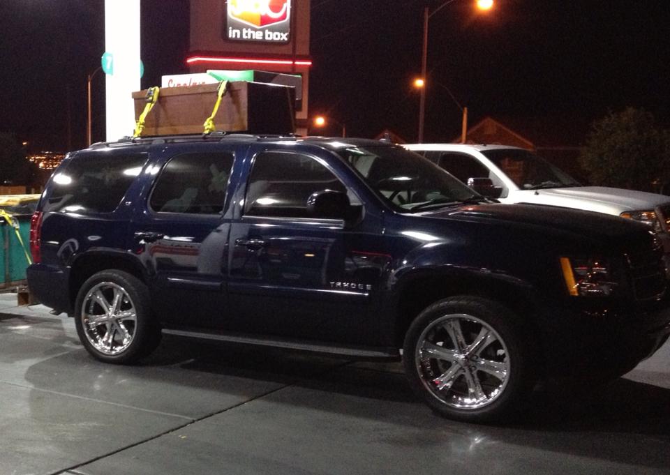

2007 blue Tahoe 4x4(1st year): I kick myself everyday for trading this thing in. I should've just kept it as a "beater". I bought it in 2012 with 50k miles and traded it in with 120k miles. Besides routine maintenance the only issue I ever had with it was a leaky front axle seal at 90k miles. (it was 4x4 and I bought it with the 22's but changed them out after moving up north)

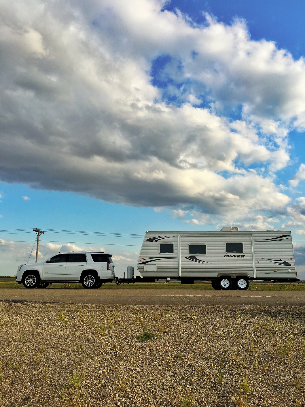

2015 white Yukon Denali 4x4(1st year, early run - 6 speed transmission): I purchased this one in 2016 with 58k miles. Besides routine maintenance it did drop a valve and was covered under warranty - the dealership said it was a bad valve casting and did no further damage so they only replaced that valve. I traded it in with 90k miles. Wife wanted an XL because of the new baby.

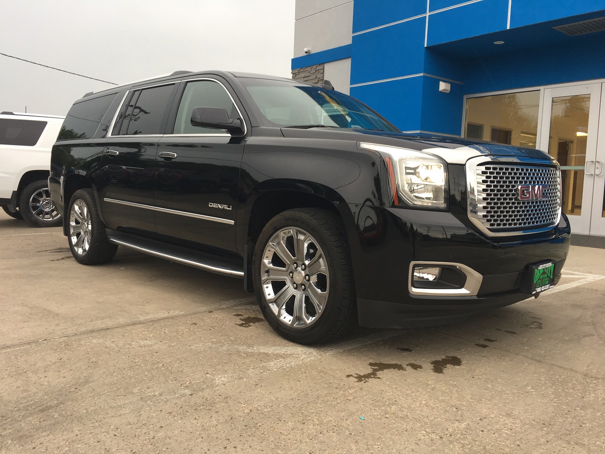

2015 black Yukon Denali XL 4x4 (1st year, late run 8 speed transmission): I purchased this one in 2018 with 27k miles and still own it. Currently it has 32k miles and it's had zero issues besides a service parking assist error after another car backed into the bumper.
