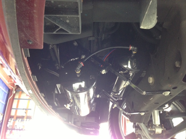

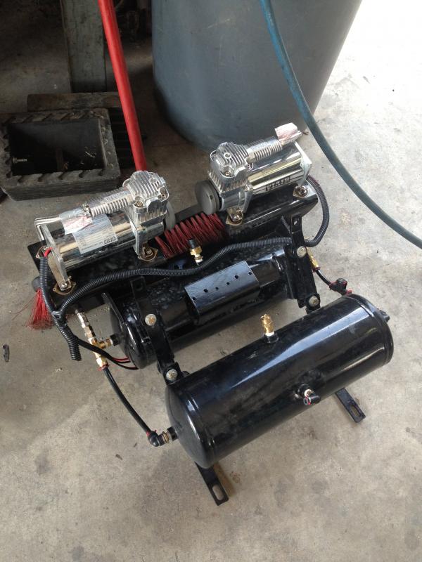

BTW, here's a couple pics of my tanks and compressors.

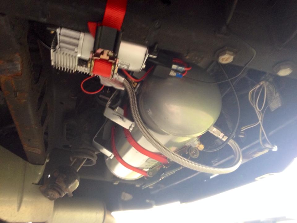

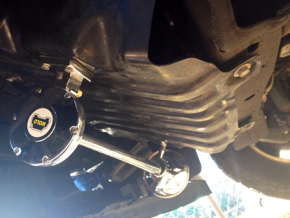

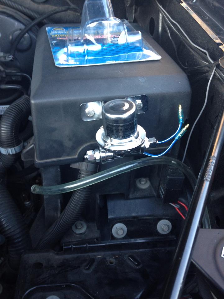

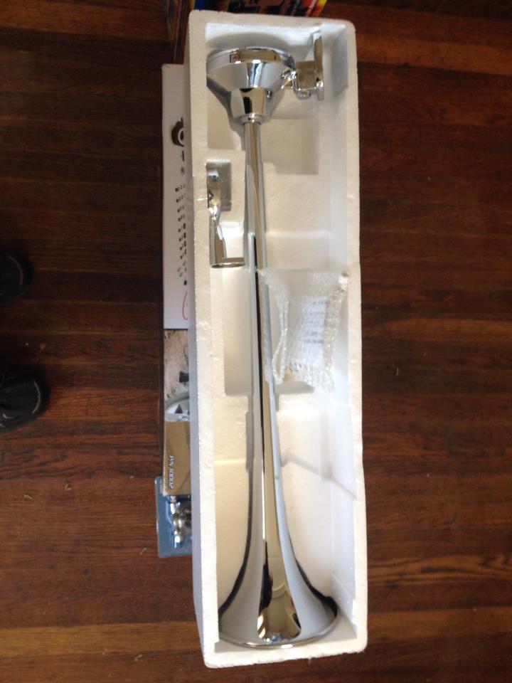

well i finally have the time to put the post up of the install. tried to take pictures as i did the install, but it got dark so i finished the install and took pics. i went with the Viair quarter duty OBA, Wolo the chief air horn, along with a Wolo electric solenoid for the air horn. the pics of the air horn and solenoid are without the air line yet. soon i will be attaching a multi-port connection and more air line to add in a couple connections for using air tools and inflating tires, etc....air tank and compressor are mounted using ratchet straps, only as a temporary means until i get some brackets made.

The ratchet strap cracked me up! I would recommend some brackets pretty soon haha
I used to have an onboard air system, 5 gal tank, 2 viair compressor, nathan k3, etc. Lot of fun but it seemed like I was always having to mess with wiring, pressure switches, leaks, etc. Very useful though!

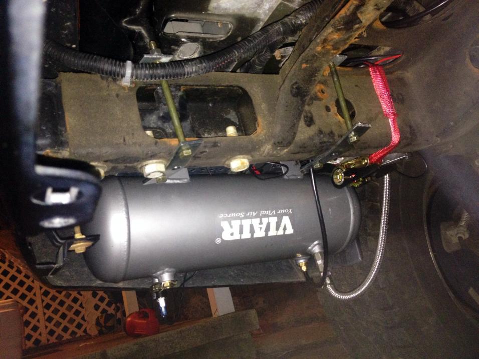

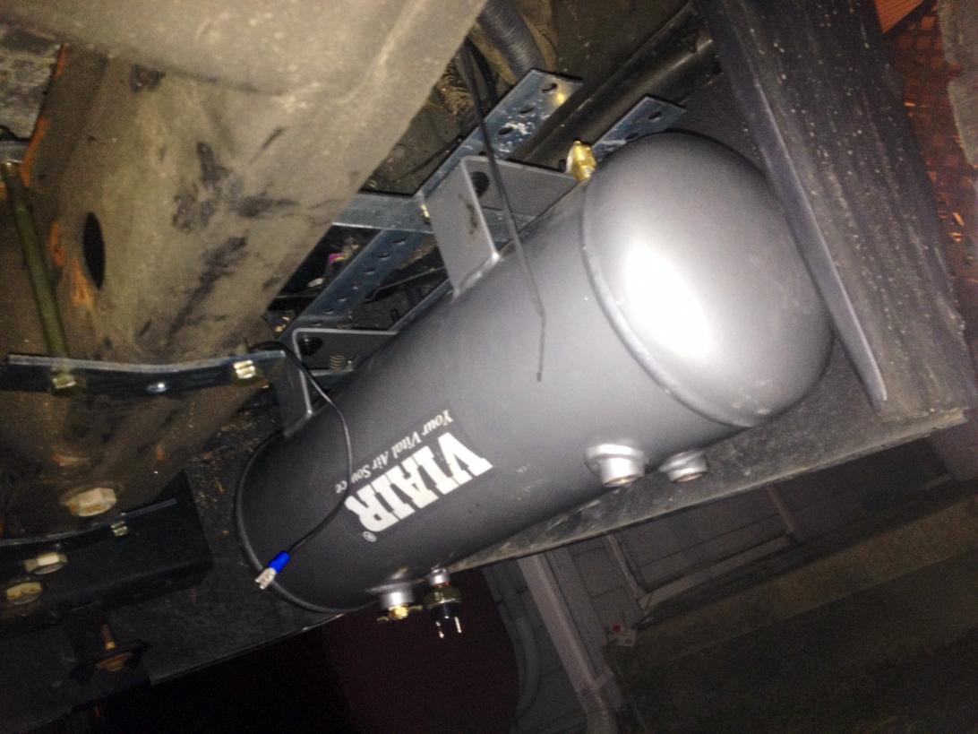

finally had the time to make a bracket for the tank. took me a few hours to make and a lot of patience with it, but its better than the ratchet straps..i can now put my spare tire back on and call it a day. the only thing left i need to do is order the Viair mounting bracket for the compressor and that will be set. so far this thing has been awesome!!

Well I see an issue with your setup. You have all of your fittings on the bottom of your tank. Where does water collect? On the bottom. Your pressure switch and wiring are on the bottom asking to be knocked off from road debris. All of the water will be blown out the horn causing a short life span. Time to re-think your install and move it to a better/safer place.
x2
fittings, lines need to be up top and drain plug on bottom. You're almost asking it to fail

makes sense...honestly did not even think about any of that happening. with that said, i can just switch where the safety relief and drain fittings around and flip the tank so everything is on top. ill get on it probably tomorrow when its nice out. not sure where else to mount the tank itself but ill look underneath and see.. thanks for the help and advice guys, its a big help!!
