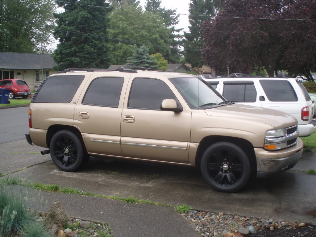

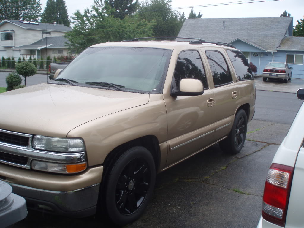

finally figured out how to post pics
---------- Post added at 10:49 PM ---------- Previous post was at 10:46 PM ----------
the drop is the belltech 4230 coils out back with shock extensions, and spindles and keys up front. It rides like shit and i think the shocks are holding up the rear cause you can hear the coils rattling around so i am gonna be ordering some adjustable qa1 shocks for rear to see if that helps and maybe it will even lower a tad more

Black on gold looks good man...
Hear the coils rattling around? I don't think that's your coils you hear. Check all the bolts on your shocks and shock extenders.

still have to tweak it a little cause i thoght i would be sittin at atleast 32" maybe even lower out back with the trailblazer coils but it sits at 34" right now so im a little disappointed

Looks good, but not low enough like you said.
I sit at 34" with my 07 with 6s, keeping in mind the NNBS start a bit over an inch higher on all four corners unlike the NBS.
Also, with th 4230 coils, the DJM free travel mod has to be done to get the full amount of drop, so after doing that and shocks, you should be at around 32-32.5"

Look good man. Like Boss said, I'm pretty sure its not your coils that are rattling around. Devious, they seem to be 07+ NNBS GMC 20' wheels..

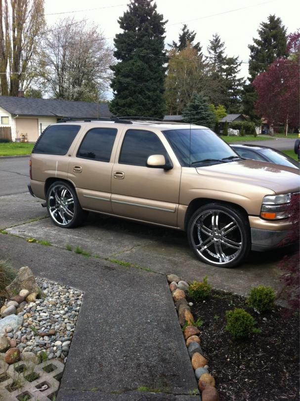

Rehashing an old post. But I need opinions, I purchased 26" wheels and I would like to powder coat them but I want something over the top but still looks good with the gold color the tahoe is. That is where you guys come in, help me choose an over the top color that won't look horrible with the color of the tahoe

id powder coat them black with gold pinstriping or incorporate the gold paint on there somehow! pics of new wheels would help!

Post a pic of the wheels. It could give us an idea of what you could do to make them unique.
