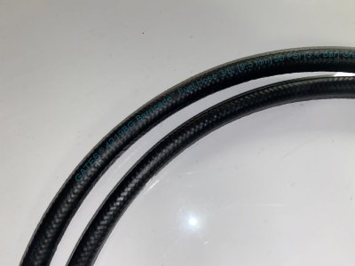

What are y’all using for the hose material? My local store didn’t have vacuum lines that size, so I ended up using fuel line. As I feared it doesn’t hold the shape. I’m not sure if that’s a big concern.
wsteele
Dec 26, 2020
1,731
2,355
I used braid reinforced fuel line (what came with the can), it is pretty stiff, definitely isn't going to collapse under vacuum.

3/8 braid reinforced fuel line. Works well.
@wsteele thats what I have as well.
