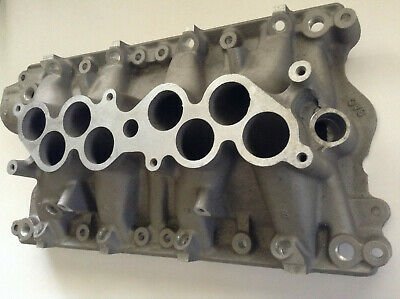

The PCV on my Ford pushrod motor is at the back of the lower intake. Short hose runs to the back of the upper intake. Only opening in the valve covers is the oil fill.
PCV hole is the right-most hole in the pic...
