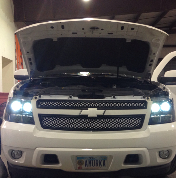

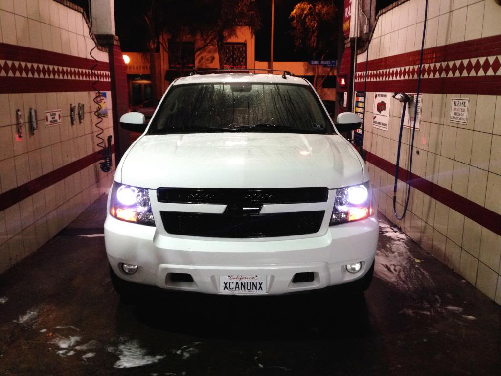

Got done with the install last night. Couldn't be any happier!
Specs:
Mini H1 bixenon projector
Morimoto XB35 5000k bulbs
Iris Shroud

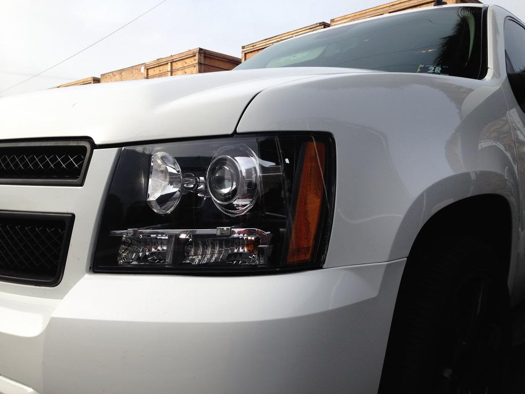

Did you do the build or did you source them out? To who? They look great. I am going to get a set and those look perfect.
evoalex
evoalex
Nov 12, 2011
127
8
I sourced them out to "visionautoworks" on ebay. I was patient in receiving them because they had forewarned me that they were behind about 4 builds. So I got them in about a month an a half (since they make each headlight to the customers specifications).

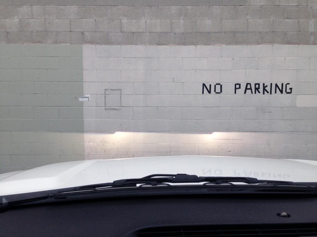

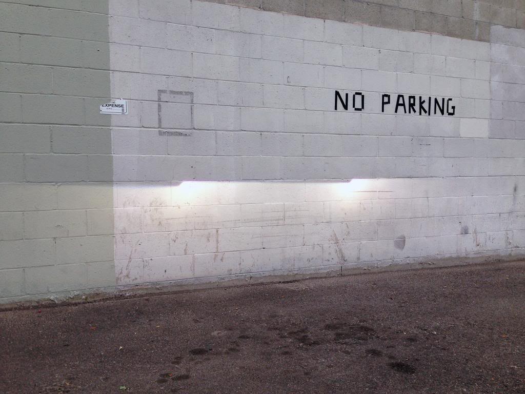

Easy plug and play and I had them installed in about 45 minutes. Then just went over to a wall and aligned them in about a minute.

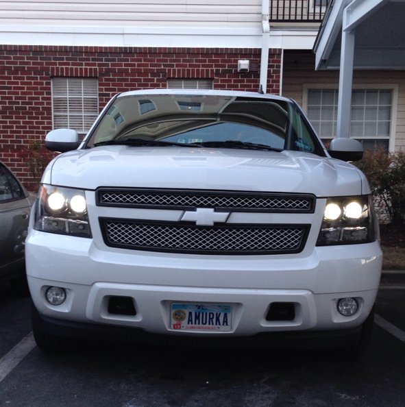

could just be the camera angles but the cutoffs look aligned but crooked.
evoalex
evoalex
Nov 12, 2011
127
8
Probably counter clockwise a hair on each. That's what it looks like.
