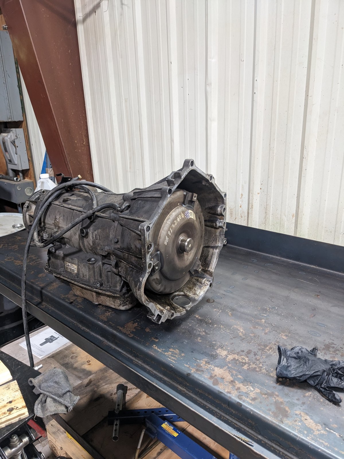

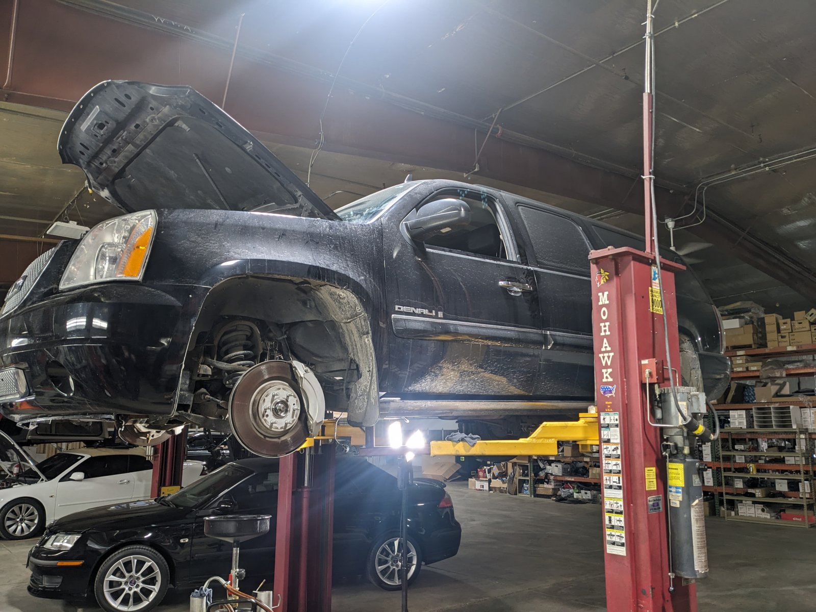

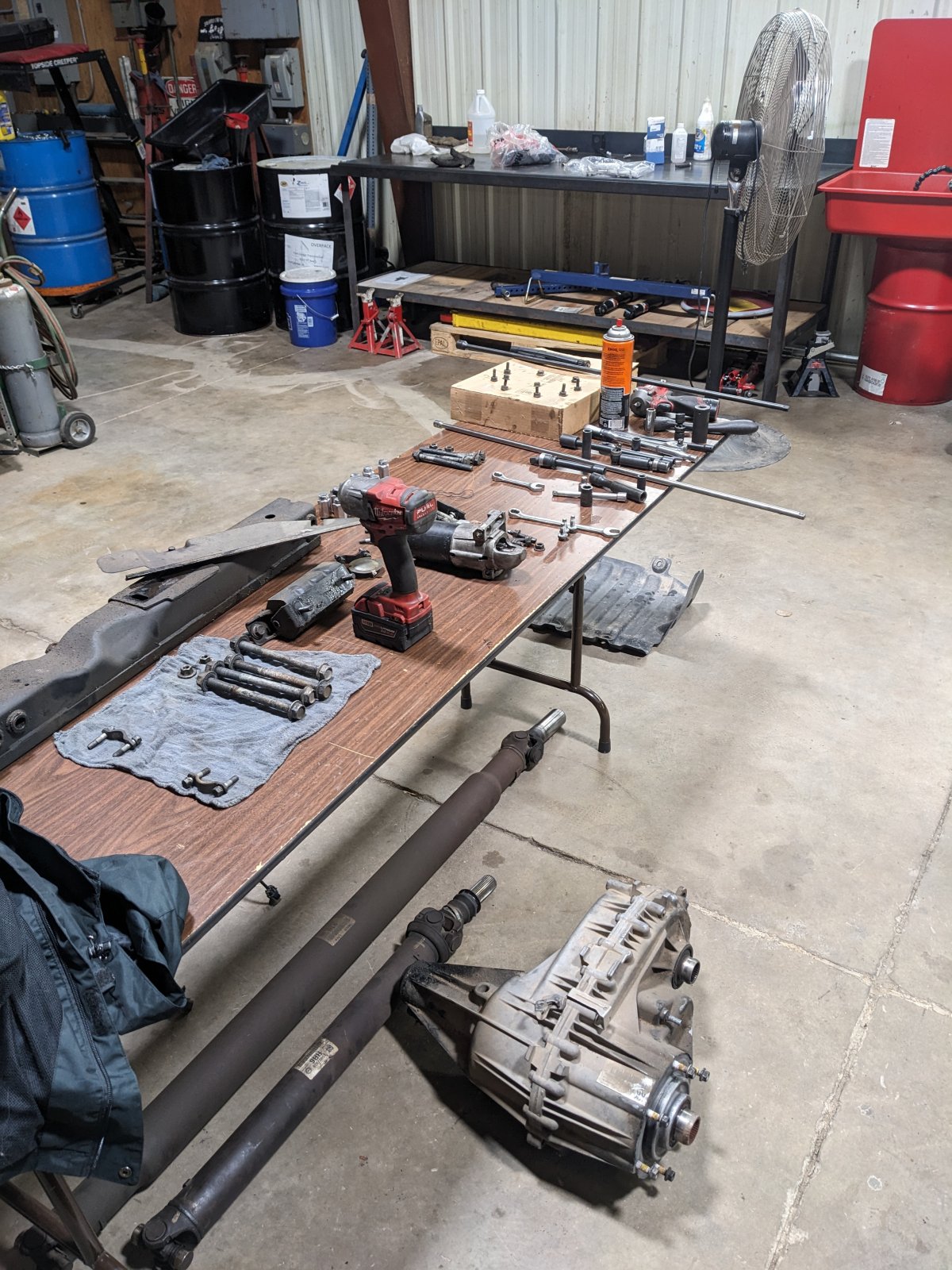

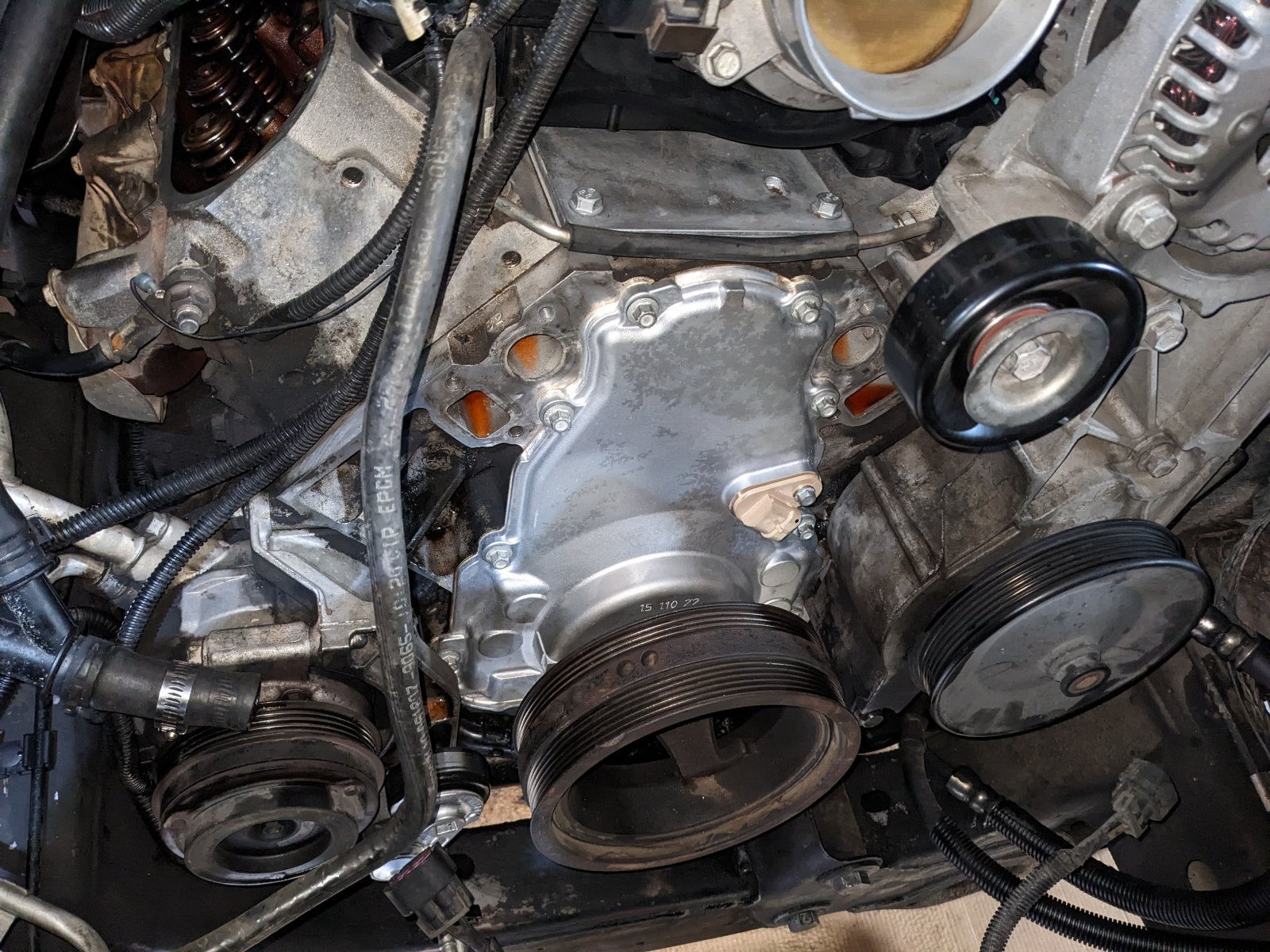

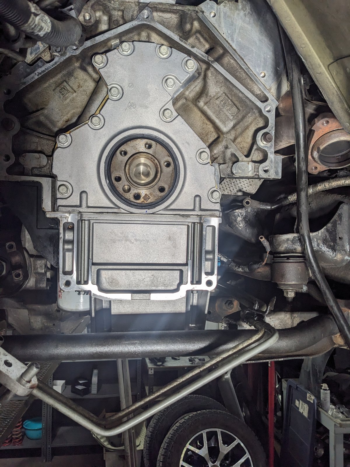

Haven't had to do much maintenance this last year ever since resealing most all of the engine gaskets, but still had a small leak from the rear seal. Finally pulled the trans today. This week I'll be putting on a new rear cover/seal, new torque converter seals (24237531 & 24219390) and a new torque converter for good measure. Also doing a new barbell on the rear of the engine while I'm in there. Should finally be leak free after this.
242k miles on this 2007 Denali. Deleted the VVT about a year ago and put in a small cam. Probably will be selling the truck this Spring as I just picked up another, an 08 Escalade ESV in Pearl White with only 140k.

Are those the Cadillac CTS brake calipers?
They are the PPV 16" brakes. Had them for a year now and still love them.

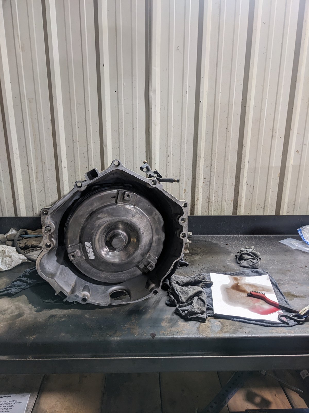

Been just chipping away at this after work this week. Got the trans bolted back up with a new torque converter. Transfer case went back in with a new output shaft seal (89059495). There's a chance it all gets wrapped up tonight.

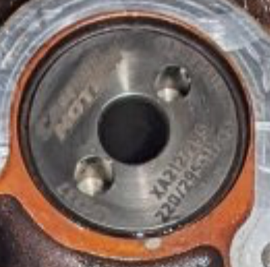

Are you sure you still have VVT enabled on that engine? The back of that cam says Cam Motion and I'm 99% sure they make only 3-bolt cams.
Hard to make out the specs but it looks like it might be their Stage 2 Truck cam based on the 212 & 220 that I can see - most likely the 'drop-in' version:

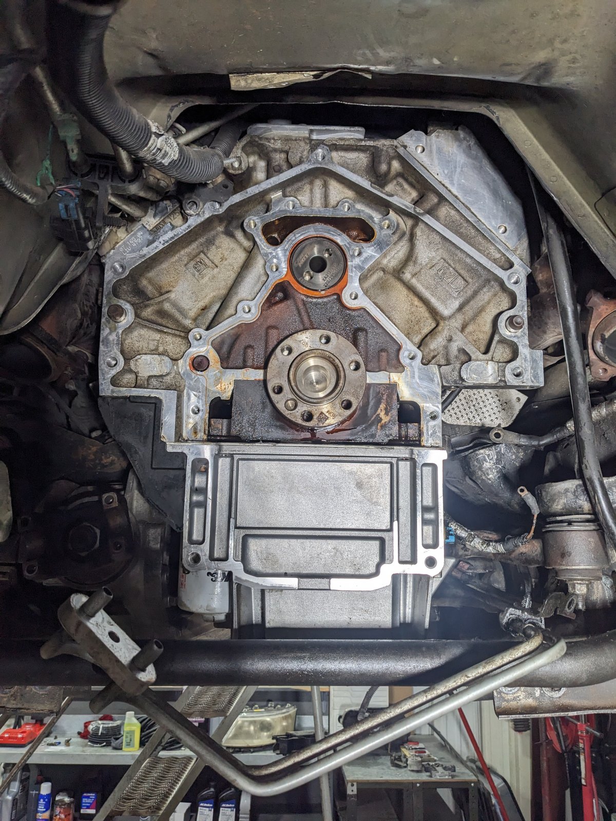

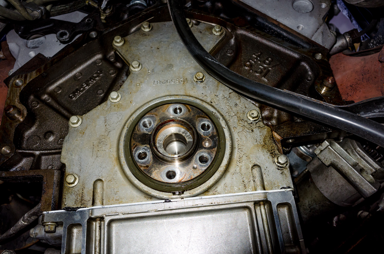

Can you post pics of the old seal so we can see how a "bad seal" looks?
Yes, it is a drop in 212/220 version. The front of the cam is 3 bolts despite what the rear looks like. VVT was deleted.
This was mine. The RMS itself probably wasn't leaking much if at all. It was the rear cover that was leaking so much. Once i had the cover off the gasket was so compressed there was no way it could seal properly anymore. New RMS and gasket has been on since June 2020 and no leaks. (Still need to do the front seal though. But rear bearings are more important now.)

Just like the VLOM gaskets that go bad. Very interesting. Appreciate you posting this and the pic.

Same story here too. The RMS itself was probably fine, but the gasket was flat. I had a small leak from the cover gasket combined with a small leak from the torque converter seals. The transmission shaft o-ring (24219390) was rock hard and felt like plastic and the torque converter seal (24237531) had signs of leaking due to some grime inside the bell housing behind the torque converter.
Got the truck started last night and so far so good, no leaks after idling for about 30 minutes.
