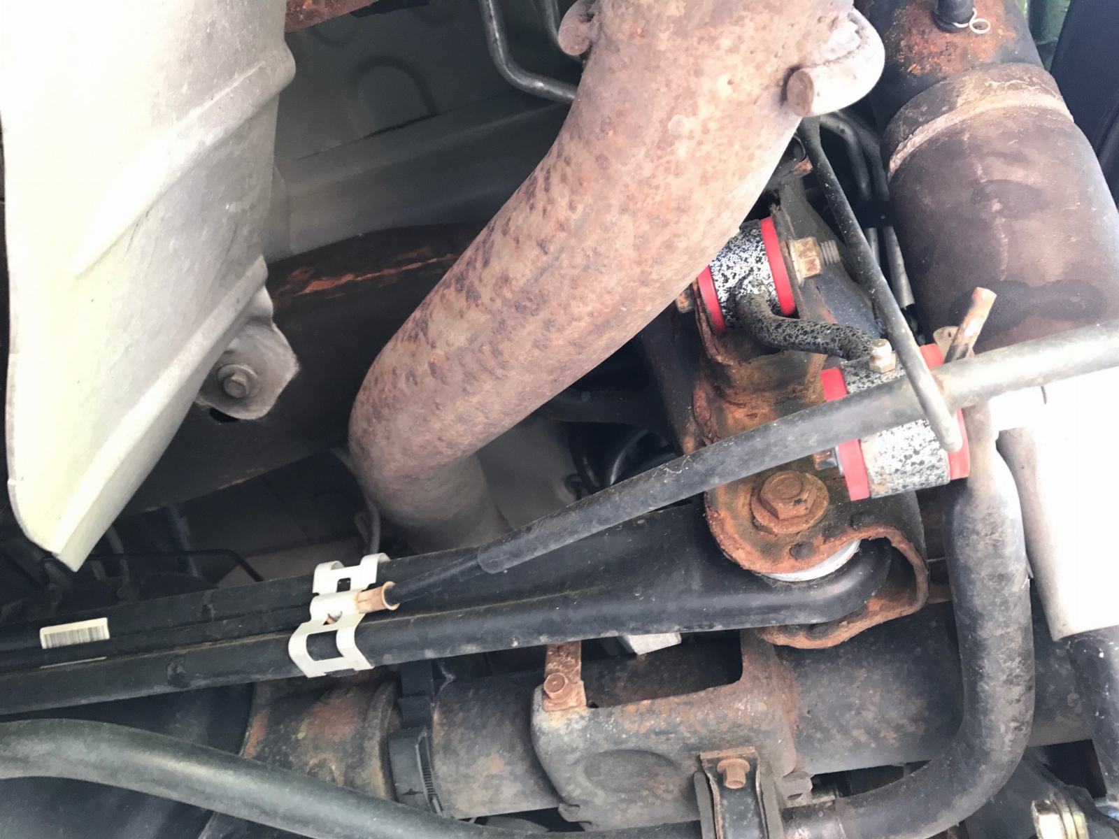

I noticed in your endlink pictures that you did not move your swaybar brackets. I thought in order to install those endlinks properly, you had to relocate the driver side swaybar bracket on the axle approx. 2 inches to towards the passenger side.

I thought so too but my mechanic managed to install it without it interfering with anything.... I hope it put on right as I'm not mechanically inclined...

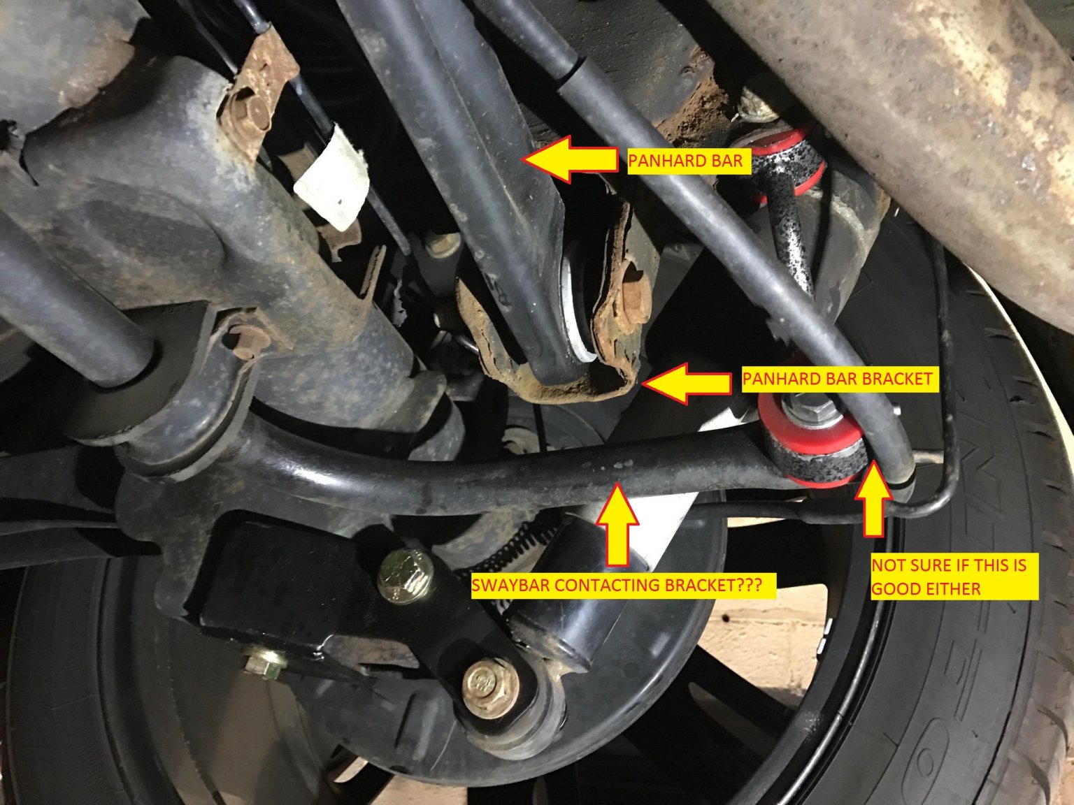

I could be wrong, but the reason you have to slide the swaybar over towards the passenger side (right side) is to clear the panhard bracket (located on passenger side of vehicle - see image below). Can you take more pictures of that area to show clearance between bracket and swaybar (maybe face camera upwards as shown by arrow with text "SWAYBAR CONTACTING BRACKET???" in image below).

Ok... I will definitely take some pictures today as I'm now curious to know if my sway bar is on correct..... thanks again guys ....

Well after taken pictures I noticed that the sway bar is actually about a quarter inch off the shock on passenger side.... please let me know if the links were put on wrong or if there's anything else I could do to put it the way it's suppose to be

Thanks for the pictures! It seems like you have clearance. I also notice that your swaybar is shifted (based on the clean rub marks on your swaybar just to the right of the right swaybar bracket). Now I'm curious to see better pictures of your left side swaybar bracket. :D

Thanks bro... the mechanic was able to slide the bar over about 1/2 inch without relocating the bracket thus the marks on the swaybar...

Flip the bolt arround. Put the head on the other side. Less chance it has to hit the air bag
