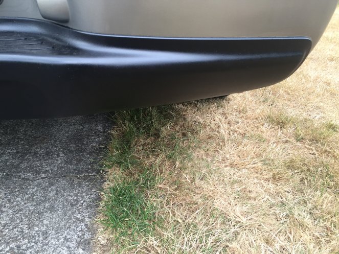

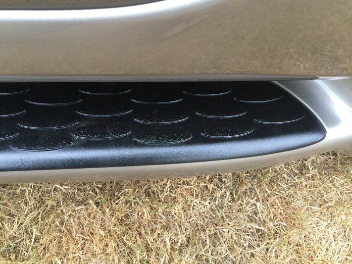

I just removed one of my running boards and tried the heatgun method. It didn't work on the raised pattern, the area where the raised ovals meet the surface were untouched by the heat and it was leaving white rings around them.
52,956

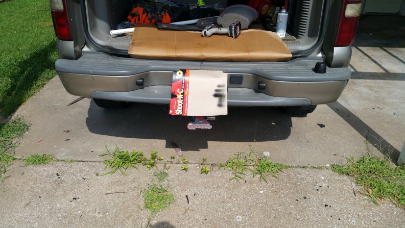

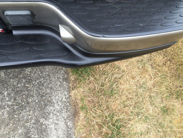

Yeah I stopped just before I melted the damn things! The white rings were still there after it cooled down. I ended up painting them and then the rear bumper covers too with Krylon Fusion satin black. Came out nice, and I heard it wears well.
