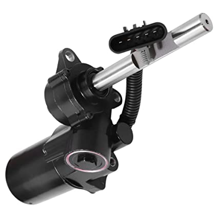

Ken, I believe the harness connector for these would be coming off the frame rail, up closer to the front of where the running board mounts. I couldn't find a pic of the area or plug, but it should be the 5-pin female side of what plugs to this:
