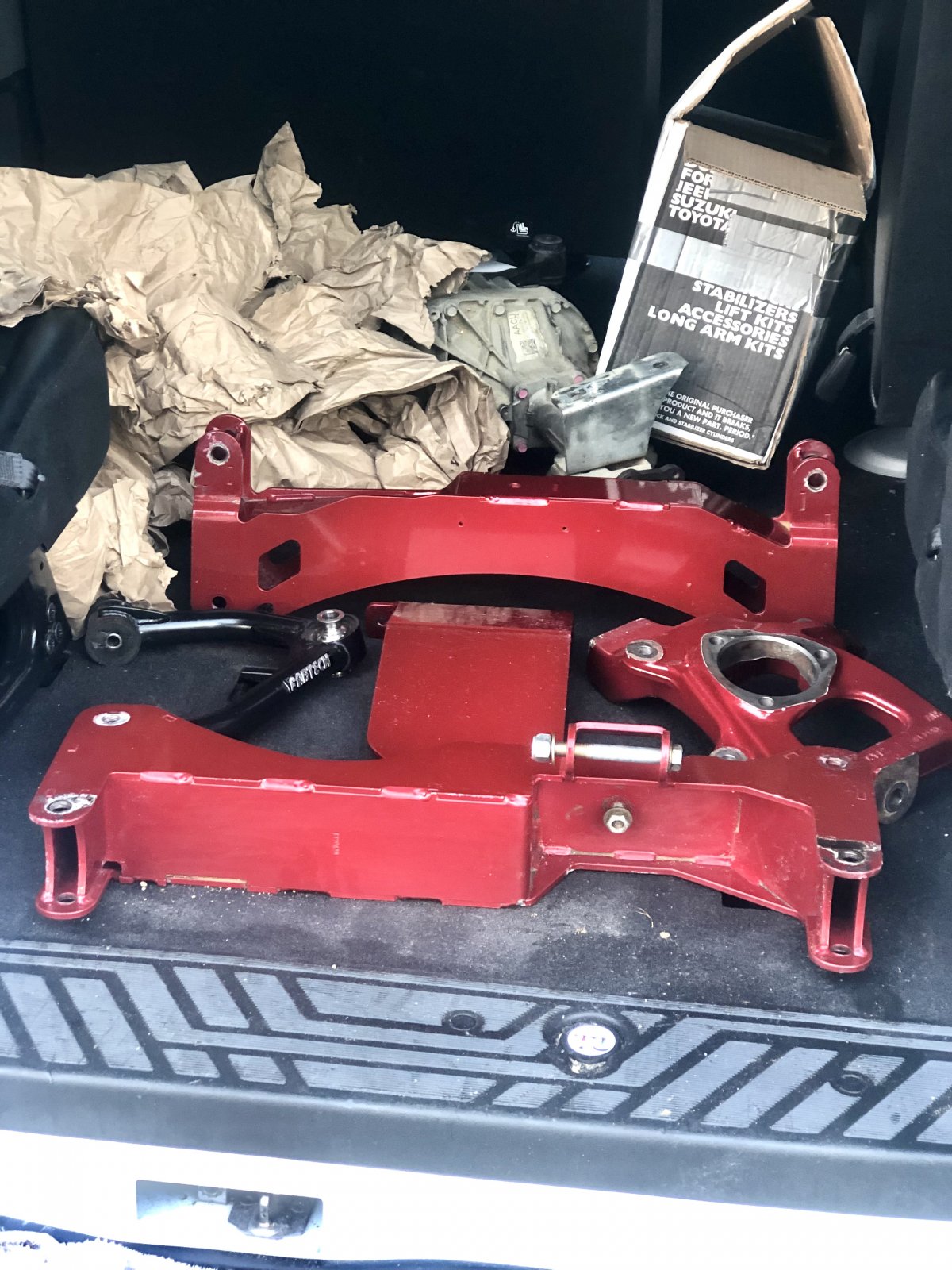

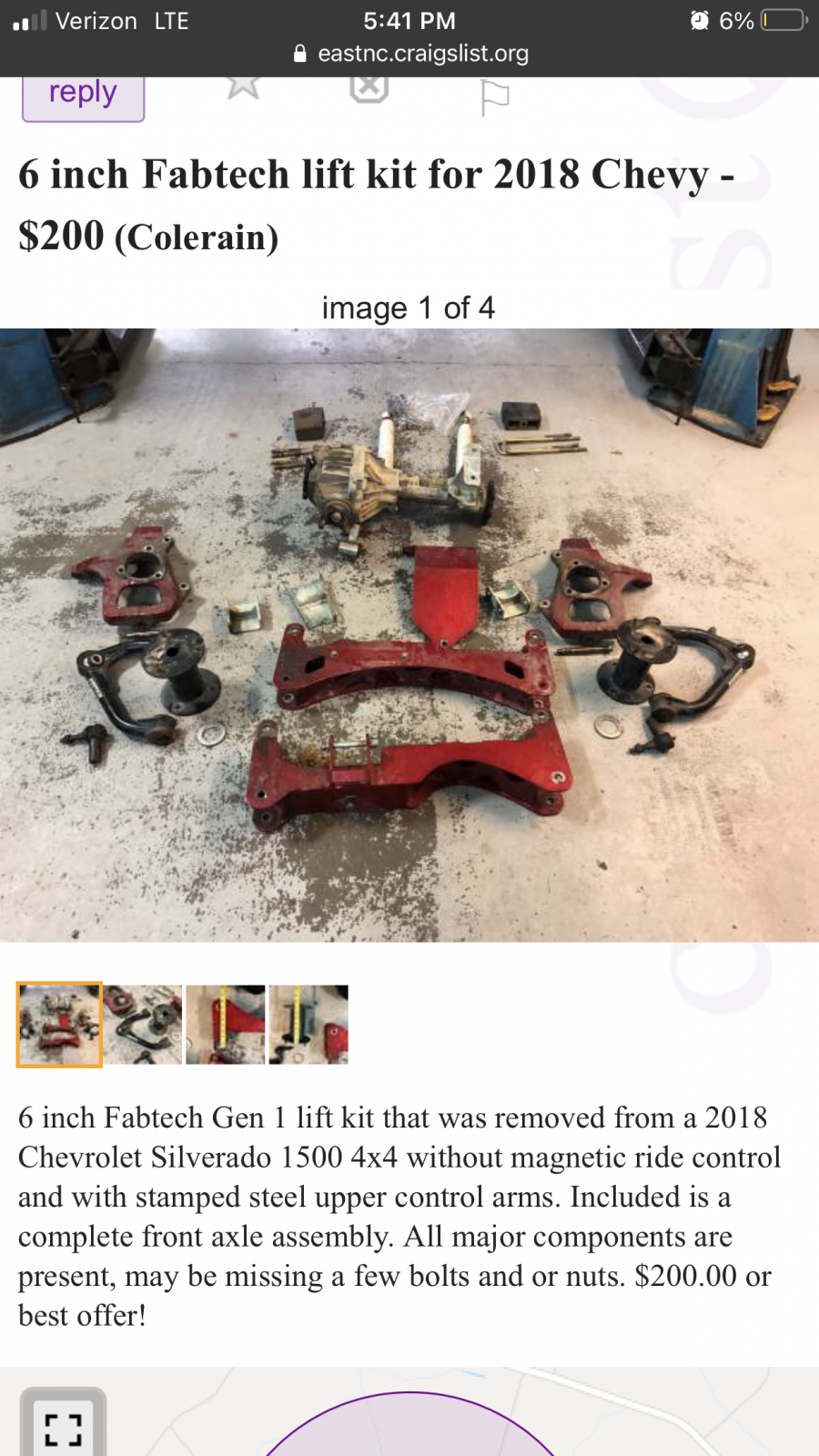

Just picked up this killer deal on a powder coated fabtech lift. Comes with uniball UCA had less then 20k miles on the kit As it was on a 2018.
If im not mistaken and from looking at my dads 15 and my 07 the suspension is identical so I’ll probably replace my rough country lift to finish off my build. However im curious to know if it’ll work on my 07 Tahoe as well beings it has the aluminum control arms vs steel. If anyone can chime in shoot me your thoughts please before I rip apart 2 vehicles for no reason lol.
From what I’ve come across the front suspension is the same from 07-18
Yes i know I’ll have to get a rear lift to use it with the Tahoe as long as one of the two lifts will fit on it I’ll lift it as well vs selling the RC kit

Main concern really was the lca and ball joint mounting but I think it should be fine. Kind of a pieces together kit beings the coil overs are off a at4 gmc and lift is off a 18 Silverado going on a 07 Tahoe.
For the rear lift I’m just going to throw some 2-3” pucks with moogs heavy duty 2” coil spring 6 in the front 4-5 in the rear
