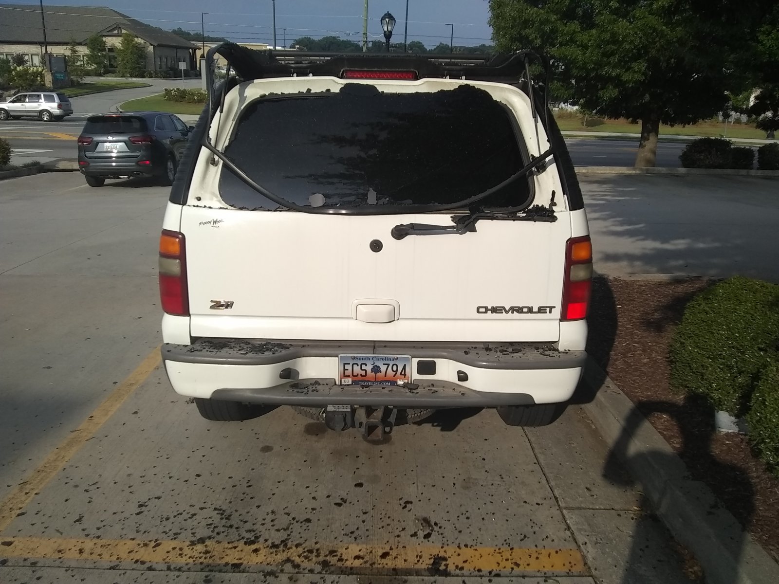

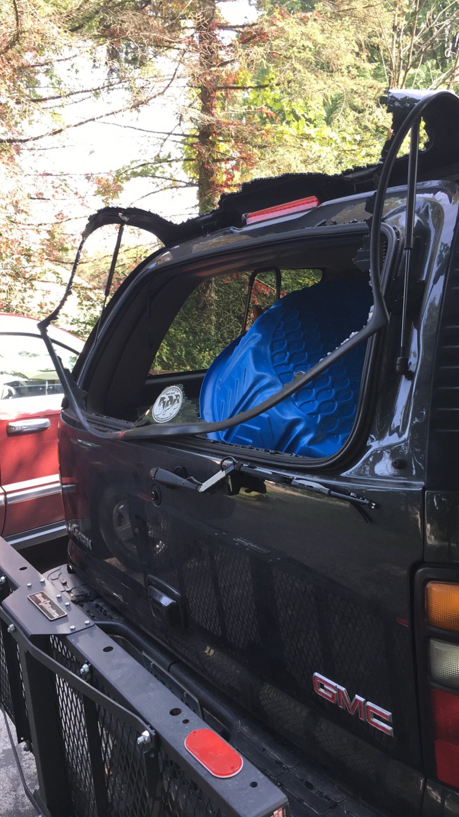

From memory, it had something to do with the glue used on the hinges to the glass, and the MightyStruts. The glue would delaminate on one spot from heat and age, causing a torque type stress over the glass. Eventually, it would shatter.
