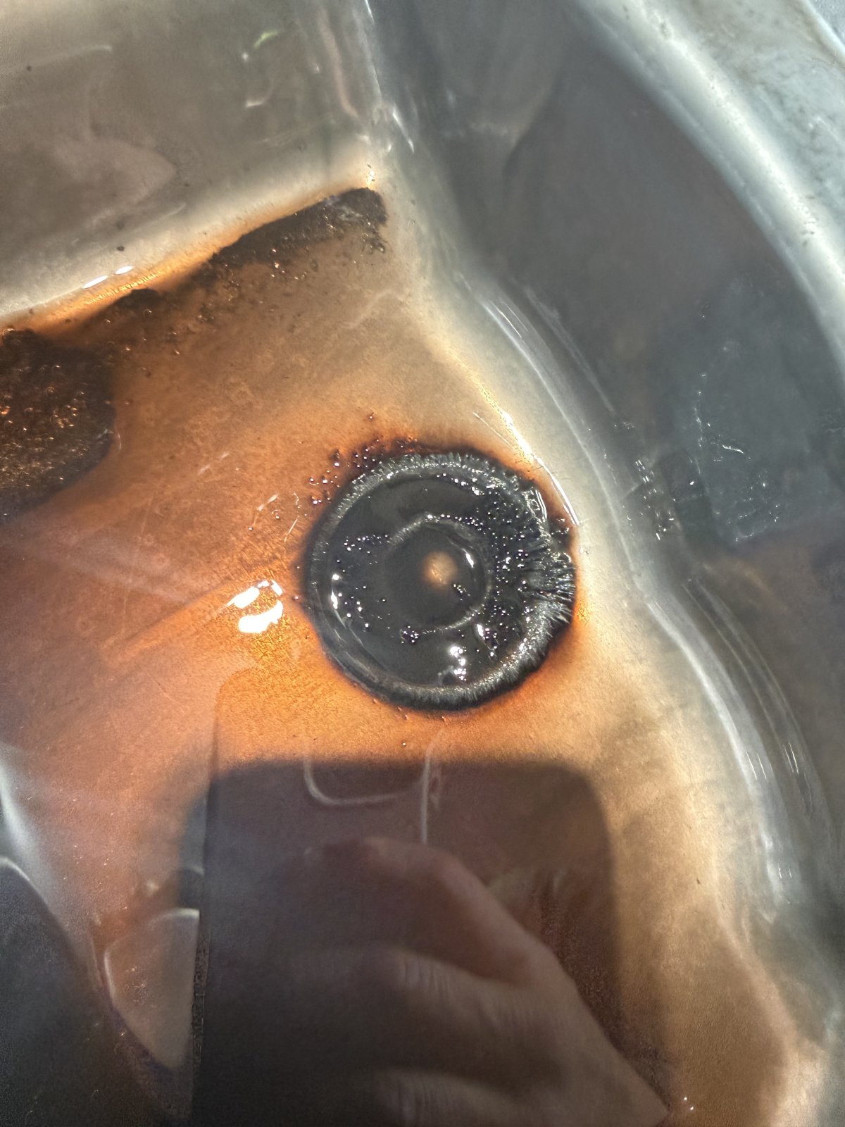

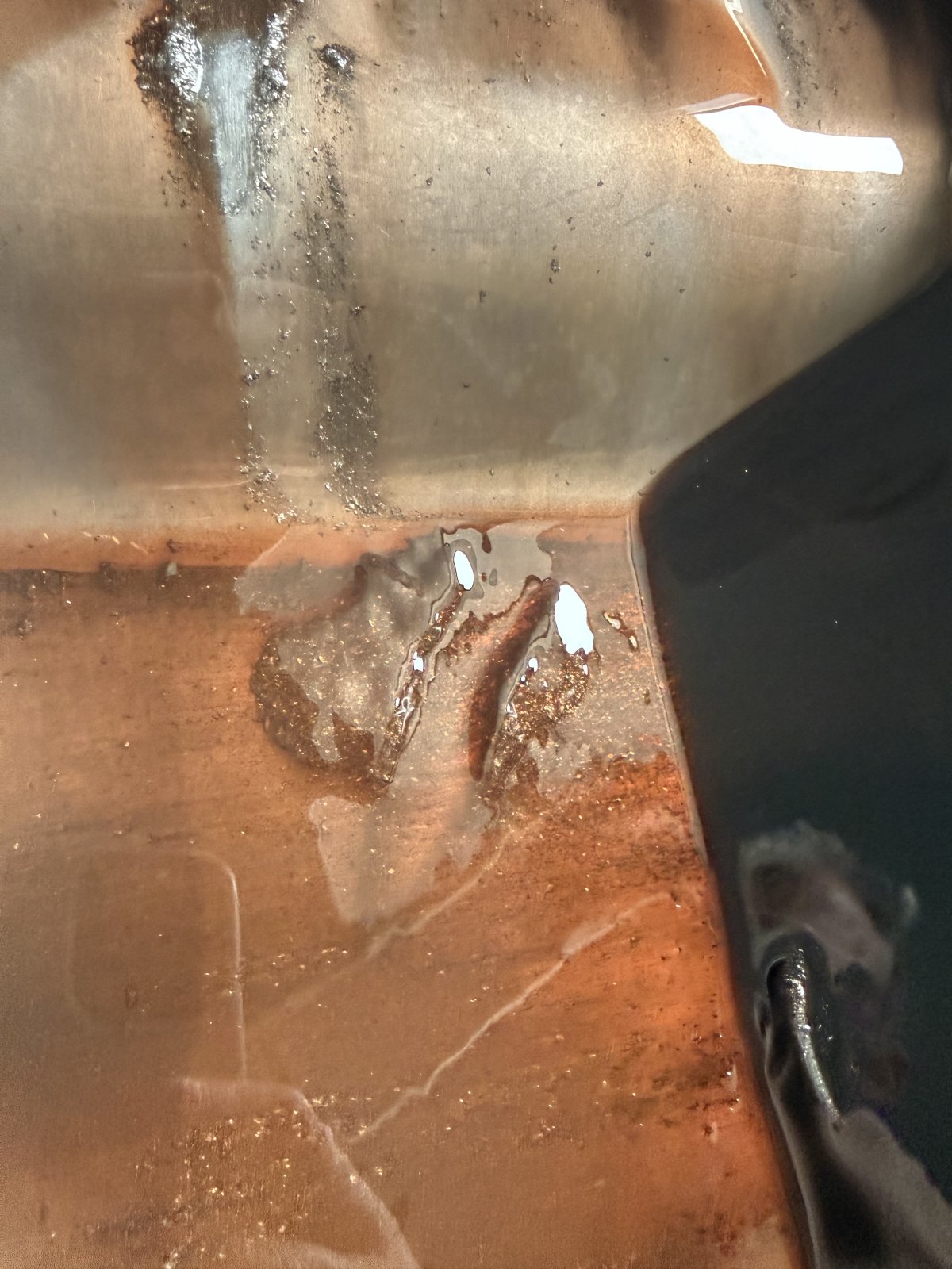

Well pulled they pan no big chunk of metal but seems to be more metal shavings than I remember last time.

Pull it out for overhaul. Looks like the comverter failed and sent shrapnel throughout the transmission. Unfortunately all too common with those...
Yeah I was pretty sure after seeing the pan it needs rebuilt. I put a new filter and filled with fluid and strangely enough is seems to drive just fine but I know there is something wrong in there.
