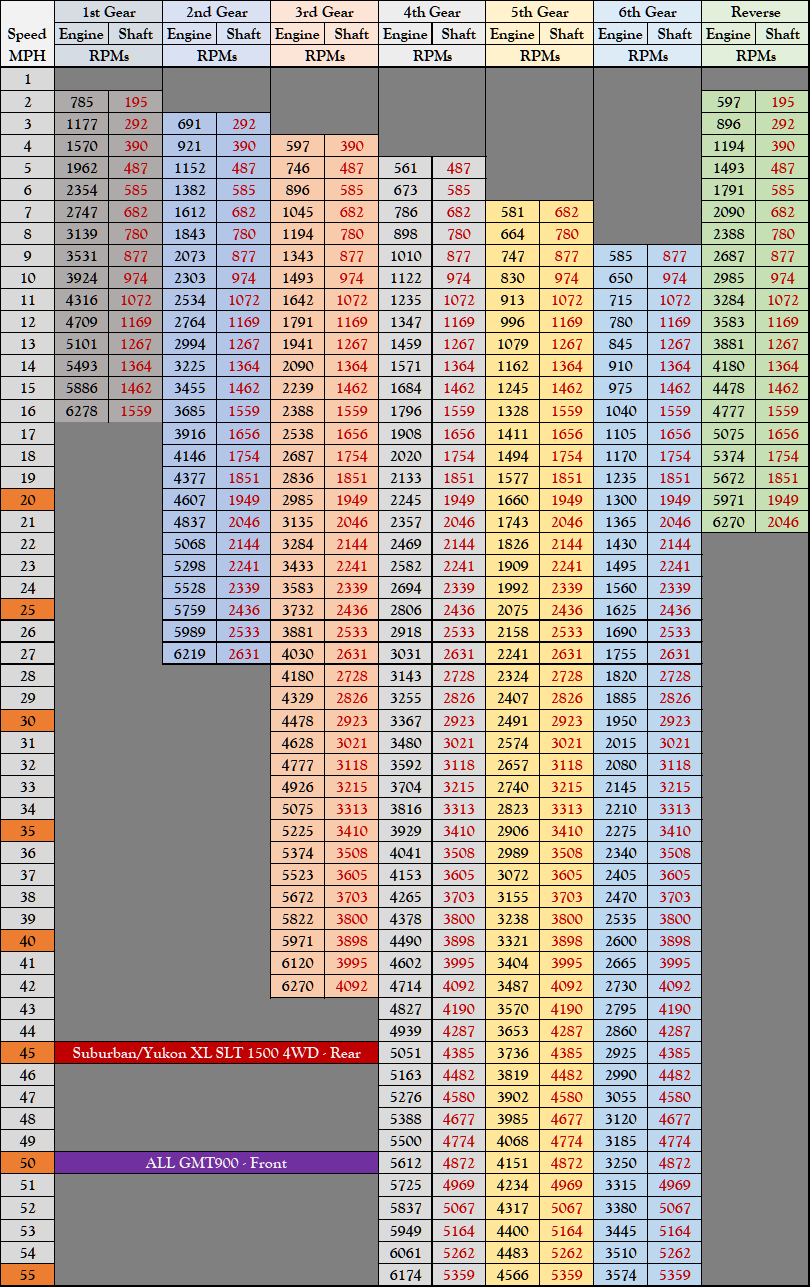

The critical speed of our driveshafts is mathematically 4,556 rpms. That comes out to 122 MPH with the tires worn down to 2/32nds tread or 45 MPH with the same tires in 4LO.
If you want to go faster, you need a thicker and or larger diameter driveshaft.
The critical speed of the front driveshaft is 5,000 rpms which is good for 134 MPH or 50 MPH in 4LO.
The driveshaft in my truck is steel, .083" thick with a 3.5" diameter and tube length of 53-1/2 inches. Yours should be the same.

I'm not sure how to explain it, with my set up, at 20 MPH the main driveshaft is turning 727 rpms in all gears. In 4LO is turns 1949 at the same speed.
I made a calculator in Excel that I can send you if you want to manipulate it.
The transfer case is upstream from the driveshaft. The driveshafts are directly connected to their respective axles. Transfer case setting, whether LO or HI, has no impact on driveshaft speed. The driveshaft is turning the same speed at 30 mph whether you're in LO or HI.
But yes, a friend of mine who was a transmission validation engineer, who worked on the GMT900 platform, said the most likely failure at extreme speeds is the driveshaft. They blew multiple ones during validation. One time it punched a hole through the floor right behind the driver. :eek:

I agree with you all in theory, next time I take the truck out, I'll fire up the Tech-2 and stick it in 4LO and see what the driveshaft speeds are. Won't be the first time I've been wrong! LOL
