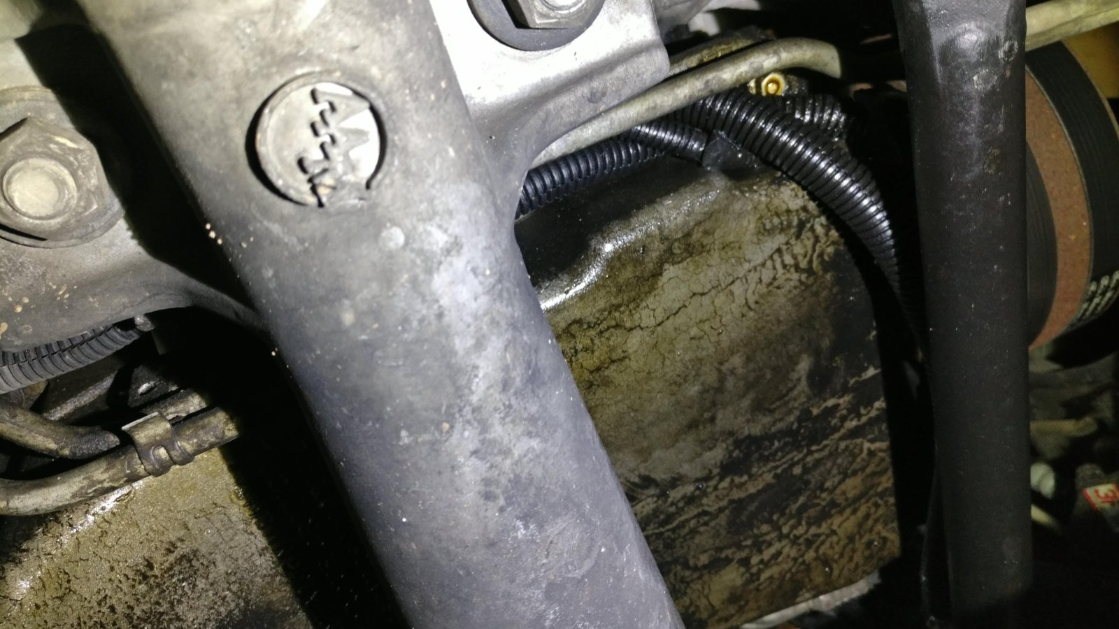

Oil pan gasket leak.
The smell - and knowing the root cause - had been bugging me for long enough that I pulled the Denali off the consignment sale lot and brought it home for inspection.
I got video of a cold start after a full week of sitting still. Two videos, in fact. One from the center console and one pointed right at the exhaust. I was hoping to reproduce the occasional cold start growl I get. Nada. Perfect cold start, exhaust looks right, no funny noises, drops to a low idle. Can't complain I guess. But no more data there.
There was no odor, either. That is, until I turned on the heaters. Then, bam, it hit right away. It's got to be oil. Not necessarily burning oil, just, hot motor oil. Selecting inside air helps some.
I took it home and got it up on jack stands. My mechanic friends have told me that synthetic oil finds leaks, and that you always want to start from the top and front of the engine since oil flows down and back.
The oil pan is covered in oil and dirt. Nothing above or forward of the oil pan is covered. I thought it could be the front pulley seal but that looks clean.
There is some oil by the breather hose, and one of the boots has a crack, but those wouldn't cause my odor.
It's tough to convey this in photos, hopefully the ones I've posted are clear.
