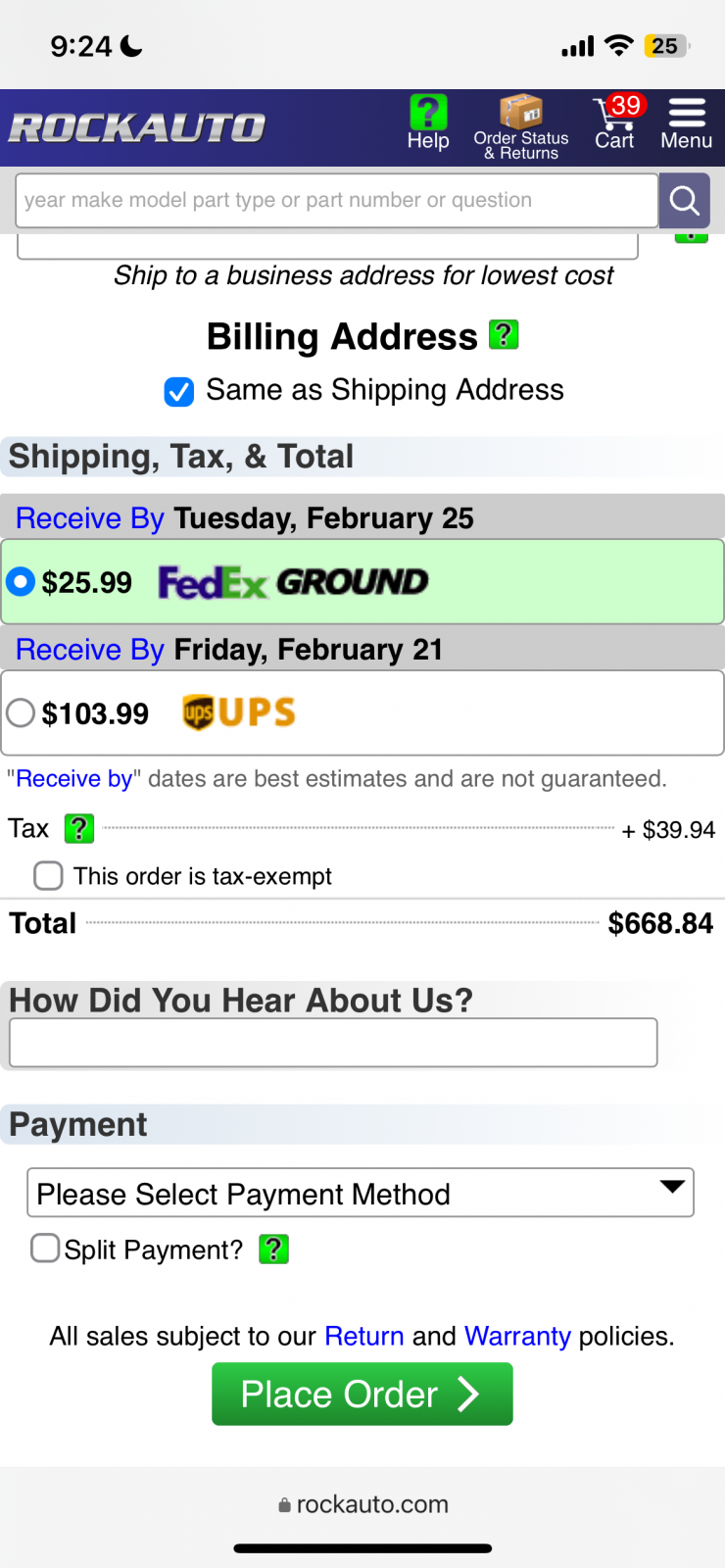

Priced out CHEAP engine tech rockauto parts that I’d need, and the total is almost $700, and I forgot to add an oil pump to the list.
The list includes
Cam and lifters
Head gaskets
Head bolts
Timing set
Timing gaskets
Push rods
Rocker arms
And a good oil pump is +$100 at least
So, it’s not going to be worth it at all. First result for a 5.3 on marketplace is 65 miles away there’s an LM7 with 140k miles for $600 complete. I have an L59 in my suburban but can swap fuel rails, etc.

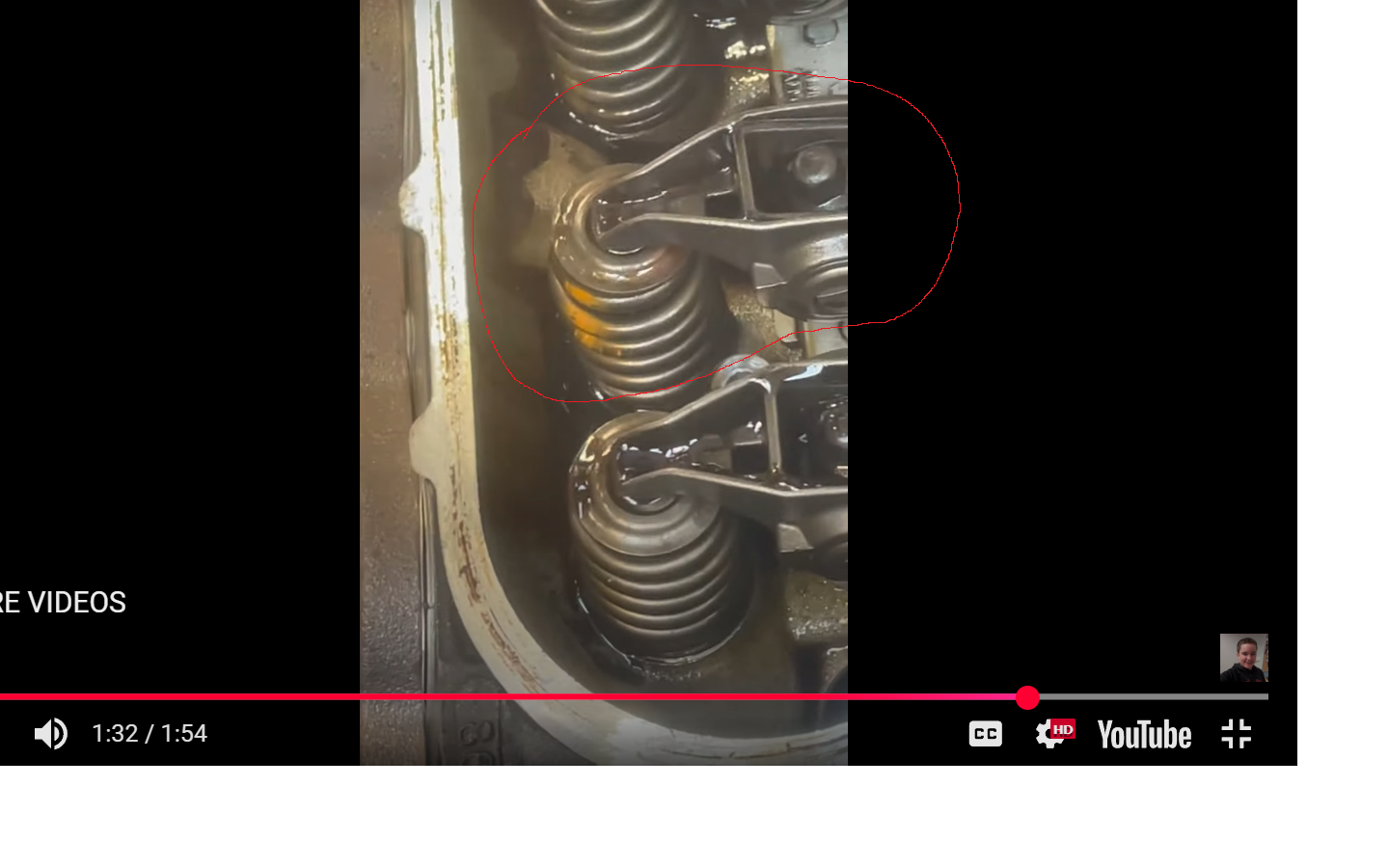

Just something I'm now noticing while rewatching my own videos, it kind of seems like cylinder 2's exhaust rocker isn't getting nearly as much oil as the rest of the rockers. Kind of looks like it isn't getting much oil at all.
Hopefully I diagnosed the right cylinder as making all the noise, because the lack of oil is kind of suspect to me. You can see oil flowing down the surrounding rocker arms, but not a whole lot on cylinder 2 exhaust. May end up pulling that rocker too and making sure the hole in the pushrod isn't blocked up.
