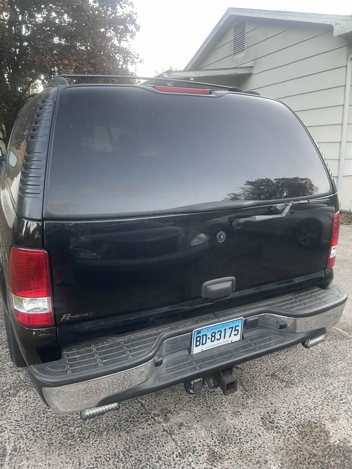

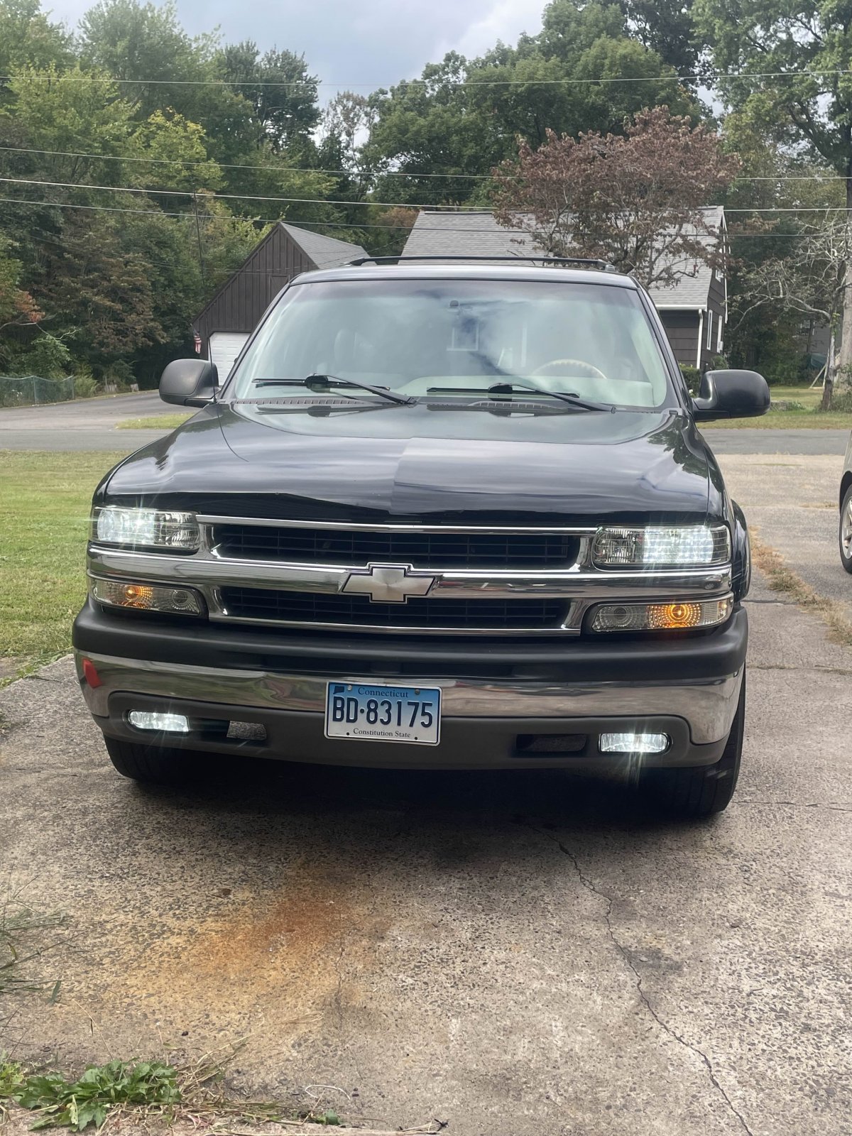

By the way, don't think i've posted any real pictures of the truck that this is happening to. It's a black Suburban Regency Edition. She's definitely a decent looking rig, with rotted rear rocker panels. Frame is as solid as can be. I have to say, since September when I bought it, it has become pretty special to me. I don't know why, but it just has.

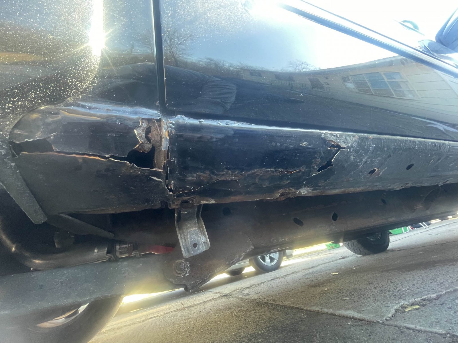

And this is the worst rocker rot, rear passenger side.

There are so many avenues to take on this. If you cant afford another vehicle and have to have this one rolling, either grab a used engine if you can find a Gen3 with atleast below 200k or take a chance on the engine you have and pull the heads and see whats going on. It really all boils down to how much money you have to pay for the avenue that works for you. There really is no way around not having some inconvenience while your only vehicle is down, but it will really be inconvenient with a completely locked up engine scenario that you havent planned for. I recommend a girlfriend with wheels, we will call her Suga Momma.
As far as quarter panel rot, who cares. The vehicle gets you from point A to point B when you need it to. It aint no show car and never will be. It doesnt have to sparkle or shine. This generation C/K chassis is extremely dependable and typically stupid easy to work on when needed. It will last you many years with relatively low maintenance costs if you can do them yourself or have friends in the know. The LS engine platform is well known to go 300k+ with just regular oil changes and basic maintenance of plugs, wires and sometimes ignition coils. Not alot to go wrong.
