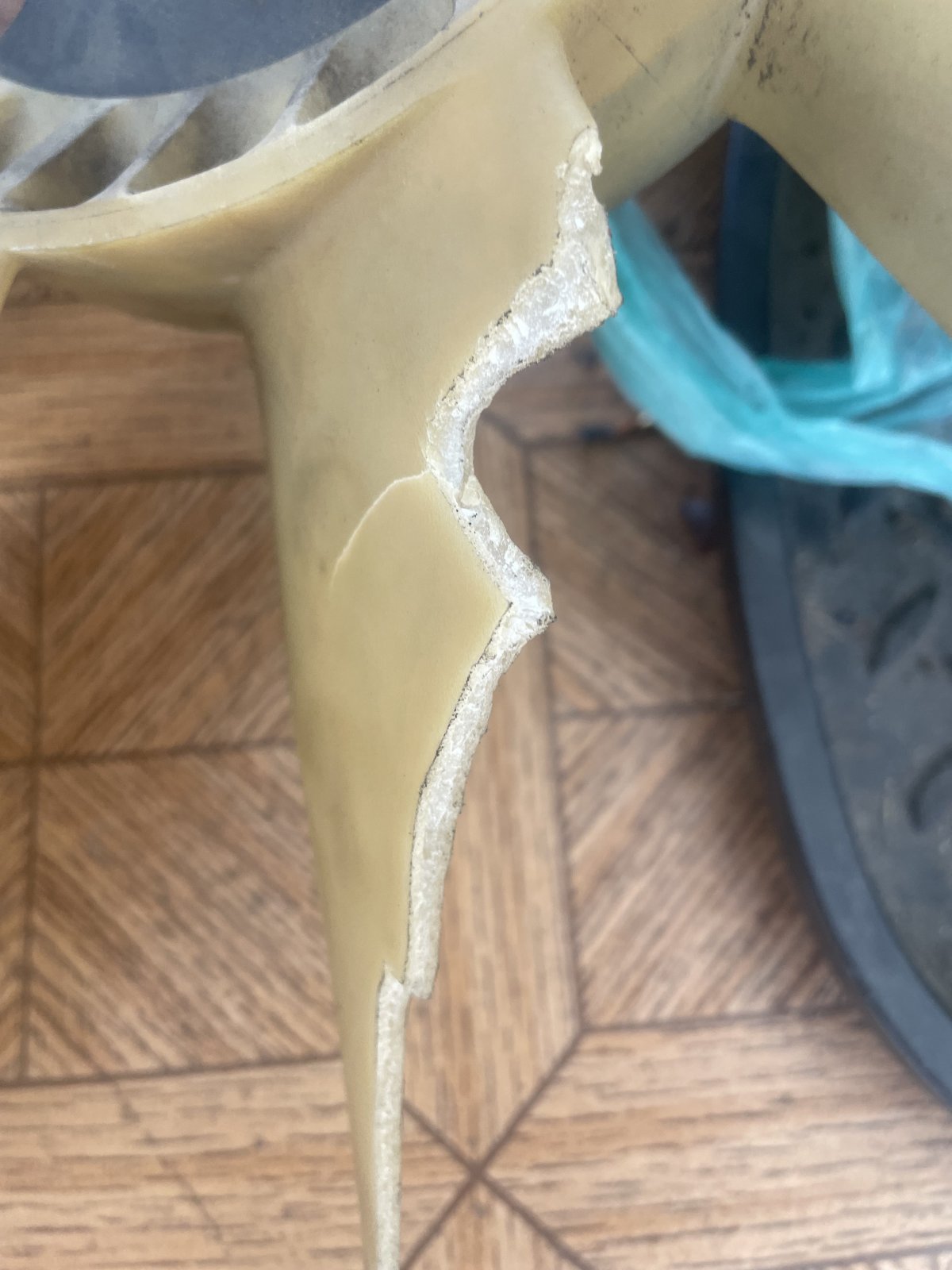

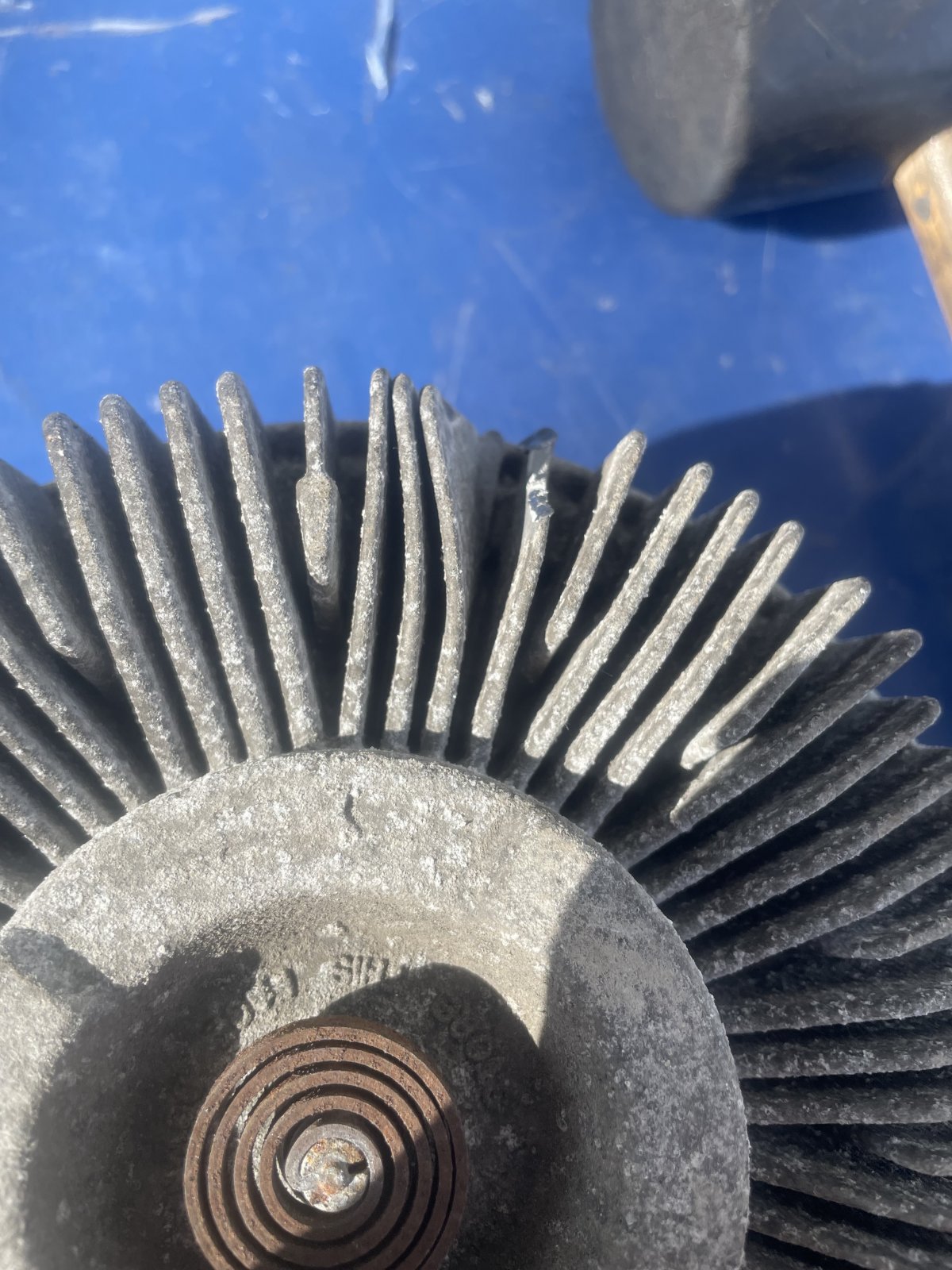

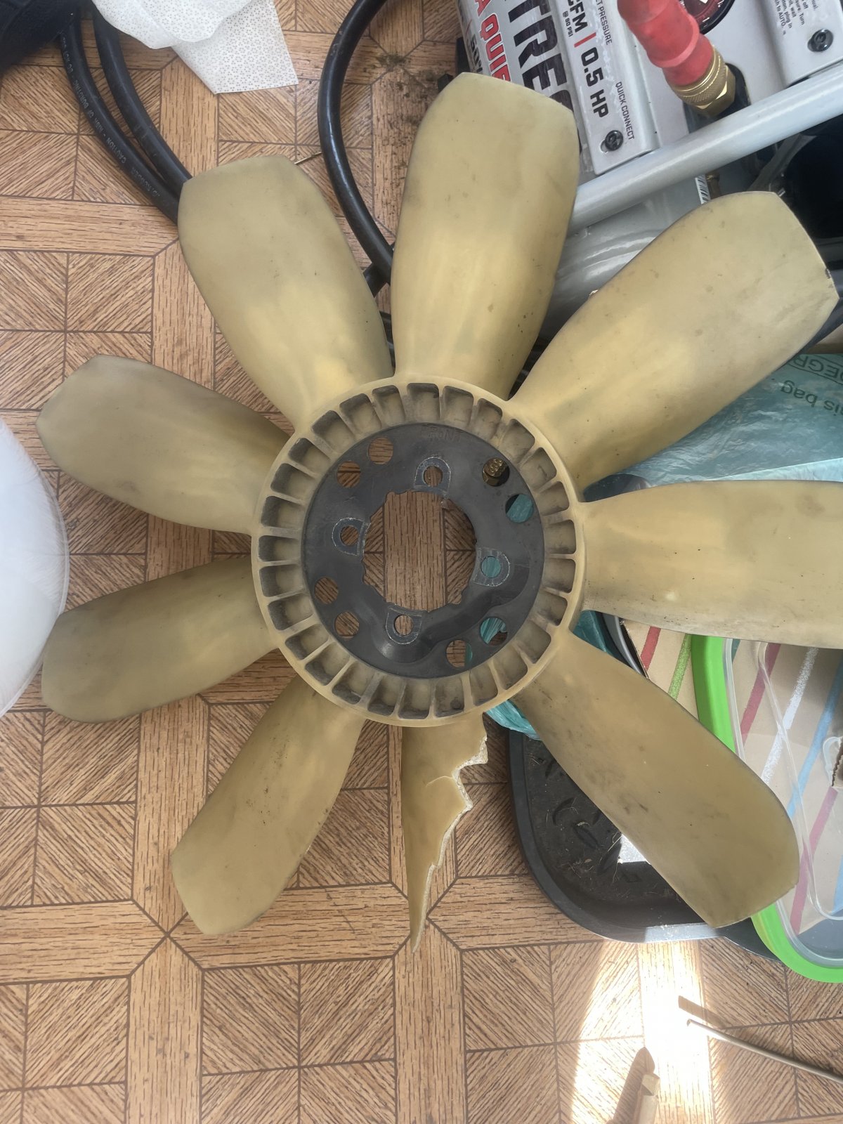

Also to be noted, and I'm a total idiot for this, there's a chance it's not a misfire at all. Instead, when I was tightening the bolts for the rocker arms I was turning the engine by hand to bring it to base circle to tighten. I stupidly left the ratchet, extension and socket connected to the crank pulley bolt and started the engine. Yeah..... It did its carnage. Put a big dent in the radiator(not replacing, it's not leaking), cracked a chunk off the lower fan shroud and most importantly broke off a giant chunk of one of the fan blades. It also bent a couple of the fan clutches fins. So I'm thinking it could be TOTALLY out of balance, and it's not a misfire at all, but a vibration while the fan is running. Which would explain why it's intermittent and doesn't happen when the engine is cold....
Think I can get away with just replacing the plastic fan that is destroyed? Or will the actual metal fins that are slightly bent on the fan clutch cause it to be out of balance too?

if you got a mech fan yes the blades unbolt from the clutch. id bet the clutch is ok. unless the fan spins by hand super easy, like you can spin it and it turns like 5-6 times by its self. then the clutch is shot due to wear. you can also push and pull the fan blade feeling for play in the clutch.
Fan clutch feels great. Stops itself very quick, makes no noise and feels super smooth. It's definitely still good. Just the fan itself needs replaced.

So here’s the final carnage, kind of fought to get this stupid thing off. Rented a fan clutch removal tool, turns out my water pump pulley is not a bolt on, but a press on pulley. But it had holes on it. Perfect spot for me to put my cheap harbor freight adjustable spanner wrench, and it worked the 2nd try. First try it slipped off and BOY I busted a knuckle real good, skinned that SOB. Second try I wore my thick mechanics gloves and the fan came loose!!
Question is, are these bent and slightly broken fins on the fan clutch enough to cause it to be out of balance? Or should I run it? As stated, other than the damage the fan clutch is in good shape. Obviously the fan is getting replaced.

So here's something new. I don't know if this fan has ever worked properly, and I still dont think it is. I installed the old fan clutch with the new fan, and started it up. Instantly I hear the fan(engine cold), I give it little baby revs, and the fan is like full blown blowing and making fan noises even with engine cold. I have never heard the fan like that just sitting there, what is the clutch stuck engaged or something?
