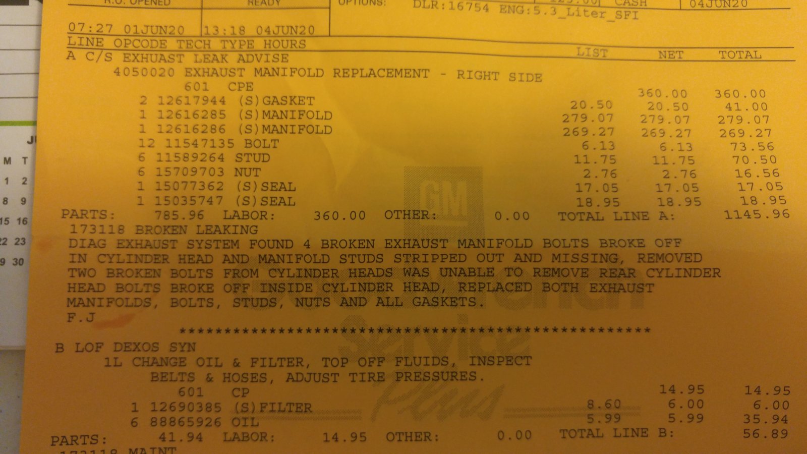

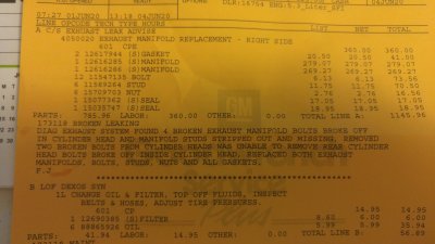

update! dealer said i had multiple leaks on both sides, they replaced both manifolds but couldnt extract rear bolts on both sides. really? this doesnt see right! see attached pic of invoice.
Wow, good thing you took it to the dealer to make sure it was fixed properly. It probably won't leak for at least a month or two.
I can't imagine paying $1100 for an incomplete repair. That is absolutely ridiculous.
I guess they didn't have a welder and a couple of nuts to spare to get the other two broken studs out of the heads?

Did they give any warnings, before or during the work, that they could not get to the rear broken studs and if they were replacing them the price would be higher because of removing heads?

no, they said if they're able to get it to seal they dont take it any further. i've seen where dorman makes a clamp for some 5.3 heads but not all if theres 2 spare holes on back of head to mount it to.
