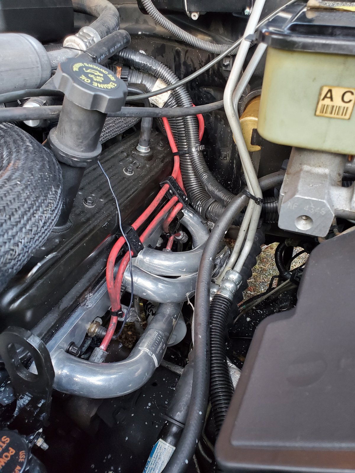

Here are the headers

The gasket i got block the holes for the oil dipstick and the spark plug wire hangers. That was a ***** too. Luckily you can dig it out with a razor blade and flat tip screwdriver

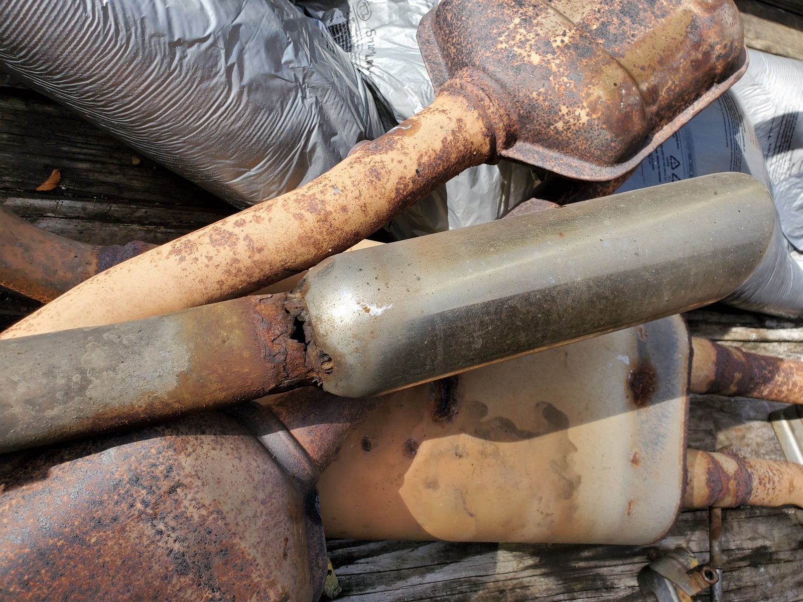

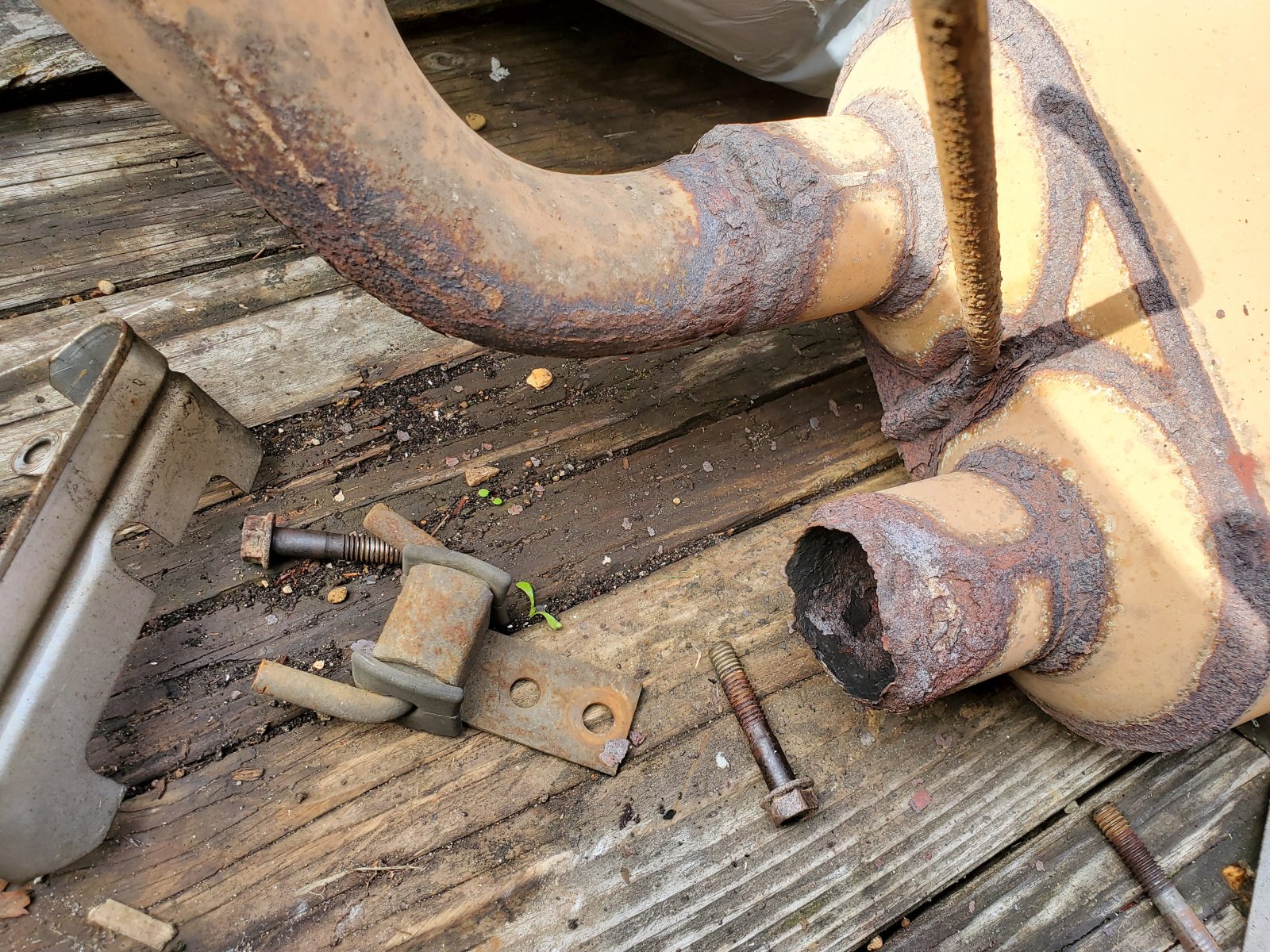

The second pic is where it rusted straight through and broke off

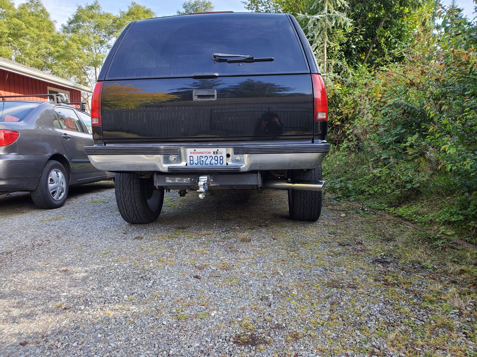

Tip sticking out too far? Wow i did not expect it to smell so strongly but apparently that is normal for new exhaust parts while all the oils and such burn off. Smells loke burning plastic

Does look like it's sticking out a bit. Sounds great though!
