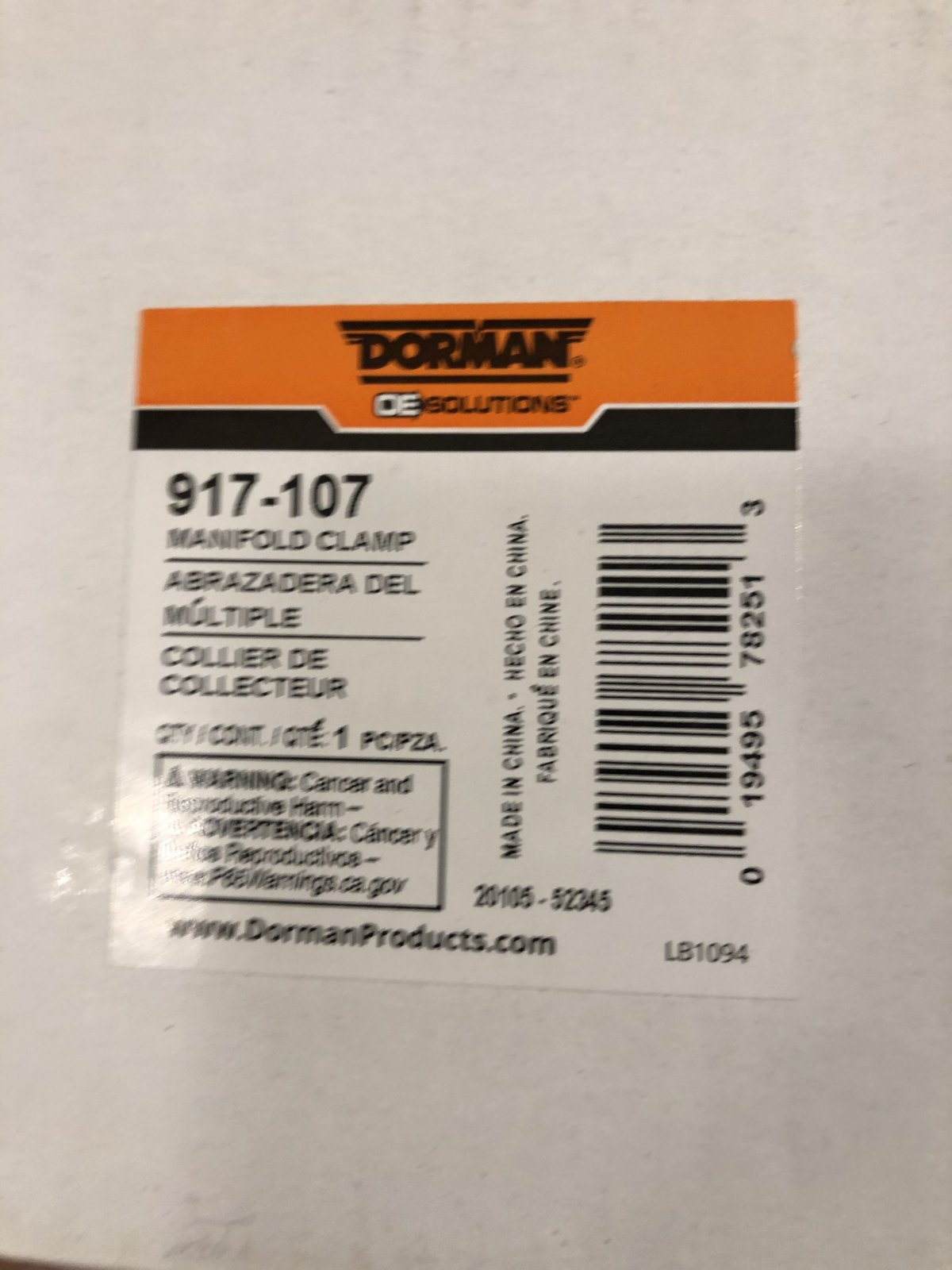

I started hearing a tapping from the engine. Realized a couple manifold bolts have their heads broken off. Installed the Dorman manifold clamp 917-107
I tried for a while and couldn’t get the bolts into the back of the engine started. My son-in-law came by and took care of it in 30 minutes. Wow... it has never been this quiet!

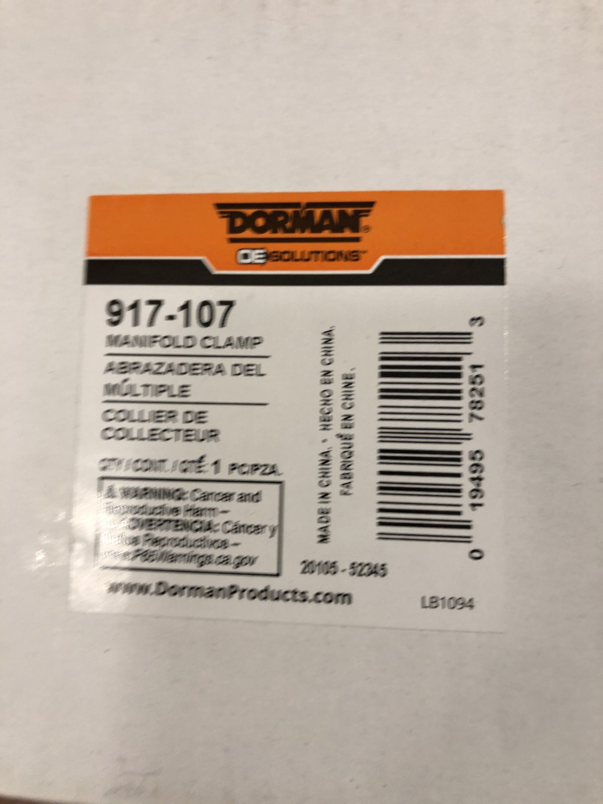

good to hear. Does this clamp work as a stop gap while the bolts are broken?

They make several clamps for the GMC engine I’ve seen people that have said they are successful for years. I have 170k and don’t drive it a lot so I’d prefer not to remove the heads
